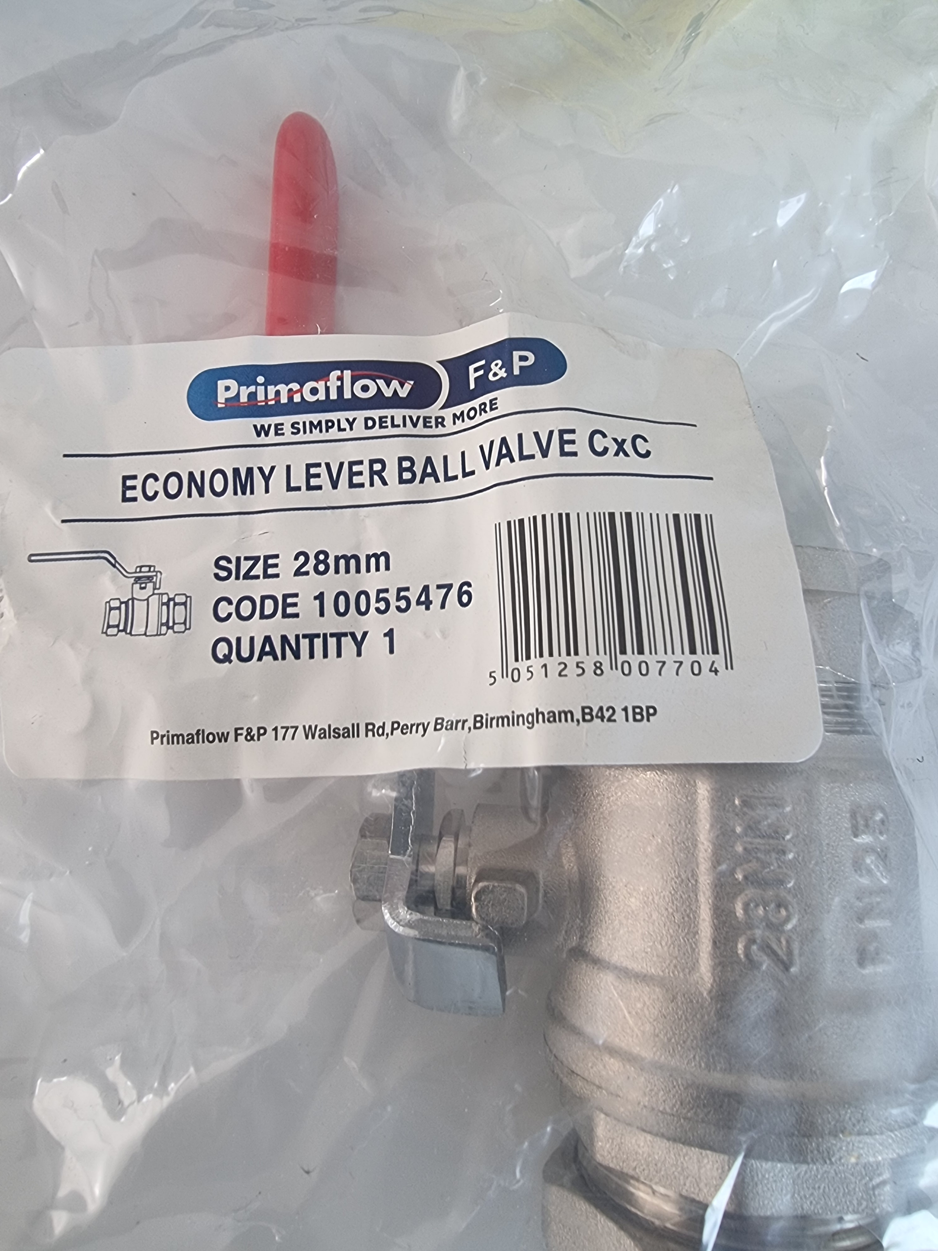

Mr Blobby Posted June 9 Author Posted June 9 (edited) So the AF valves delivered are Caleffi 108. Model 108701. https://www.advancedwater.co.uk/product/caleffi-antifreeze-valve-1-14-108701 1 hour ago, SimonD said: You can obviously make your 1 1/4 ones work - I'm guessing they're swivel on one side? AFAICS, no swivel on one side. On the quote the ball valves were like this... https://www.intatec.co.uk/products/k-type-extended-ball-valve/ But what has been delivered is this cheaper substitute, which isn't good: The 3 way valve is this VC6013MP6000 1 inch. Like this. https://www.kestakon.co.uk/3-way-valve-1-it-vc6013mp6000-honeywell-without-limit-switch/ Added to the delivery were 6 x 28 mm to 1.1/4 compression straight fittings and the two 28mm elbows. So I think I'll swap out the components for 22mm AF valves if I can get them, and decent, not economy, 22mm ball valves. Then it should be possible to connect the pipework from heatpump into the house without so many reducers everywhere. I think. 🤔 Perhaps the lesson here is to specify everything instead of relying on the heat pump supplier to configure the plumbing components. 1 hour ago, SimonD said: Given what you've said I'm actually quite worried about who you've got coming to do the job.... who is actually doing the commissioning and registering the warranty? The people who supplied the heat pump do offer to do commissioning and sign off for the warranty but as yet have given no price for this service. I'm in no rush to ask them to do so. The first supplier we approached didn't even give us a price because I refused to have a buffer tank. I reckon our plumber can do all the wet work, our electrician the wiring. It may be that the risk of heat pump failure is too small and the cost of commissioning too high to make the the extra warranty worth it. I'll soon find out 😬 Edited June 9 by Mr Blobby
SimonD Posted June 10 Posted June 10 10 hours ago, Mr Blobby said: I reckon our plumber can do all the wet work I'm actually quite worried about your plumber if he/she has been involved in spec. and supply of the components. Definitely insist on what you've ordered. The extended ball valves are a blessing as you want the valves fully insulated and accessible. It's possible to do it with the normal valves but not as neat - I don't know whether the cheapo ones you've receive are even full bore? Using bsp to compression fittings is not too much of a problem, but to me it's the unnecessary cost because the bsp valves plus fittings are always more expensive than just buying the compression ones and then you have the additional joints - and there's the additional time fitting them which can be quite significant. It may be a good idea to just sit down and draw your pipework section from heat pump to wherever the primary flow/returns are going and then map out exactly what fittings are going where and then sit down with the plumber and give the supplier a kick with the resulting list and exchanges. Good luck.
Mr Blobby Posted June 10 Author Posted June 10 Thanks. It's all oil heating here in Northern Ireland so heat pumps are a bit of a challenge. Once we get inside the house then the plumbing should be the same as any other system so I'm trusting my plumber to do all that wet stuff with his eyes closed. One last question, do you have a link to an extended ball valve 22mm, I think they are all 28. Or maybe I run 28 mm to the end of the ball valves and then reduce down to 22 🤔
JohnMo Posted June 10 Posted June 10 58 minutes ago, Mr Blobby said: ball valves and then reduce down to 22 Generally all heat pump stuff is 28mm and bigger. If your pipe runs are short 22mm is fine, if they are long 28mm may be better. Valve https://www.unventedcomponentseurope.com/inta-1-female-swivel-x-1-male-heat-pump-extended-lever-ball-valve-hpbv11.html/?utm_source=Google Shopping&utm_campaign=Copy Unvented Components Europe&utm_medium=cpc&utm_term=adtribes&gad_source=1&gad_campaignid=17178278874&gbraid=0AAAAADCTOYDIF7_WqM1JdaR45hjcYe7rN&gclid=Cj0KCQjwlqTRBhCBARIsANrkrxiP5YU1oqx-01ITZliqfzcXOrTDlwcJv1dfpMhdWYFUDscVx6Kw2D0aAtV4EALw_wcB
SimonD Posted June 10 Posted June 10 1 hour ago, Mr Blobby said: One last question, do you have a link to an extended ball valve 22mm, I think they are all 28. Or maybe I run 28 mm to the end of the ball valves and then reduce down to 22 🤔 Intatec do them: https://www.intatec.co.uk/products/k-type-extended-ball-valve-2/ but this is probably special order from your local friendly merchants. However, the standard ball valve just about work with external pipe insulation - I've used them quite a lot.
