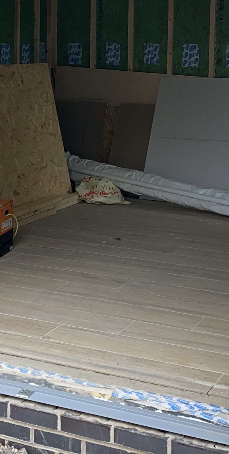

A pic of some we laid on a job, entire ground floor done, bar the lobby / hallway, to harmonise with the oak we used throughout.
Not the best pic but one where light is on it.
Darker grout may have been better, but that's the clients shout not mine.
1200x200mm iirc.
