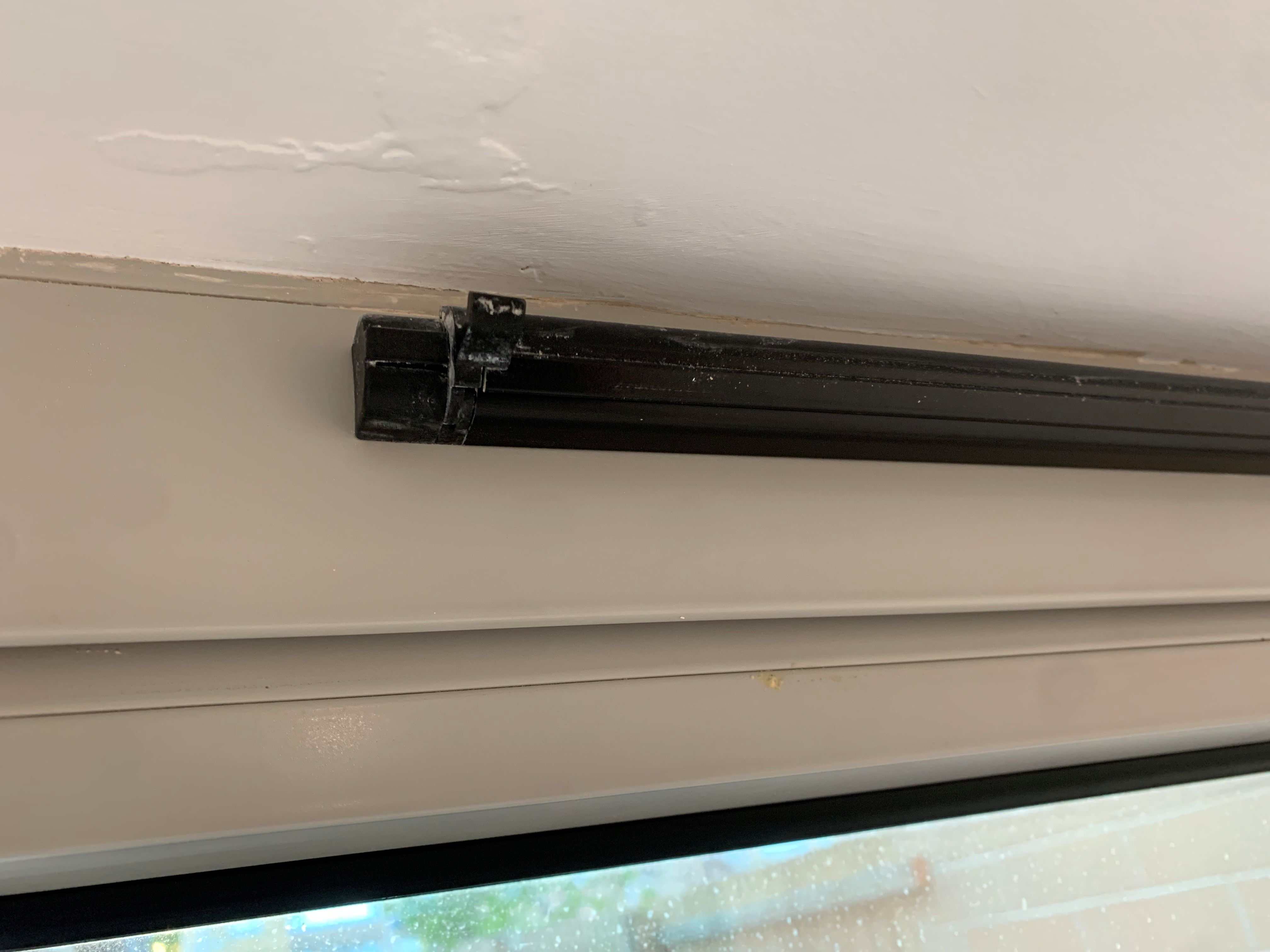

Spinny Posted 5 hours ago Posted 5 hours ago How can you remove a trickle vent to give access around it for painting ? - See photo.
torre Posted 4 hours ago Posted 4 hours ago Have had similar and I'm pretty sure that the caps on each side slide off sideways to reveal a screw below. You'll probably need to insert a thin flat screwdriver or blade to prise the joint open as they click into place when fitting.
