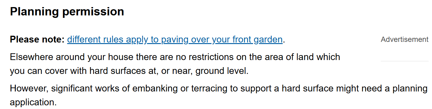

New drives in front gardens over 5m2 need to be permeable or discharge to a permeable area, but that is only to avoid the need for planning permission. So, two questions. What did your planning approval say about the drive surface (if anything), and does the surface water from it discharge to a permeable area, or can it be made to? It's all about flooding and reducing pressure on public drains, so if that is not applicable, it's unlikely you'll need to change anything.

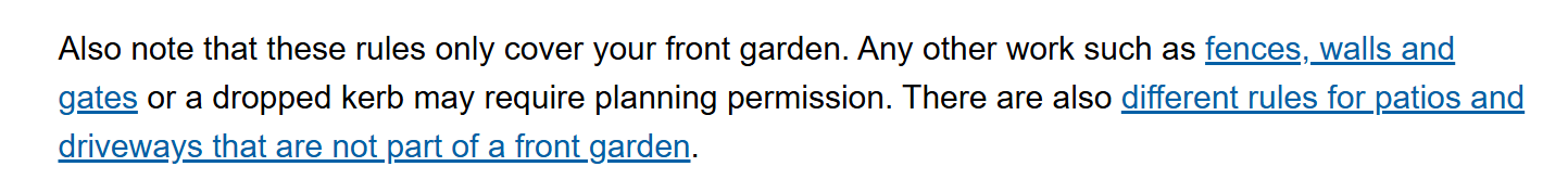

I have read through this several times and I'm not sure you're right. The legislation is to counter the adverse effects of the addition of PD rights for new drives. The only mention of existing/replacement was this:
"Existing driveways
Existing drives can also be converted to be permeable or drain to a rain garden. You should ask a builder for advice because the drive may also drain water from the roof."
Just to labour the point. I have an existing tarmac (non-porous) drive that empties steeply into the road. At the moment, after my renovations and a massive concrete lorry) there are a couple of bits of open ground (where a lot of the) water drains into.
         If I repair these (<5m) holes with non-porous material I am OK
         If I cover my non-porous drive with porous material (i.e. gravel) I am OK,
In my personal opinion, and I stand to be corrected, I don't have to create a non-porous drive if one exists already, only new drives/hardstanding areas of >5m are in scope

You asked about replacing and then talk about repairing and covering. They are different things.
If you replace your tarmac drive, then you need to do so with permeable material or meet the other criteria. If you repair your tarmac drive, it is not new or being replaced. If you cover it with something else, it is not new or being replaced.
You don't have to do anything with existing drives, otherwise the whole country would have needed to rip their drives up and replace them.

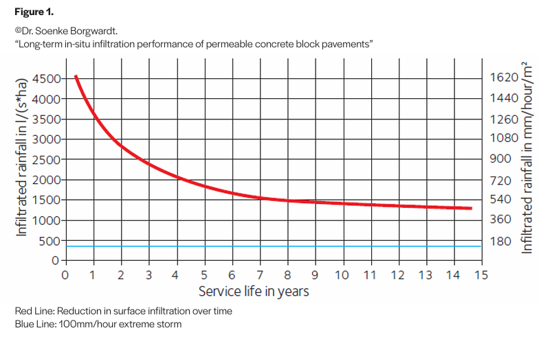

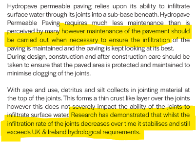

Like any functional part of a property, SUDS needs maintenance.
It always amazes me that in the UK that people are prepared to spend a fortune on fancy products and materials but either don't consider - or actively begrudge - the small amount of money or personal time required to ensure longevity.
Instead they moan about ticking boxes.
tobermore-hydropave-permeable-paving-maintenance-guidelines-v1.0.pdf

Its still BS. The only effective maintenance one can, once its clogged with silt, is to take it up and relay it including the base material. Which, quite obviously isnt going to happen. Even basic cleaning, almost no one is going to do
Just because someone produced a pretty graph, doesnt change reality out in the real world. I just look at what really happens, not what some desk jockey, paid by those pushing a product produces.
The principle of SUDS is sound, the application is mostly lip service, with products that clearly wont work long term. Proper solutions are expensive.
Permeable paving is essentially "delayed" hard surfacing.
