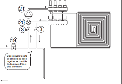

Just running through my Grant ASHP schematic before I start putting pipes together. Schematic wants a close coupled tee, what does it do?
CCTs provide hydraulic seperation - are you doing a mixed radiator plus UFH system?

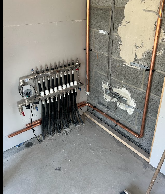

So, UFH fed from ASHP, my design flow rates are approx 17l/m.  The internal pump on the Grant can do 20l/m.  I don't mind straying from the schematic.  So, if I remove the pump and mixing valve from the manifold, then pipe straight into the UFH.  In the plant room I'll have the auto bypass and then the two port valve for the UFH zone.  Can I locate a blending valve in the plant room, or does this need to be situated close to the manifold?

You either need a pump to ‘suck’ through a traditional TMV, or to get an ESBE motorised mixer to run off the heat pump.
You never see the TMV after a pump, as it needs the recirculating water to function / reference the temp of the water in the loops.
If you're having a TMV for Justin, you'll need to leave the manifold as-is.

If from heat pump, there is zero need for a mixing valve or additional pump.
What Grant heat pump? The R290 has a modulation circulation pump so it will modulate flow rate to match demand - but doesn't do cooling ever, as no option available. R32 will do cooling but not if installed as per Grant instructions.

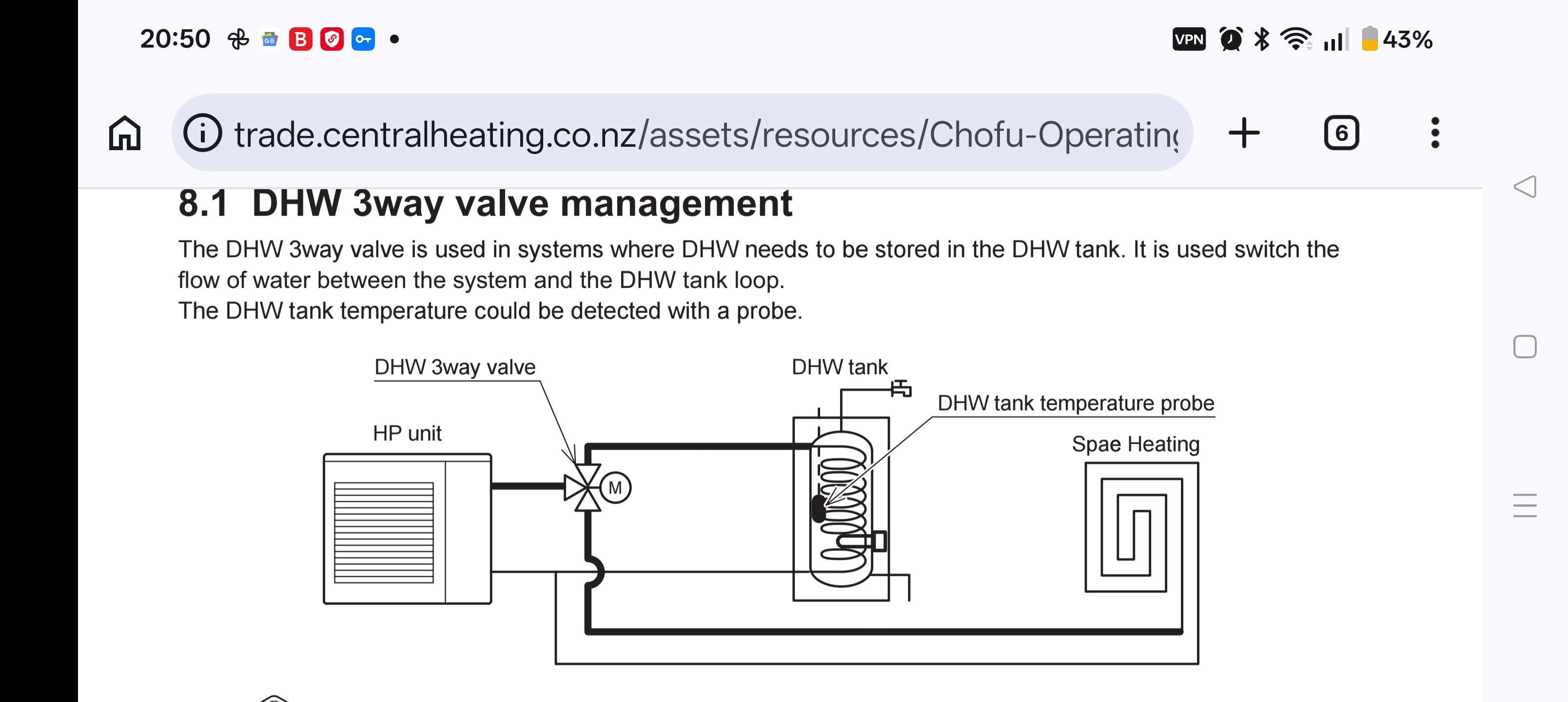

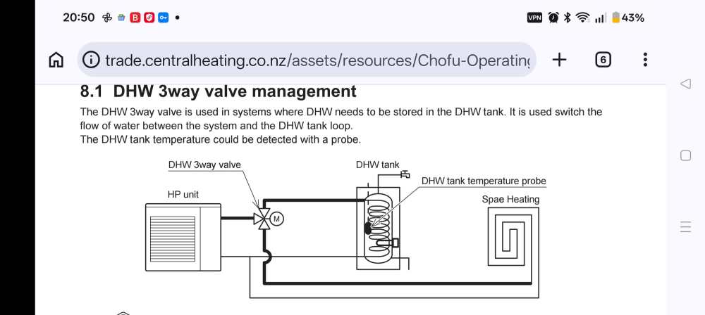

Yep the cylinder is already prepped ready with the 3 port valve. No worries on that!  My main queries are what to do at the ufh as I need to finalise the pipe work at the manifold.  My manifold and pump set was all supplied and purchased years ago, taking for granted that blending valves and pumps were required.  But I’m sure I’ve read that these were not necessarily required as design and thinking has evolved. - then I started thinking that perhaps the fixed flow pump in the HP may be able to deal with the ufh, reducing complexity and pipe work faff.
If you are just doing UFH you should be able to eliminate everything except the 3 port valve to go between the hot water tank / heating (assume you are doing PDHW?)
You should have a super efficient system just running the HP flow and return to the UFH (fully open). Obvs if you are paranoid about cookies add a heat diverter (urban plumber had a good vid showing esbe mixer and overheat detector in series) but I wouldn't bother. Only gotcha I can see is making sure you have enough water volume for defrost cycles and ensure you have an expansion tank.
