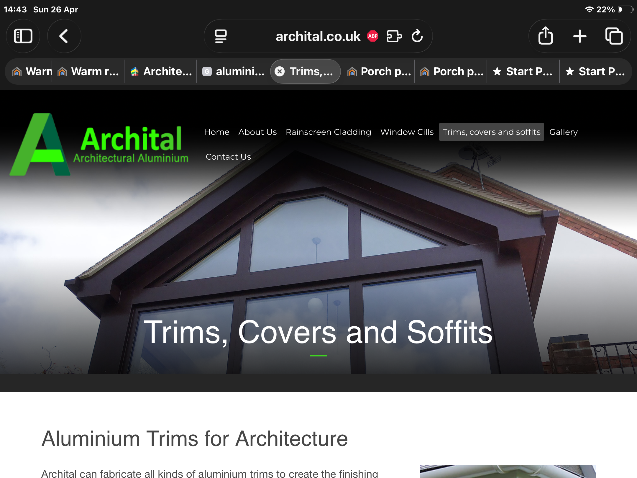

Hi Russell
Grey aluminium sounds interesting. Do you have a pointer regarding suppliers or maybe even pictures.
Thanks
(Not the Russell you asked but…)
Find your nearest metal fabricator (most towns have a couple or more). Have an idea of what you want and get them to make exactly what you want, to the colour you want.
Two ‘L’ section pieces may work, or one ‘U’ section and one ‘I’ section. The metal fabricator will most likely have some bright ideas as well.
