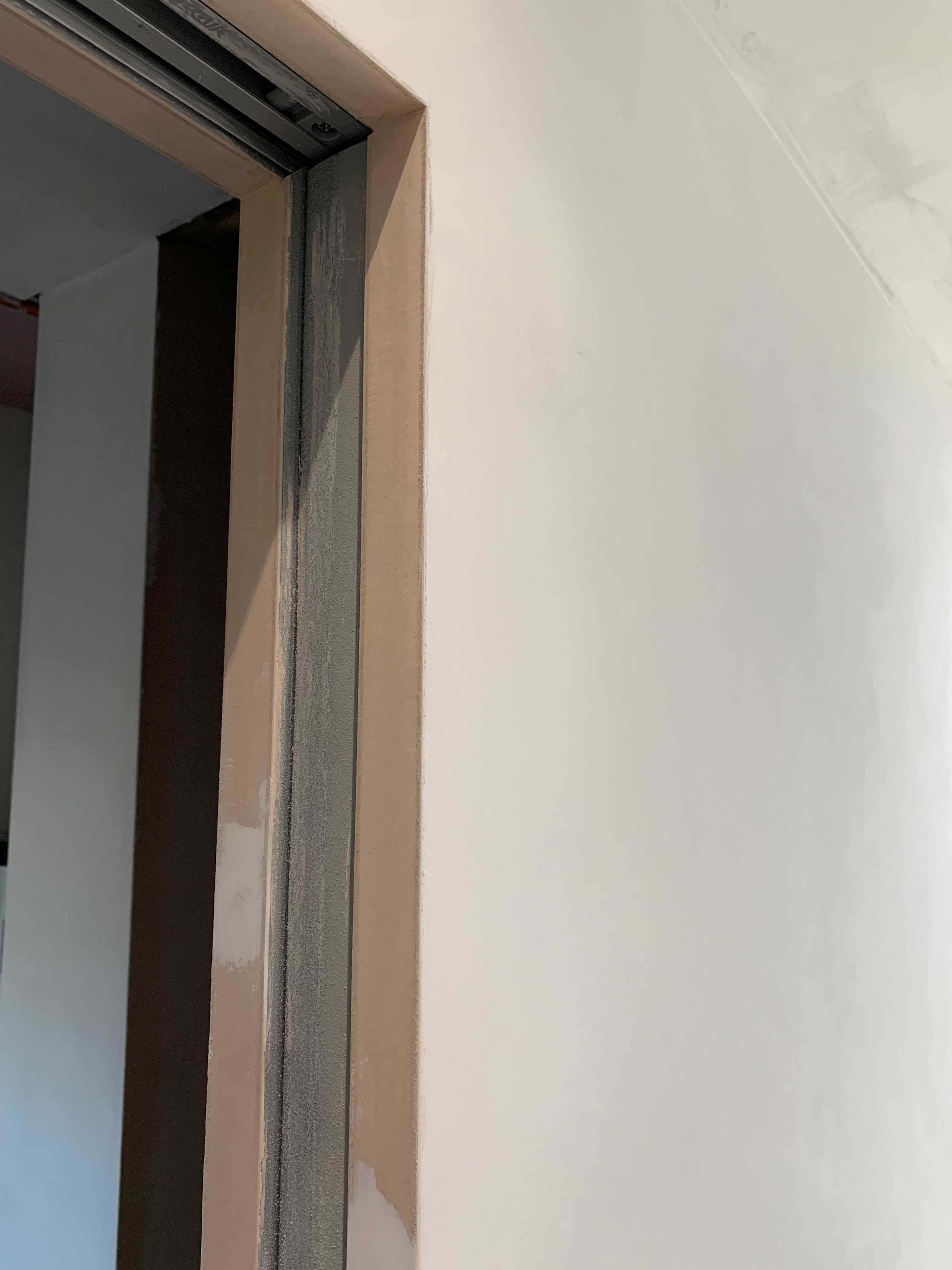

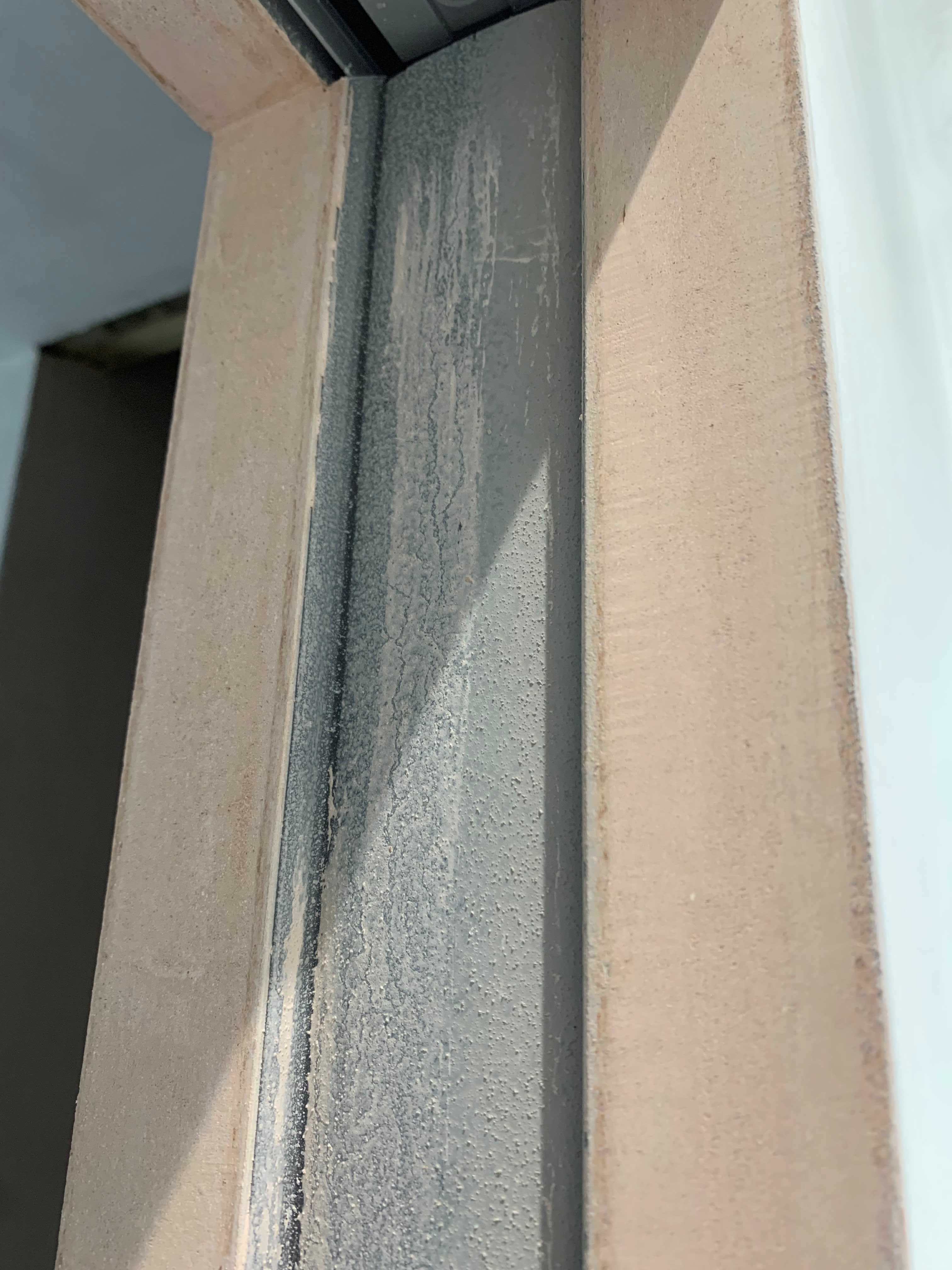

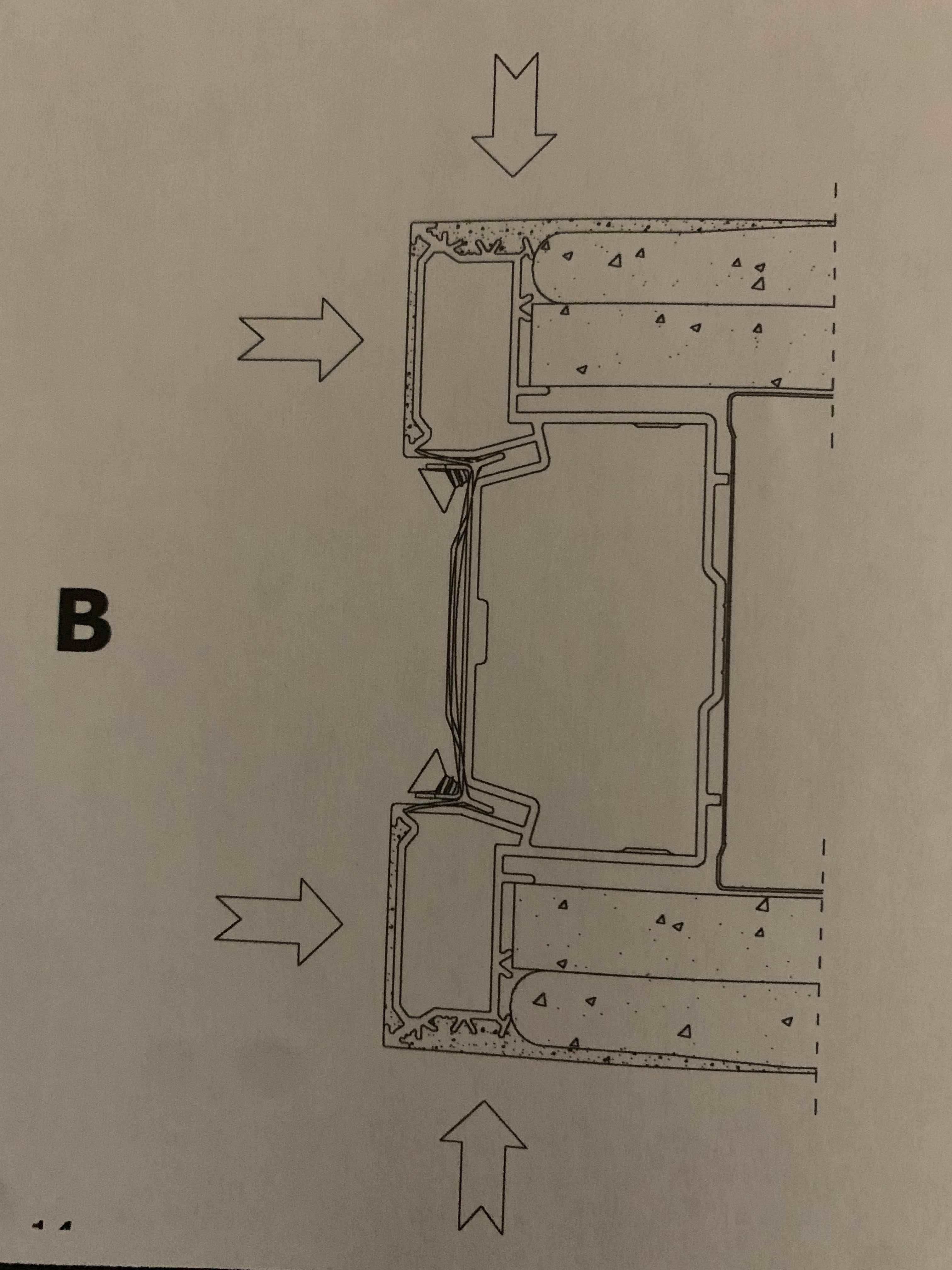

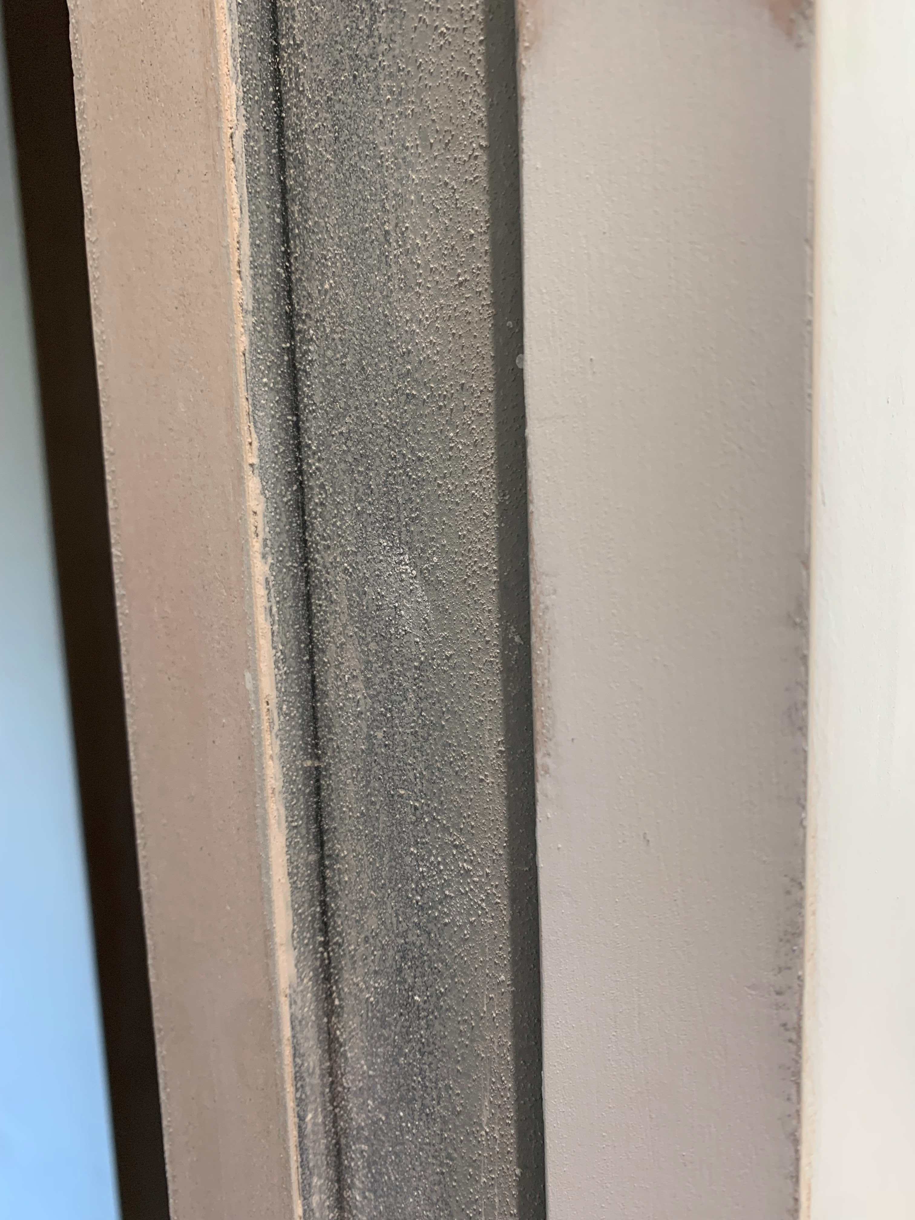

Spinny Posted 4 hours ago Posted 4 hours ago Any ideas on how the closing recess on my Eclisse Syntesis Architrave less pocket door is supposed to be finished ? The diagram in the instructions appears to have some kind of corner buffer in it - but absolutely nothing to say what or how this is installed in my instructions. And the recess is just a textured metal finish - is the inside supposed to be plastered too ? How would it work if you wanted to install a lock in the door with one of those hooks that drop down ? See Pics.
torre Posted 3 hours ago Posted 3 hours ago From that diagram my guess is there's a gasket that slots vertically down each side - any chance you threw it away when unpacking? I can't believe you're expected to plaster into that. Hopefully Eclisse can point you in the right direction!
