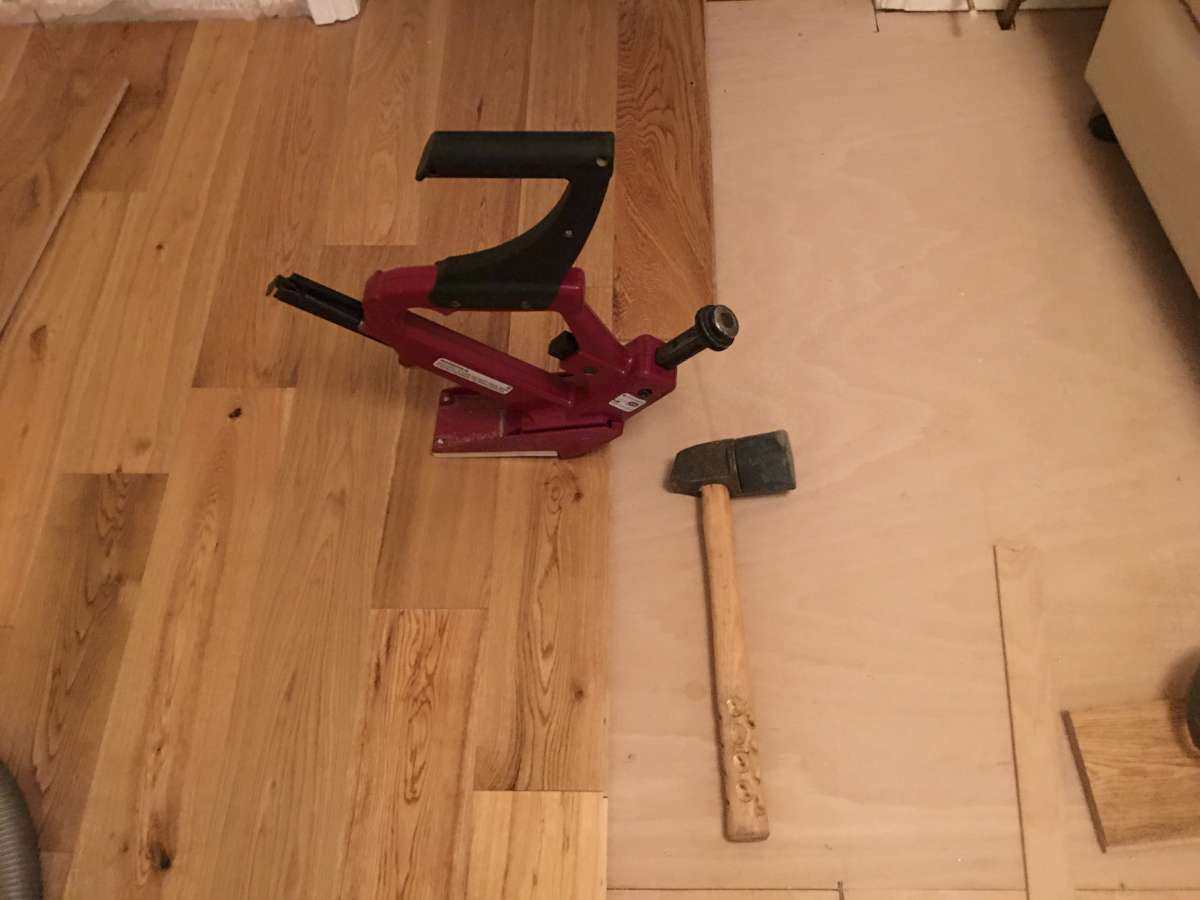

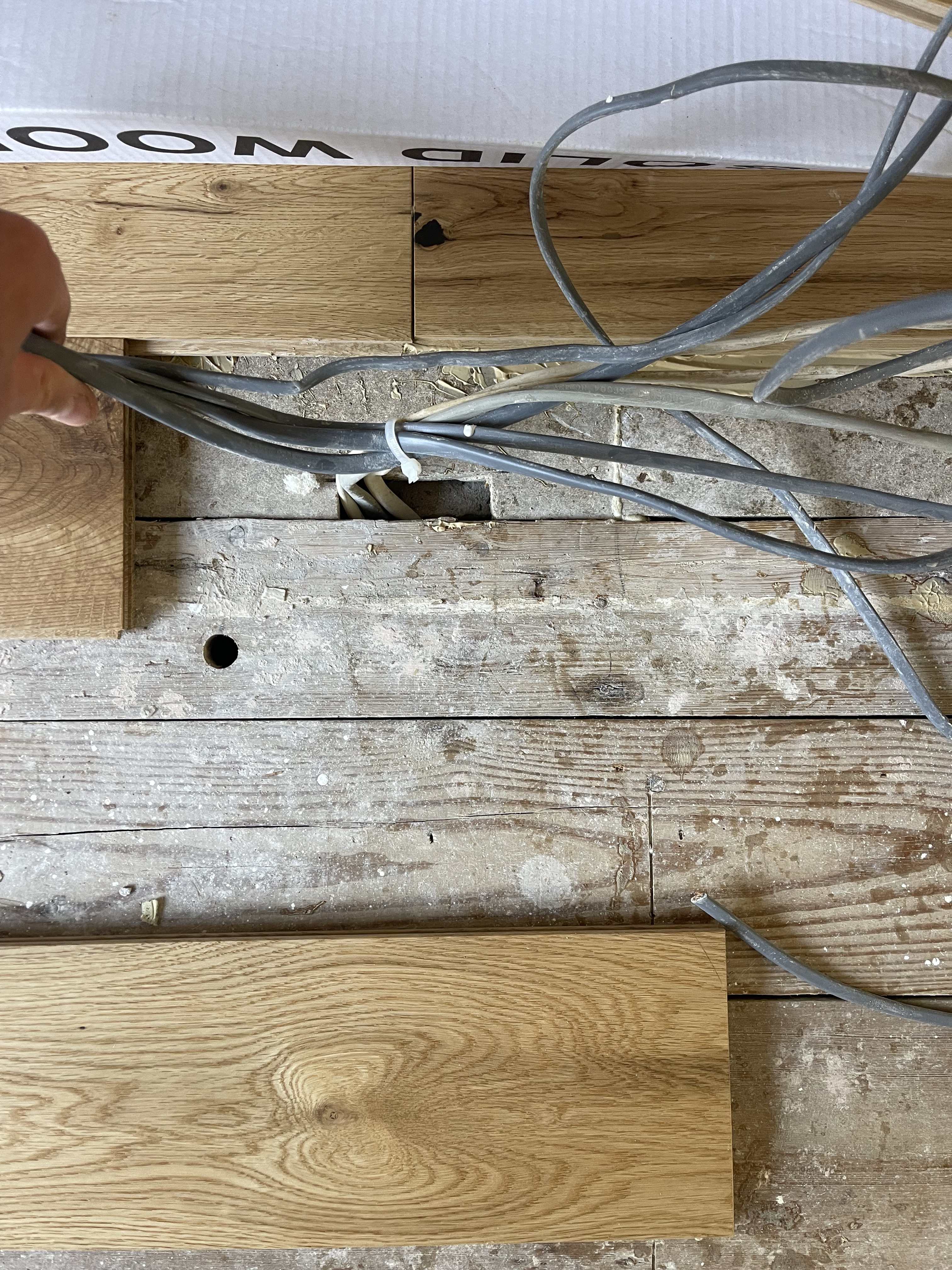

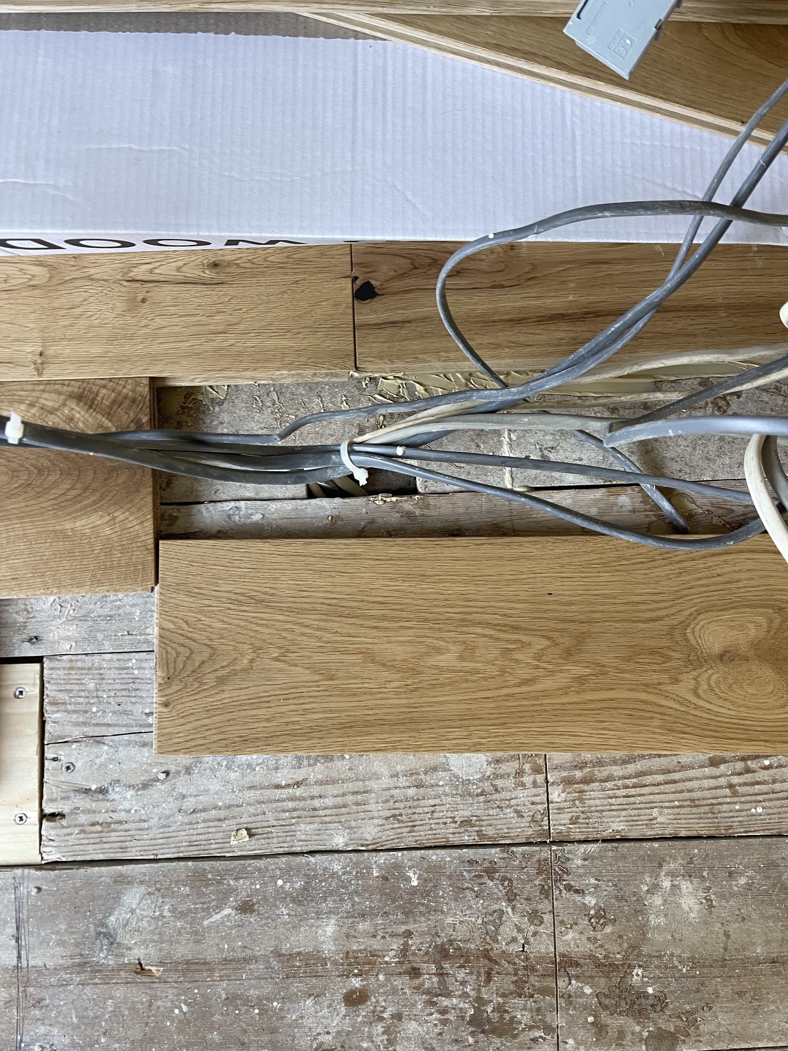

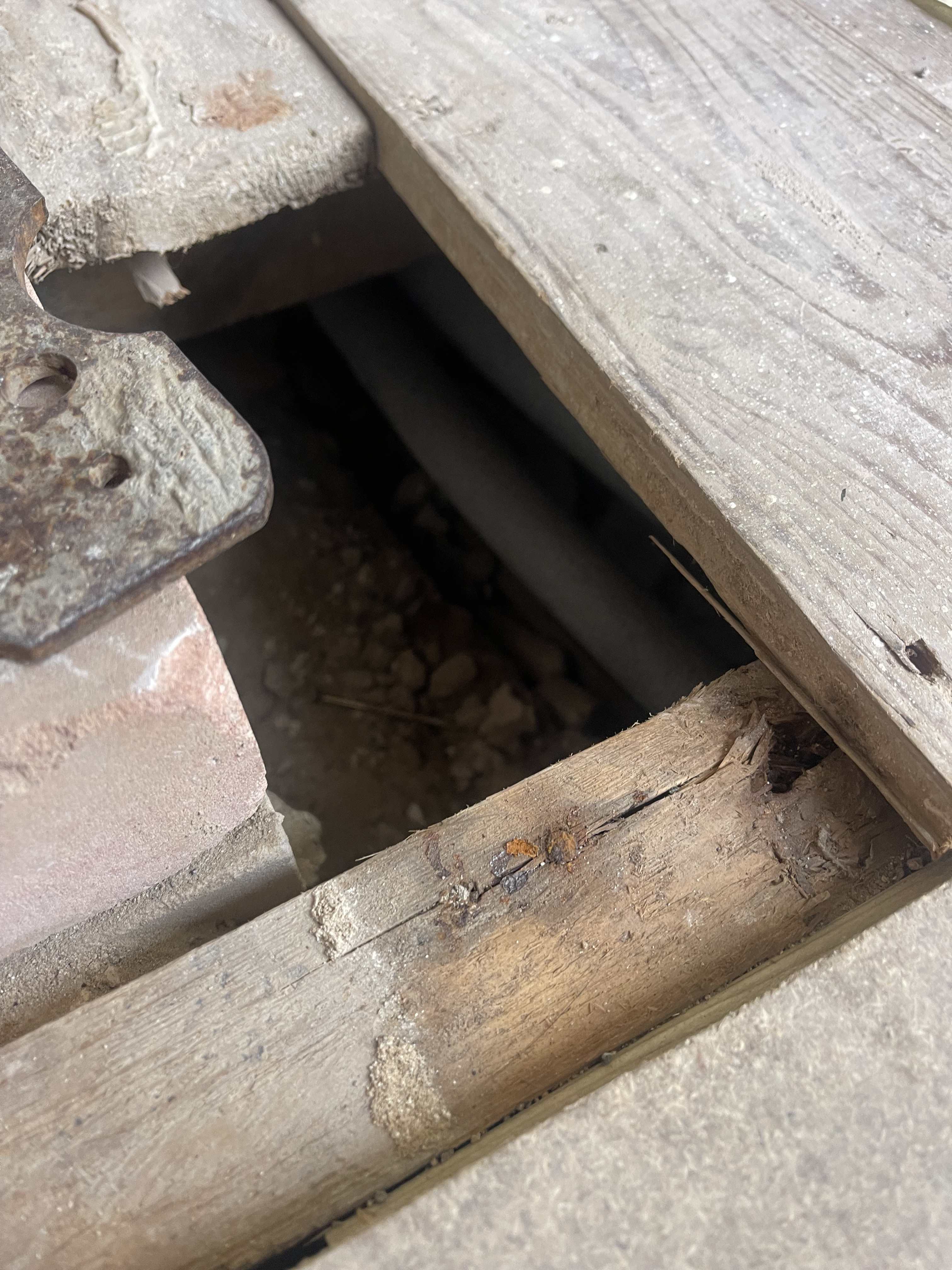

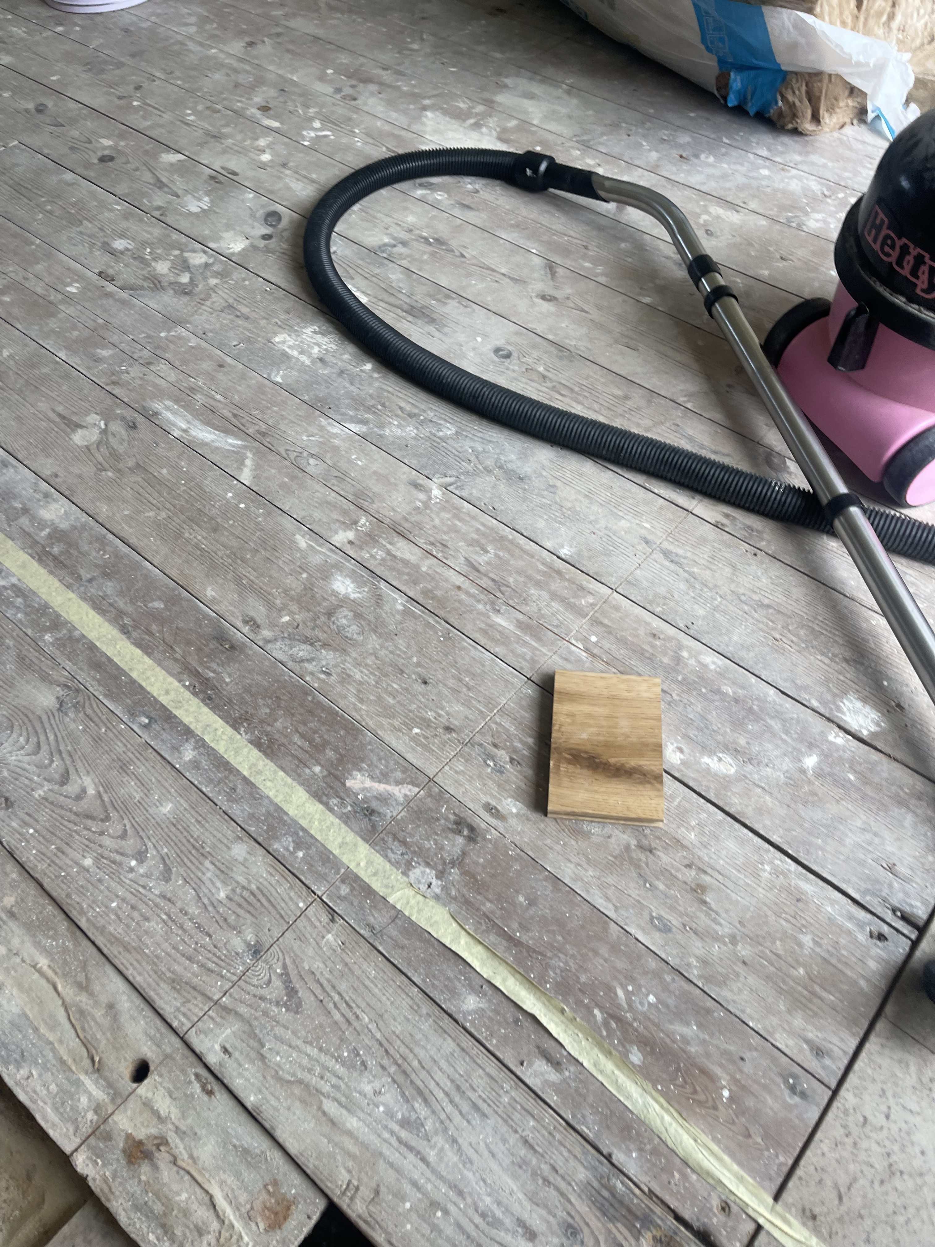

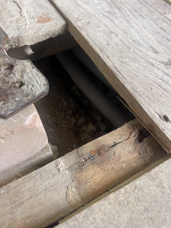

AdamD Posted 8 hours ago Posted 8 hours ago Which underlay for solid oak on both concrete and timber floor boards above suspended floor?
Nickfromwales Posted 8 hours ago Posted 8 hours ago You'll need to work out if there's need for moisture control and where you're integrating that. For the timber floors I doubt you'll need any underlay, but some insulation may be of benefit. Can you provide some more details of what's there / what you propose?
