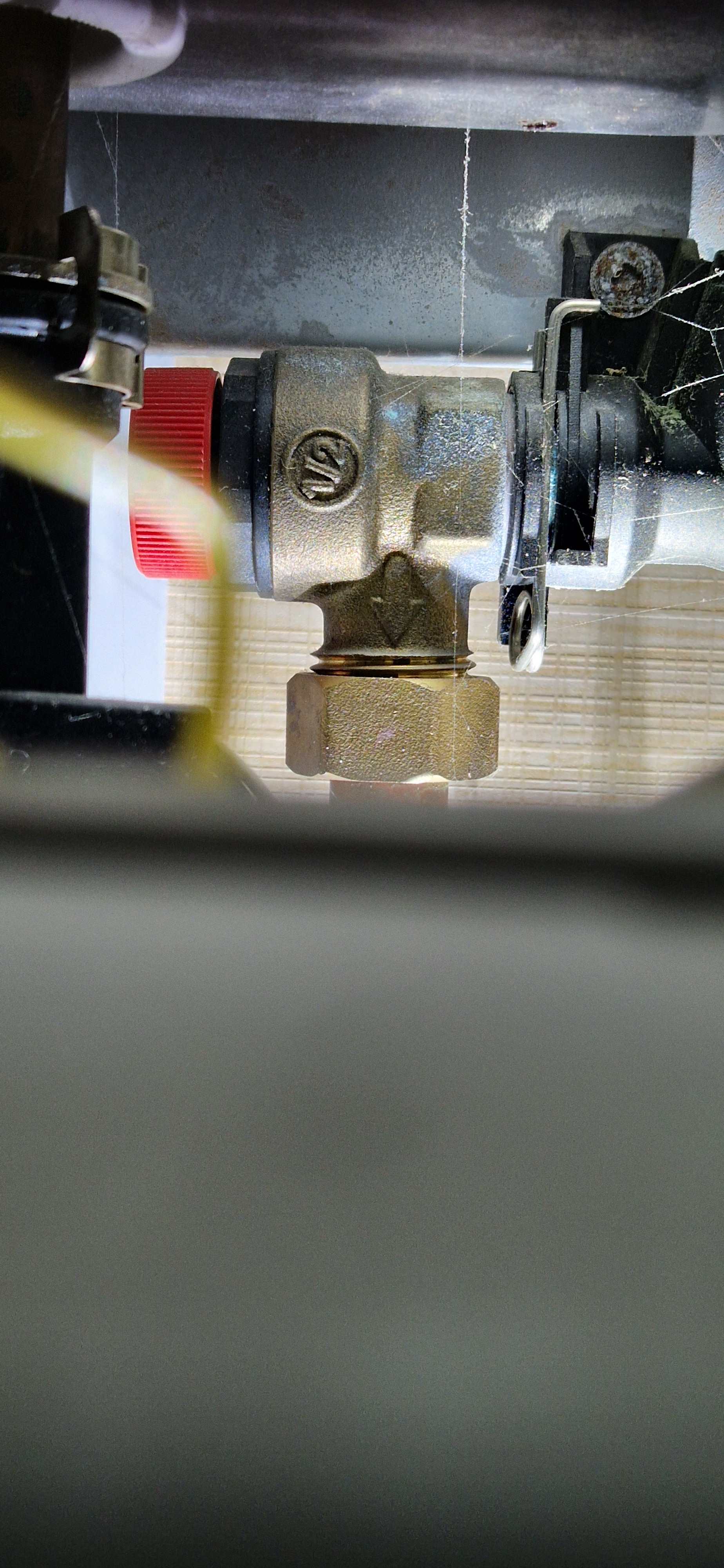

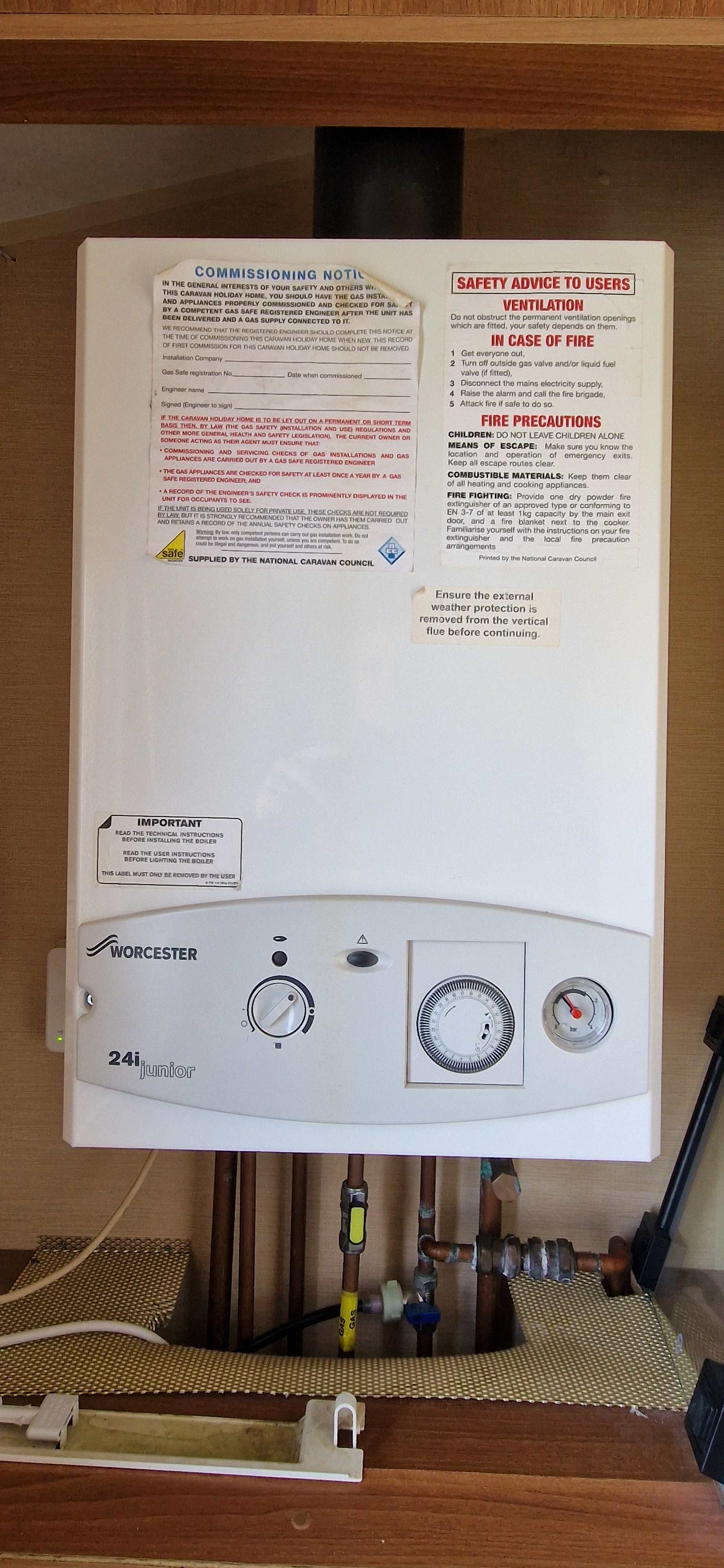

April 2Apr 2 Our Static Caravan has a Worcester 24i Junior combi boiler... It's losing pressure. I re-pressurised the boiler to 1.5 bar (cold) and ran the boiler, there is water dripping quite fast out of the PRV discharge, but the system pressure doesn't exceed 2.5 bar with heating on.I'm guessing it's the PRV that's at fault? Is this it? Any words of wisdom here? I'd be grateful... It doesn't look like rocket-science to change it?

April 3Apr 3 I’m one for caution but it’s just push fit with a retaining clip. Worst thing that can happen here is you get wet tbf. Drain down, get a towel, isolate the electrics to the boiler, and get it swapped out. You'll need a lint free cloth to clean out the receptacle and some silicone grease to lube the o ring on the new item. Slight twisting motion when you offer it back in. Same retaining clip will be fine.
