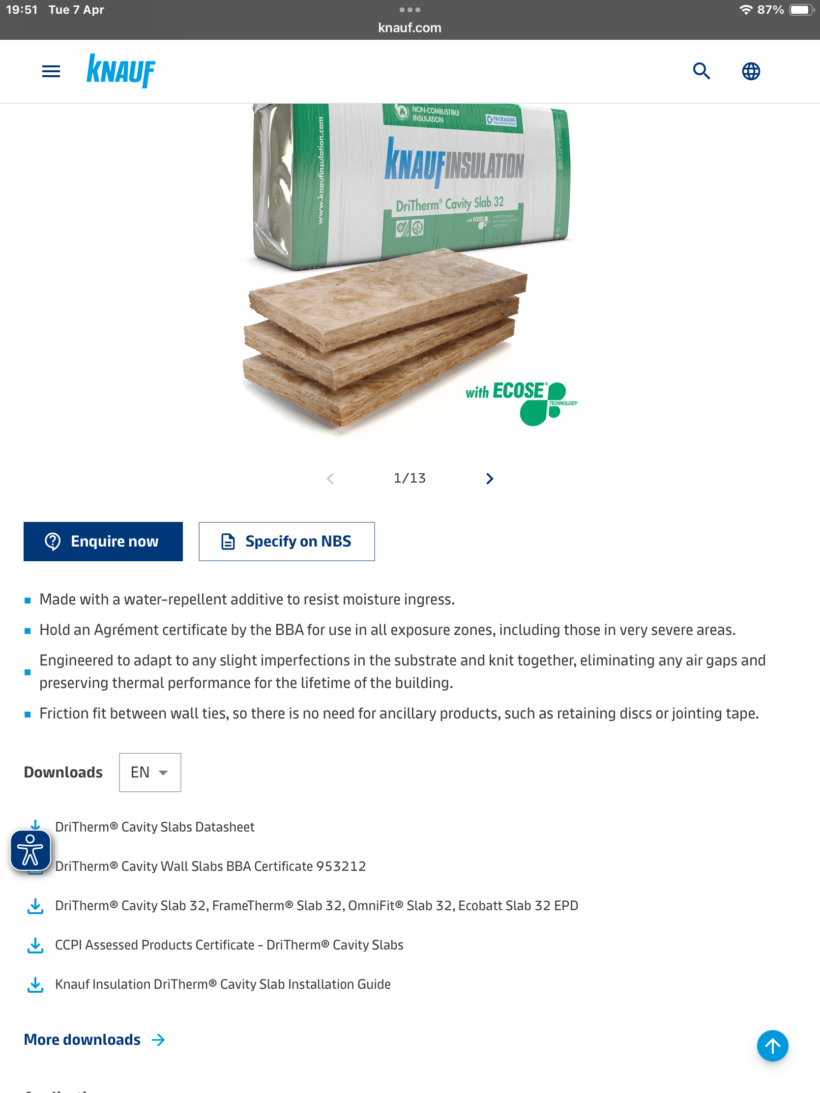

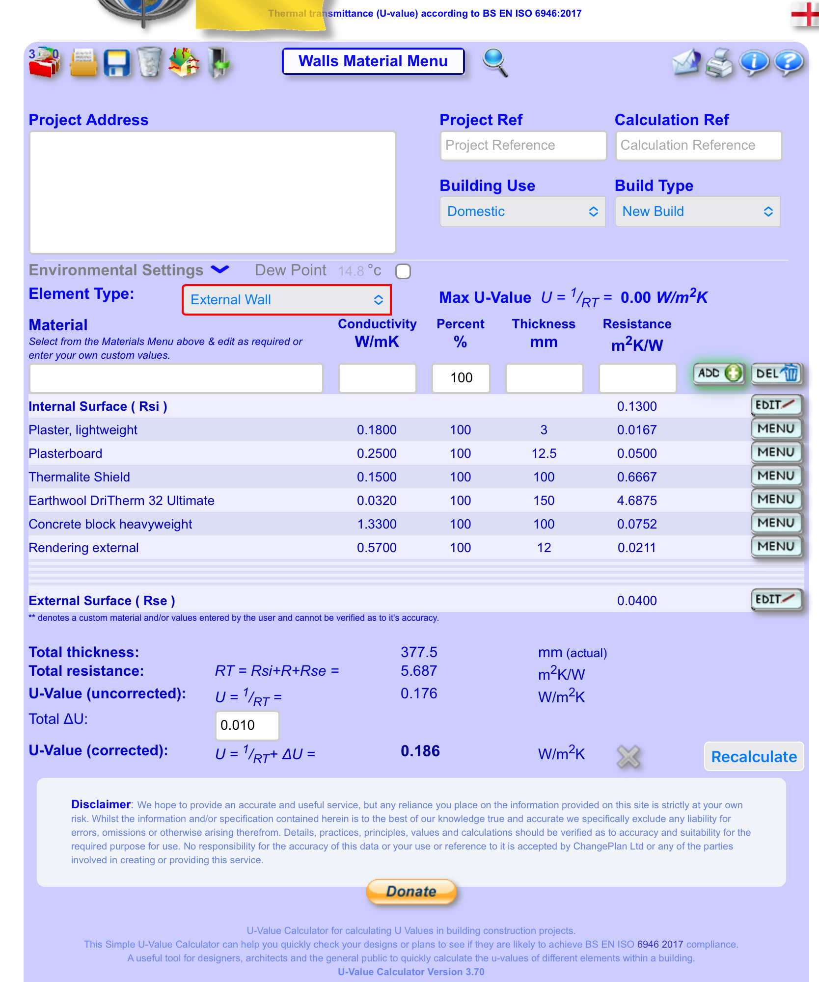

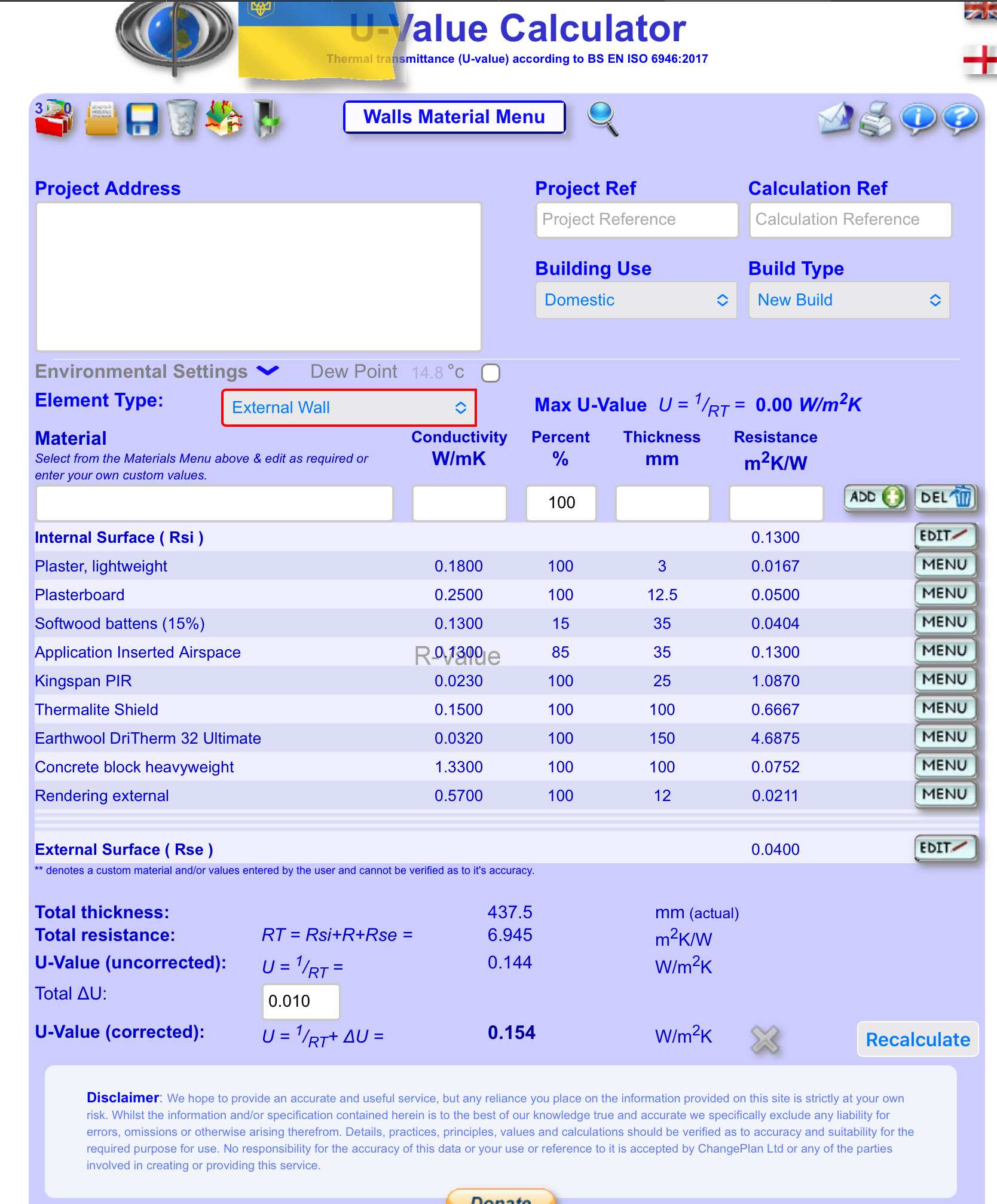

Iceverge Posted 9 hours ago Posted 9 hours ago On 04/04/2026 at 08:35, allthatpebbledash said: What was the cost difference between using PIR and the wool batts? Are there any alternatives to this specific brand? I want to ideally beat the new wall construction u-value of 0.18w. I did some calculations online using that German website I seen linked on here. Keeping a cavity at 150mm, the PIR on paper appears better. But that’s the topic being discussed here, theoretically it does. If construction doesn’t meet proper standards, how much of the supposed r value is lost? PIR achieves 0.15W Mineral wool batts gives 0.18W I can build a wider wall of course and throw in more mineral wool? Then for the lintels use split lintels and avoid the catnic thingies? That "mineral insulation panel" has a k value of 0.045W/mK. try it again with a "mineral wool 035" or "hk 33" for the EPS beads.
