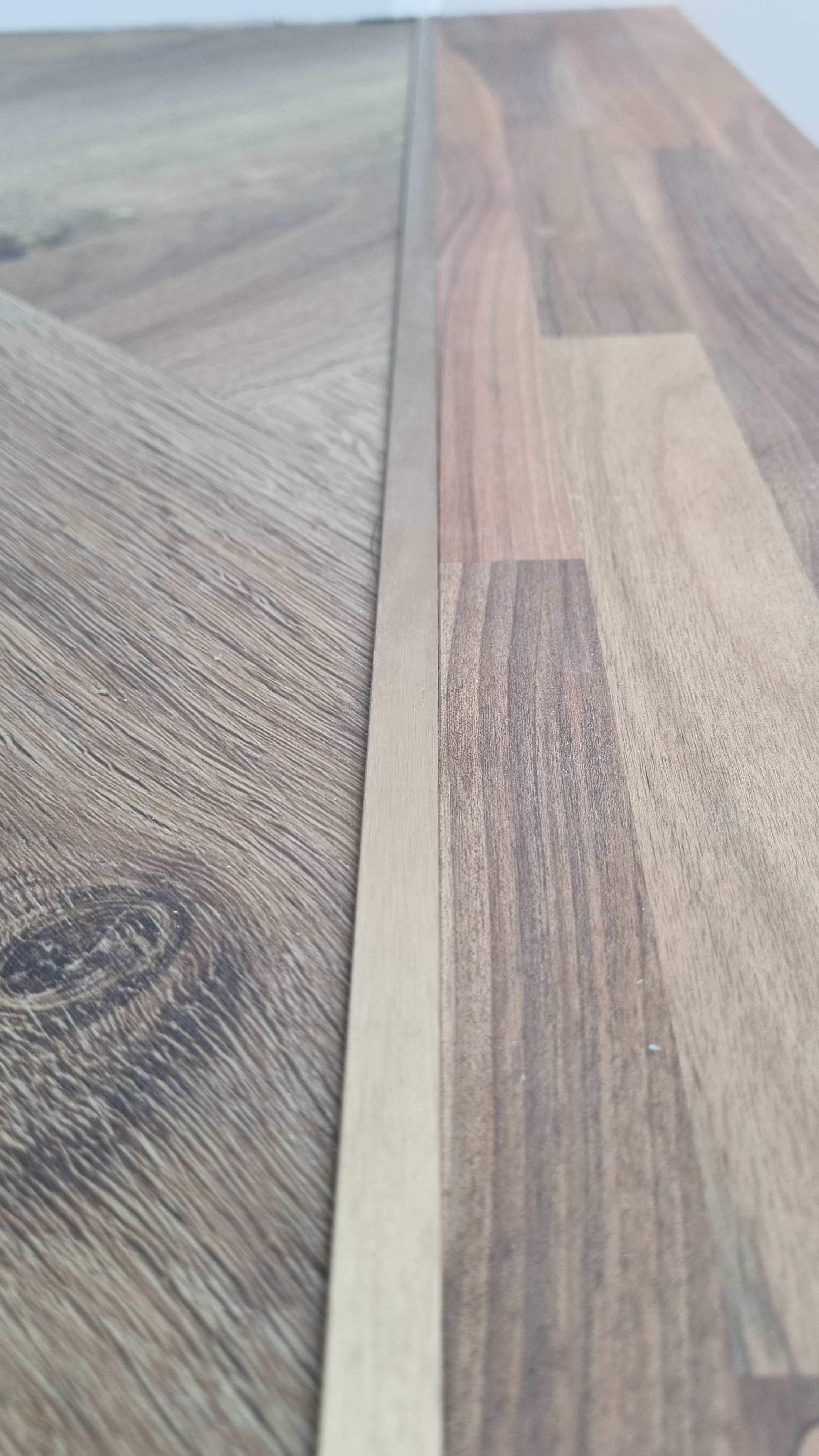

BotusBuild Posted March 19 Posted March 19 I used tile trim from my local tile shop. Cut back the bit that would normally go behind the tile leaving about 5/6mm to stick it to the wall/door frame/top step of stairs (as in picture) 1
