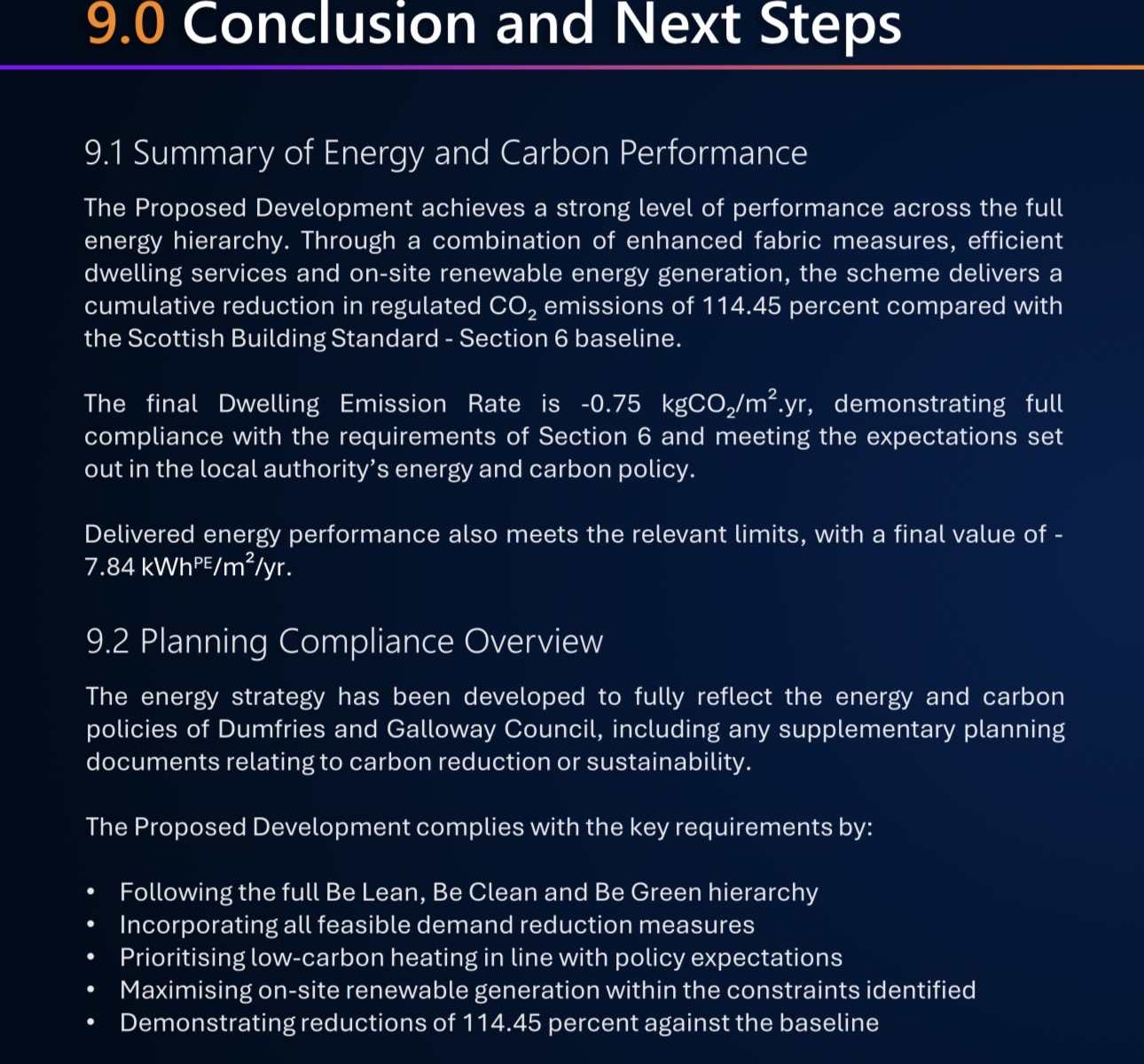

Just to come back to this.
The planning officer did want the energy statement at planning stage by a registered assessor to make sure the building will meet criteria before giving it the go ahead.
I went ahead and instructed Energy Digest to do the statement, SAP and overheating report.
Yes it cost a bit but it’s done now and ready for the building warrant stage.
SAP came in at 111 A+
Co2 reductions below.
Planning permission has been granted 👍😁
