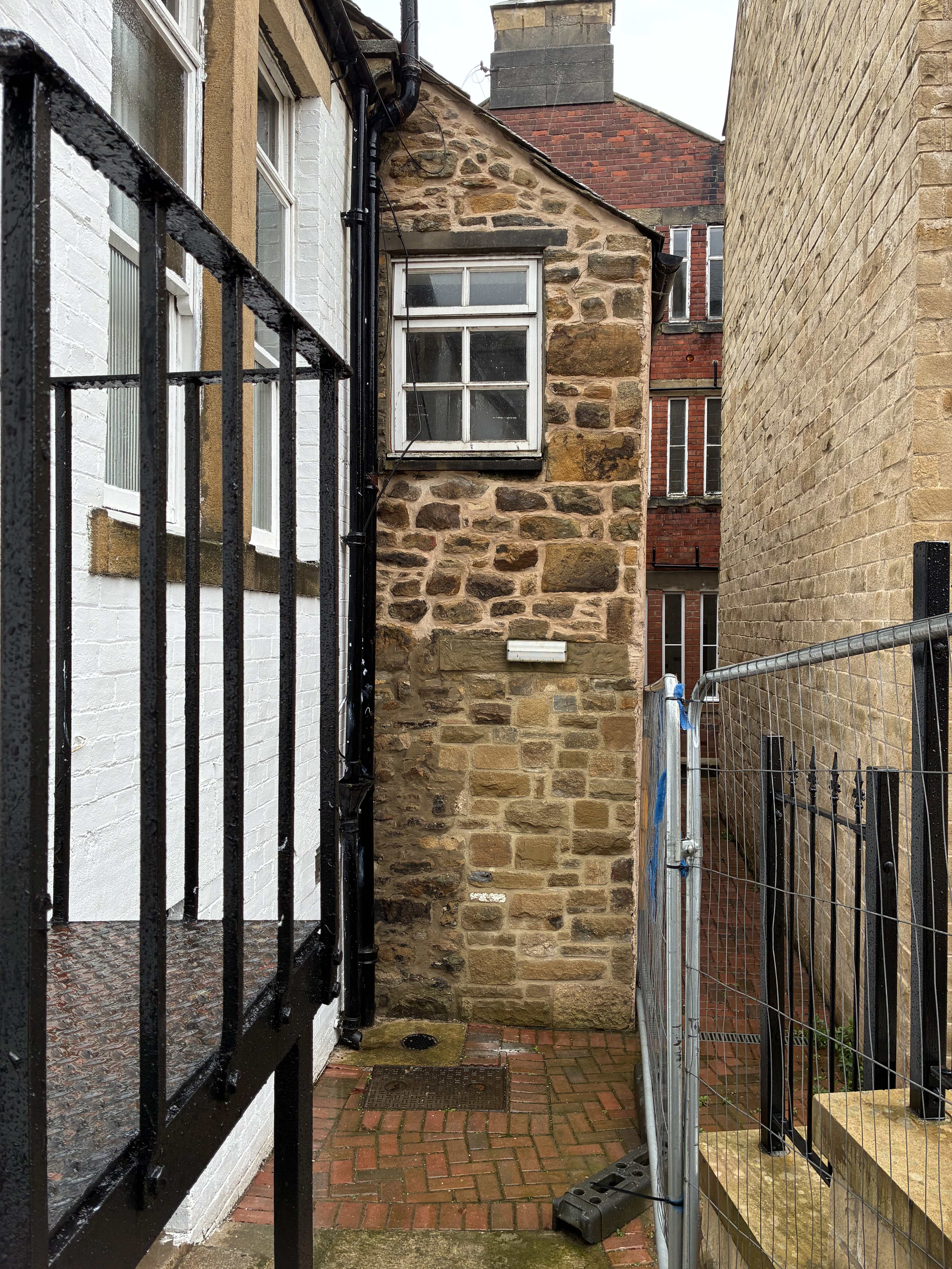

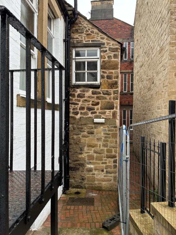

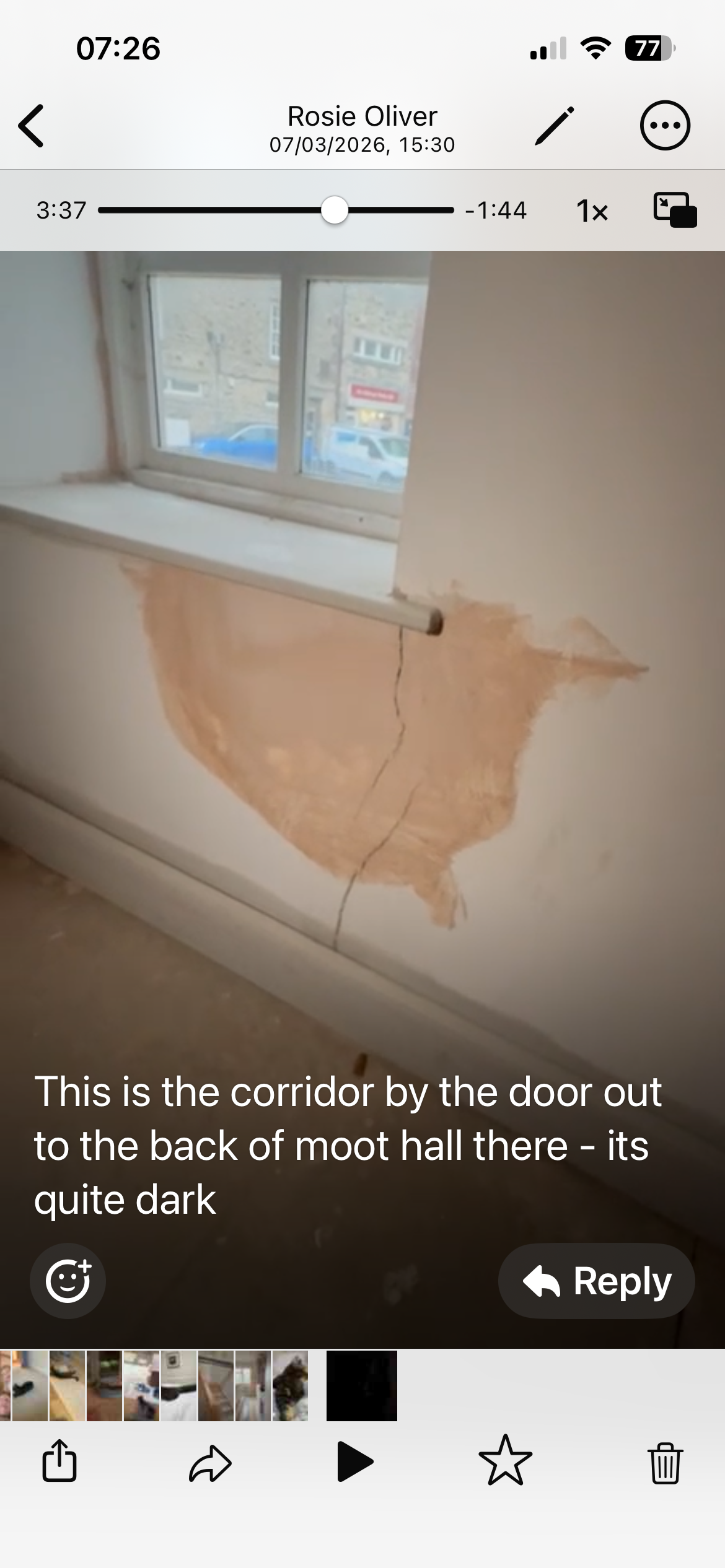

March 9Mar 9 Be interested in experienced opinion re this cracking in the upper floor of a Victorian renovation project I’m considering? Does it look like a serious issue? If so how serious and what remedial measures are required? My worry is the location on the upper corner of the building. It looks straight enough outside from both the ariel and ground view, but it has recently been repointed so maybe exterior cracks have been covered up (see pics). There is also some cracking above the window where the wall joins the ceiling but it has been patched up so not worth attaching the photo.
March 9Mar 9 good morning, do you have any pics of the outside looking at the crack area and what is at ground level.

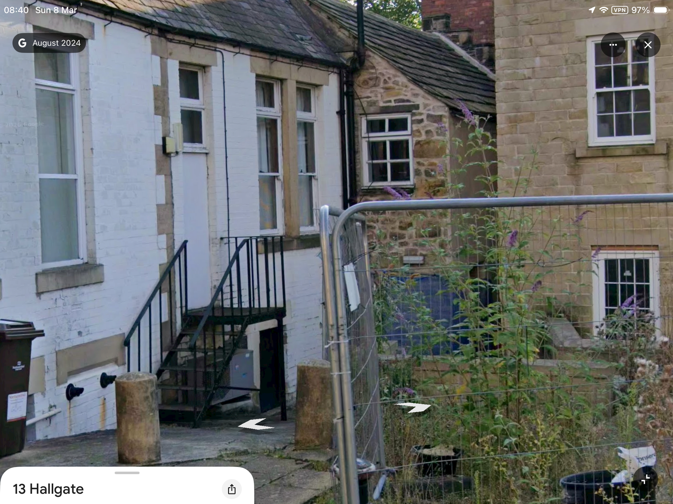

March 9Mar 9 Author 5 minutes ago, markc said: good morning, do you have any pics of the outside looking at the crack area and what is at ground level. Yes the second picture of the 3 I attached shows the window which has the cracks below it, but that is as close as I can get. I also think that what might have been visible from the exterior has been masked by repointing?
March 9Mar 9 Author 11 minutes ago, markc said: good morning, do you have any pics of the outside looking at the crack area and what is at ground level. This is the best I can do for the time being…
March 9Mar 9 @DavidO I would be wary with this one, fresh cracking on an internal repair means recent movement and as you say, external pointing could mask anything. My feeling is the pretty recent works around the Brunton Residential building has caused movement or settling of the adjacent wall and could require underpinning in a pretty tight site.

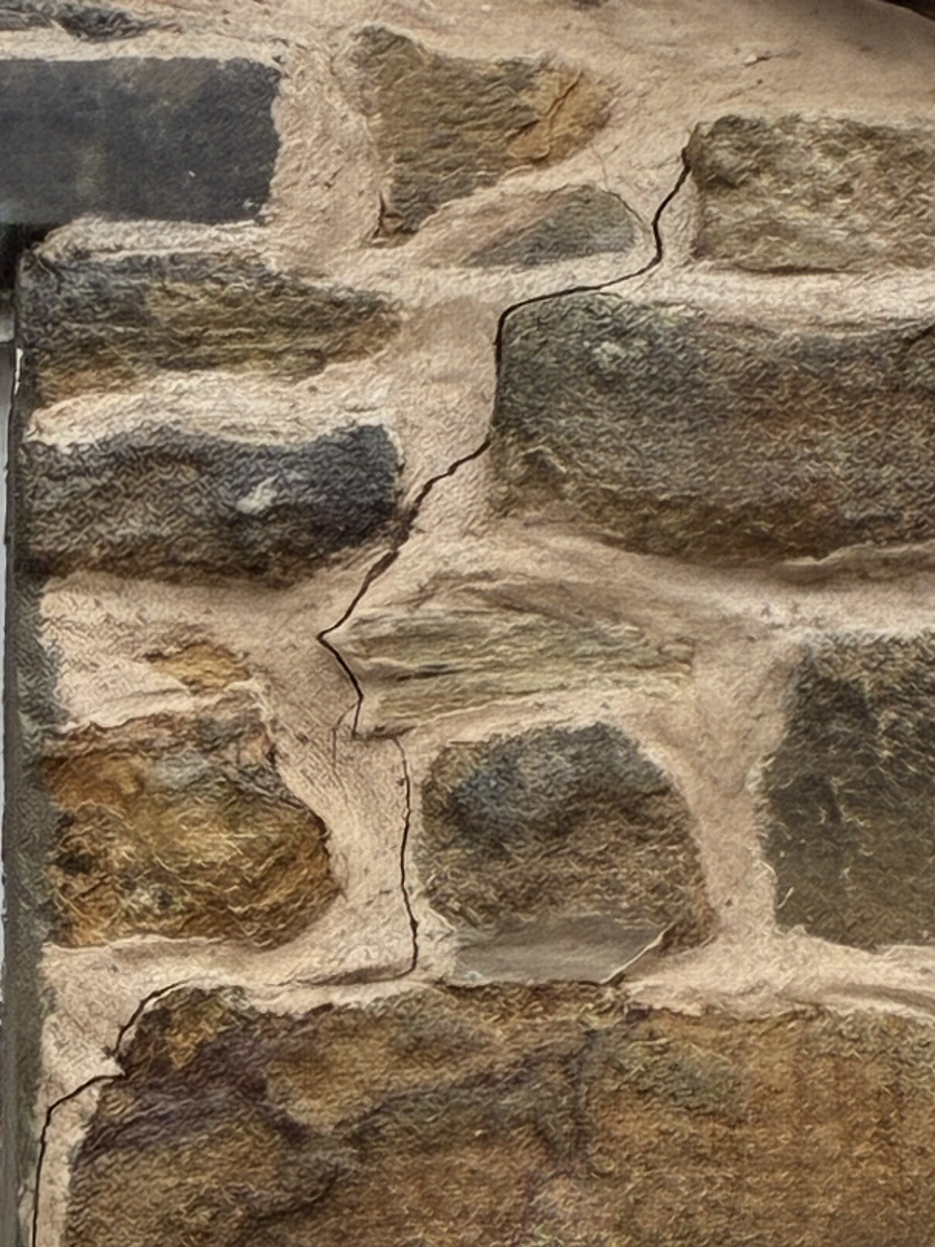

March 12Mar 12 Author On 09/03/2026 at 08:12, markc said: good morning, do you have any pics of the outside looking at the crack area and what is at ground level. Been able to get a bit closer today….So, yes there is also cracking visible on the outside. It looks as though à door or possibly a window has been filled in right on corner of the building a most of the area below the window has been repointed at least a couple of times? Also significant is that there another door just round the corner which is still in use, so the adjoining 90degree wall isn’t going to contribute much in the way of structural integrity to that corner of the building as a whole. Does anyone think it could be satisfactorily tied together with stitching rods?
March 12Mar 12 I don't think crack stitching will work with random stone. It needs horizontal mortar beds. You are braver than me to even look at this property.
