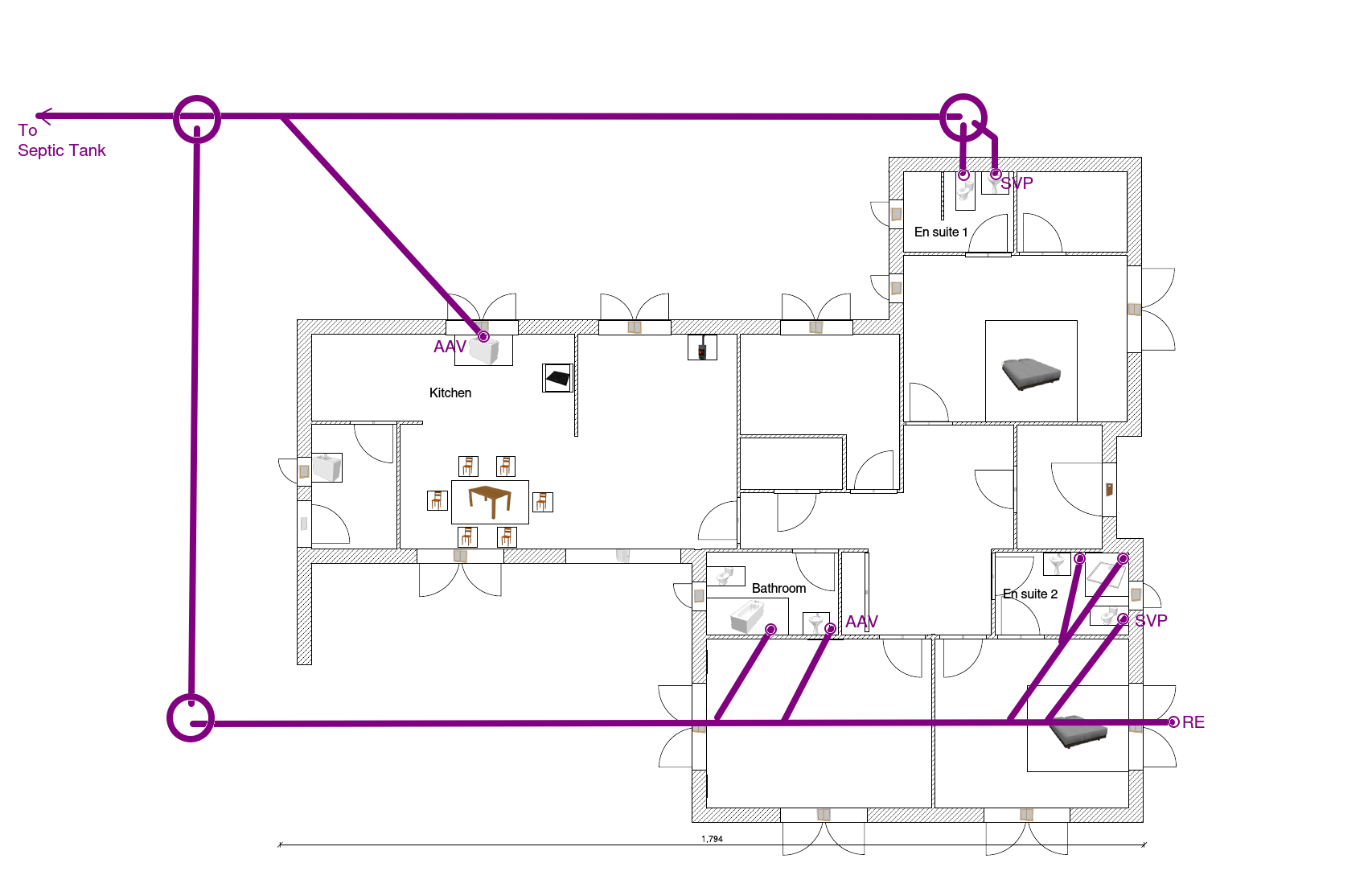

AndySat Posted 8 hours ago Posted 8 hours ago I'm starting to plan for the roofing on my build and one of the questions the roofer had was how many SVP will be needed through the slates. Am I correct in thinking that only the end of each branch needs an SVP? I recall some disussion about AAV instead of SVP and I'd like to avoid vent pipes through the roof as far as possible - less boxing in and less problems with air tightness. Diagram shows how I think the soil pipes are routed (inspection chambers are currently under scaffolding so I can't check, but hopefully more or less correct). NB the bathroom layout is not yet finalised, hence the apparent lack of soil pipe to the toilet! Thanks!
Oz07 Posted 8 hours ago Posted 8 hours ago I think potentially you'd only need one. I'm sure some people have said not every house even needs one. One at the end of each of those runs won't hurt
Nickfromwales Posted 7 hours ago Posted 7 hours ago 18 minutes ago, AndySat said: I'm starting to plan for the roofing on my build and one of the questions the roofer had was how many SVP will be needed through the slates. Am I correct in thinking that only the end of each branch needs an SVP? I recall some disussion about AAV instead of SVP and I'd like to avoid vent pipes through the roof as far as possible - less boxing in and less problems with air tightness. Diagram shows how I think the soil pipes are routed (inspection chambers are currently under scaffolding so I can't check, but hopefully more or less correct). NB the bathroom layout is not yet finalised, hence the apparent lack of soil pipe to the toilet! Thanks! No AAV’s needed for ground floor fixtures if the invert is less than 1300mm. The AAV’s relieve vacuum caused by flush water dropping at speed, but at such short drops this doesn’t become an issue at all. Saves annoying / ugly boxing in and the need for access to the 110mm AAV’s. Only 1x SVP needed, and you can reduce this to 3” and run it externally, like a faux rainwater down-pipe, if you don’t want to breach the roof at all. Defo no need for multiple SVP’s! 1
AndySat Posted 6 hours ago Author Posted 6 hours ago 1 hour ago, Nickfromwales said: Only 1x SVP needed, and you can reduce this to 3” and run it externally, like a faux rainwater down-pipe, if you don’t want to breach the roof at all. Defo no need for multiple SVP’s! Brilliant, thanks! I can live with a single 3", much easier to route than 2 x 110mm. I may also get an AAV for the kitchen, we fitted one in our last house to solve a problem with gurgling when the sink was emptied (although that was an island sink and the waste pipes were a bit like spaghetti junction).
Nickfromwales Posted 5 hours ago Posted 5 hours ago 32 minutes ago, AndySat said: Brilliant, thanks! I can live with a single 3", much easier to route than 2 x 110mm. I may also get an AAV for the kitchen, we fitted one in our last house to solve a problem with gurgling when the sink was emptied (although that was an island sink and the waste pipes were a bit like spaghetti junction). You just need a 40mm one under the sink, after the trap. The gurgling is worse when you use a 'combination' aka 'appliance' trap, with the short spigot to push the appliance discharge hose on to. The issue is, these connect before the trapped water and are therefore glugging away directly under the plughole and entirely audible to the room. Combat this by installing dedicated bottle or P traps for the 1 or 1.5 bowl(s), and additional dedicated washing machine upstand type traps for the appliances. The tiny bit of noise stays in the under-sink cupboards then. 1
