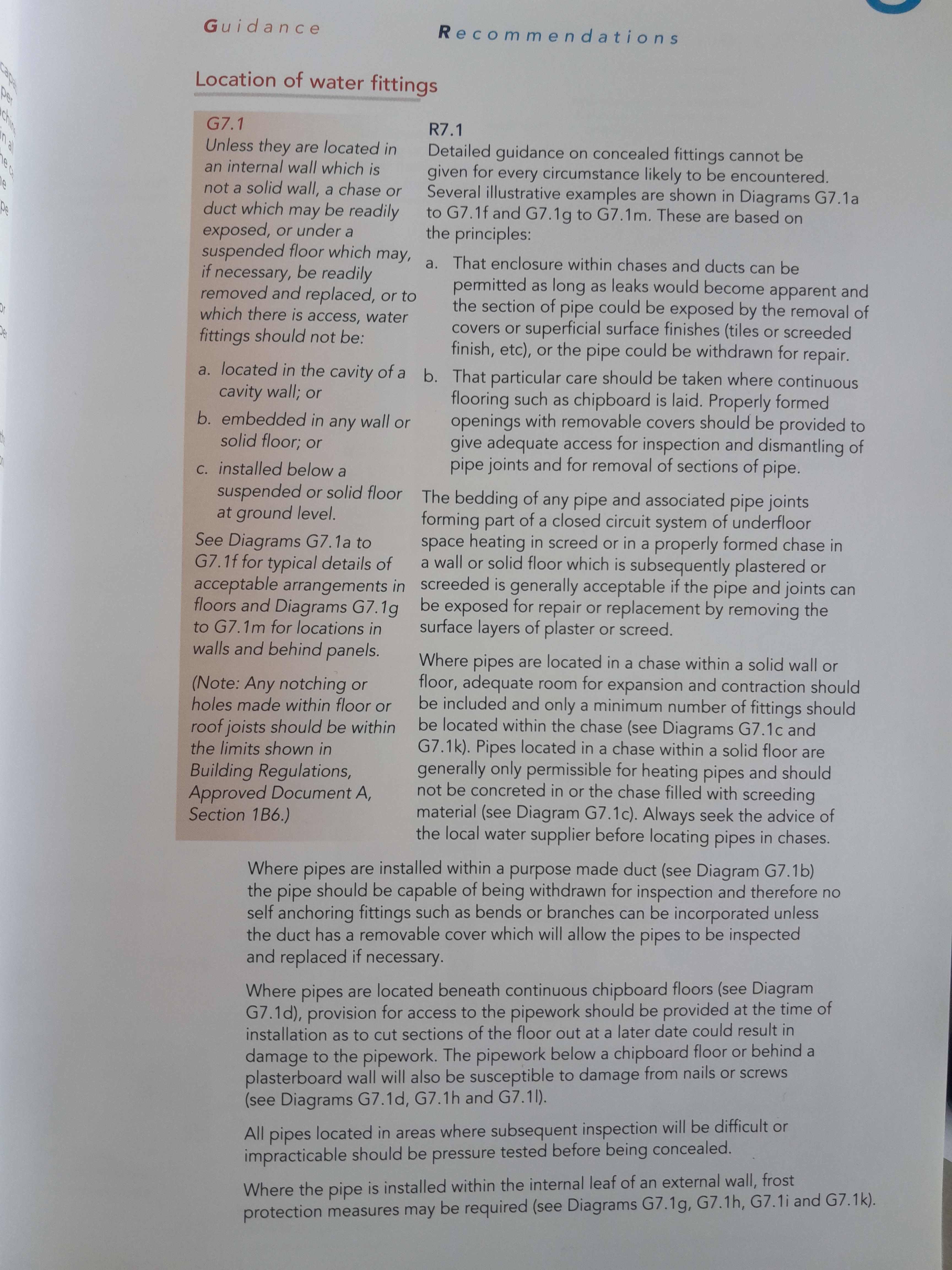

saveasteading Posted 2 hours ago Author Posted 2 hours ago 55 minutes ago, SimonD said: no fittings should be embedded in a floor or wall, 'Embedded' to me means locked solid in concrete or masonry. ie there could be differential stresses that could break the pipe or a joint, and cause water damage. That is sensible.
Nickfromwales Posted 1 hour ago Posted 1 hour ago 28 minutes ago, saveasteading said: 'Embedded' to me means locked solid in concrete or masonry. ie there could be differential stresses that could break the pipe or a joint, and cause water damage. That is sensible. Embedded means when you cannot get to them afterwards without destruction of property (kinda thing). I could send you the regs, but it's late and I can't be arsed to write my version. You'll not be turned by simple folk such as myself, so barrier it is.
