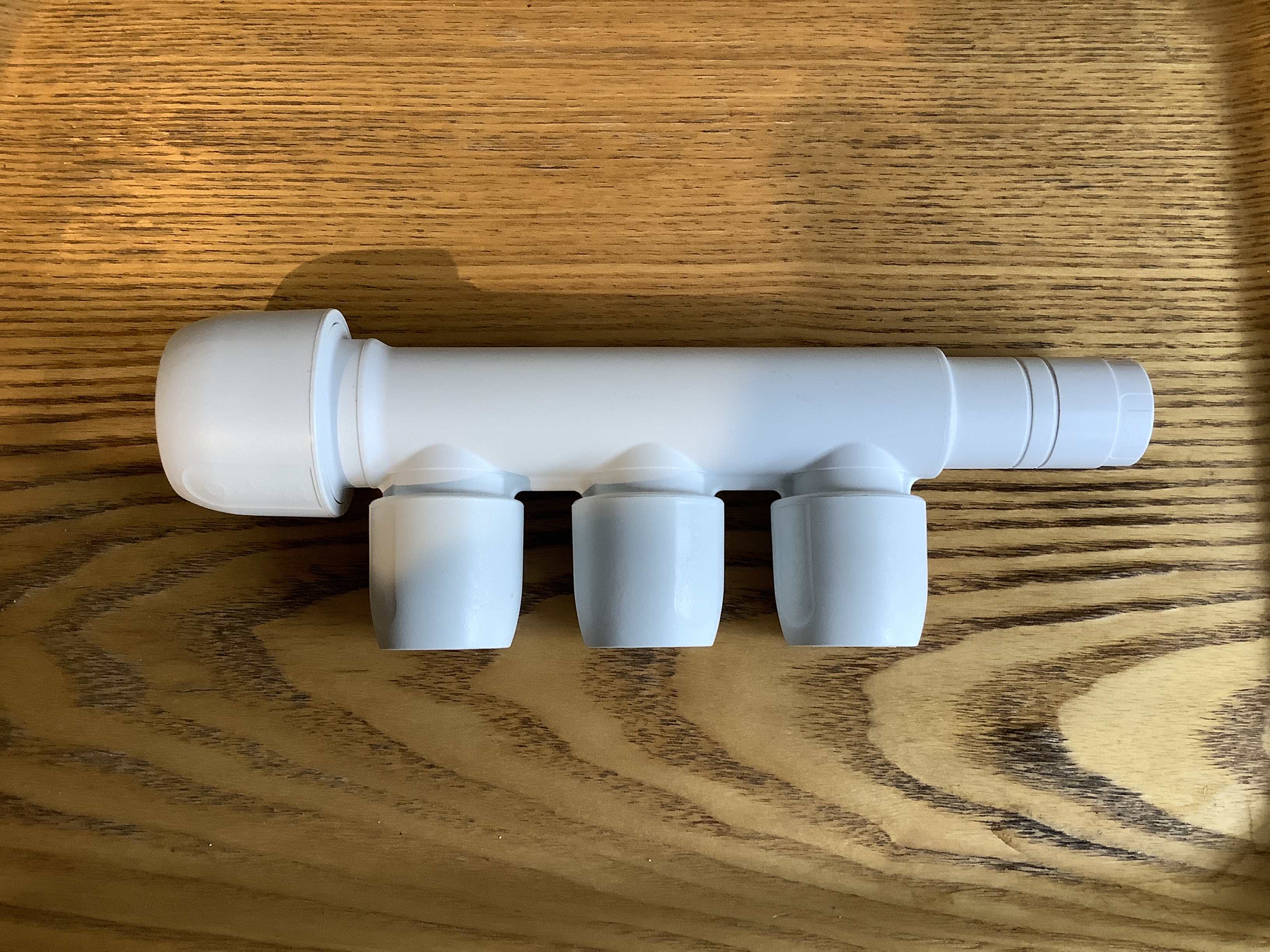

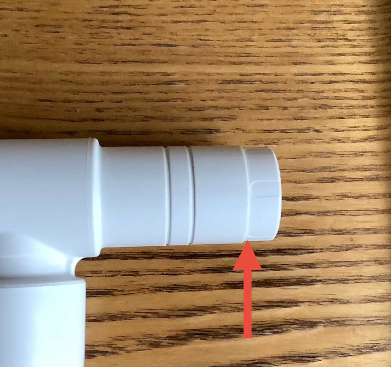

G and J Posted 7 hours ago Posted 7 hours ago I have a cunning plan my lord. Above my UVC I’m going to use a HEP2O 22mm x 10mm manifold daisy chained with a HEP2O 22mm x 15mm manifold, both closed spigot versions. I won’t need to open the closed spigot on the second manifold, but I will the first one. Can I find instructions as to how exactly to do it? Not even slightly. AI tells me to use a HEP2O key (duh!), bless it. But do I just cut it off? If so, where exactly? Where it narrows as indicated my my red arrow? And do I use an insert? Oh the stress! If a passing grown up knows the answers I’d be ever so grateful….
Nickfromwales Posted 6 hours ago Posted 6 hours ago 7 minutes ago, G and J said: I have a cunning plan my lord. Above my UVC I’m going to use a HEP2O 22mm x 10mm manifold daisy chained with a HEP2O 22mm x 15mm manifold, both closed spigot versions. I won’t need to open the closed spigot on the second manifold, but I will the first one. Can I find instructions as to how exactly to do it? Not even slightly. AI tells me to use a HEP2O key (duh!), bless it. But do I just cut it off? If so, where exactly? Where it narrows as indicated my my red arrow? And do I use an insert? Oh the stress! If a passing grown up knows the answers I’d be ever so grateful…. Yes, where the red arrow is. Use the pushfit pipe cutter, slight rotation as you cut.
G and J Posted 5 hours ago Author Posted 5 hours ago 1 hour ago, Nickfromwales said: slight rotation as you cut. OK thank you. Do I turn to my left or my right? 😉
Nickfromwales Posted 5 hours ago Posted 5 hours ago 7 minutes ago, G and J said: OK thank you. Do I turn to my left or my right? 😉 One way the cutter tries to open, the other it wants to bite down. You need the latter. Practice on a piece of 22mm pipe then cut the fitting.
G and J Posted 5 hours ago Author Posted 5 hours ago 3 minutes ago, Nickfromwales said: One way the cutter tries to open, the other it wants to bite down. You need the latter. Practice on a piece of 22mm pipe then cut the fitting. So is it just a slight turn to my right then, not like a full pirouette or anything. I’d better make sure I’m not standing next to a wall or I’ll bang my nose as I spin round lol
