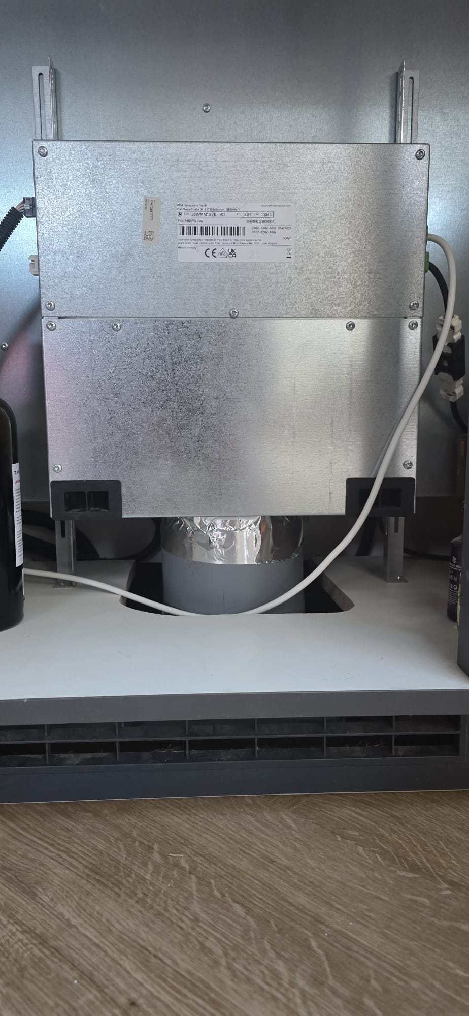

We've had our 900mm Neff Downdraft I98WMM1S7B for over 18 months now. Our MVHR has a double extract (almost) directly above the hob.
The outlet vents through an open vent in the plinth, it has a 90-degree vent on floor level but isn't even ducted to the opening. I took the picture attached just now and took the opportunity to remove the vent and check the opening. There is absolutely no presence of any grease build-up or residue there. The MVHR vent is also grease-free as far as I can tell
Regards
Tet
Thanks for the reassurance. Looks like I was worrying when I didn't need to.
