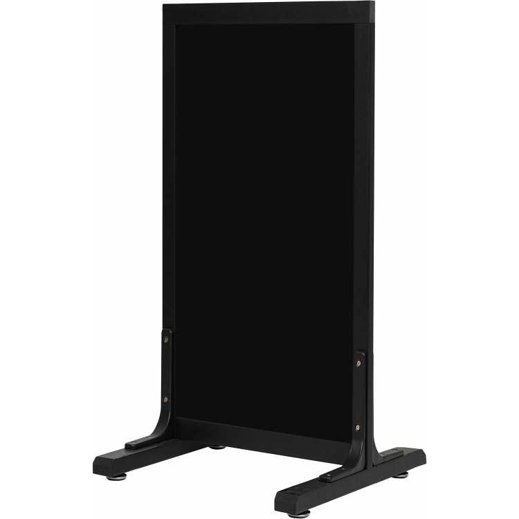

Why not make something self supporting and not touch the walls at all, something like this, but make it nice and solid
