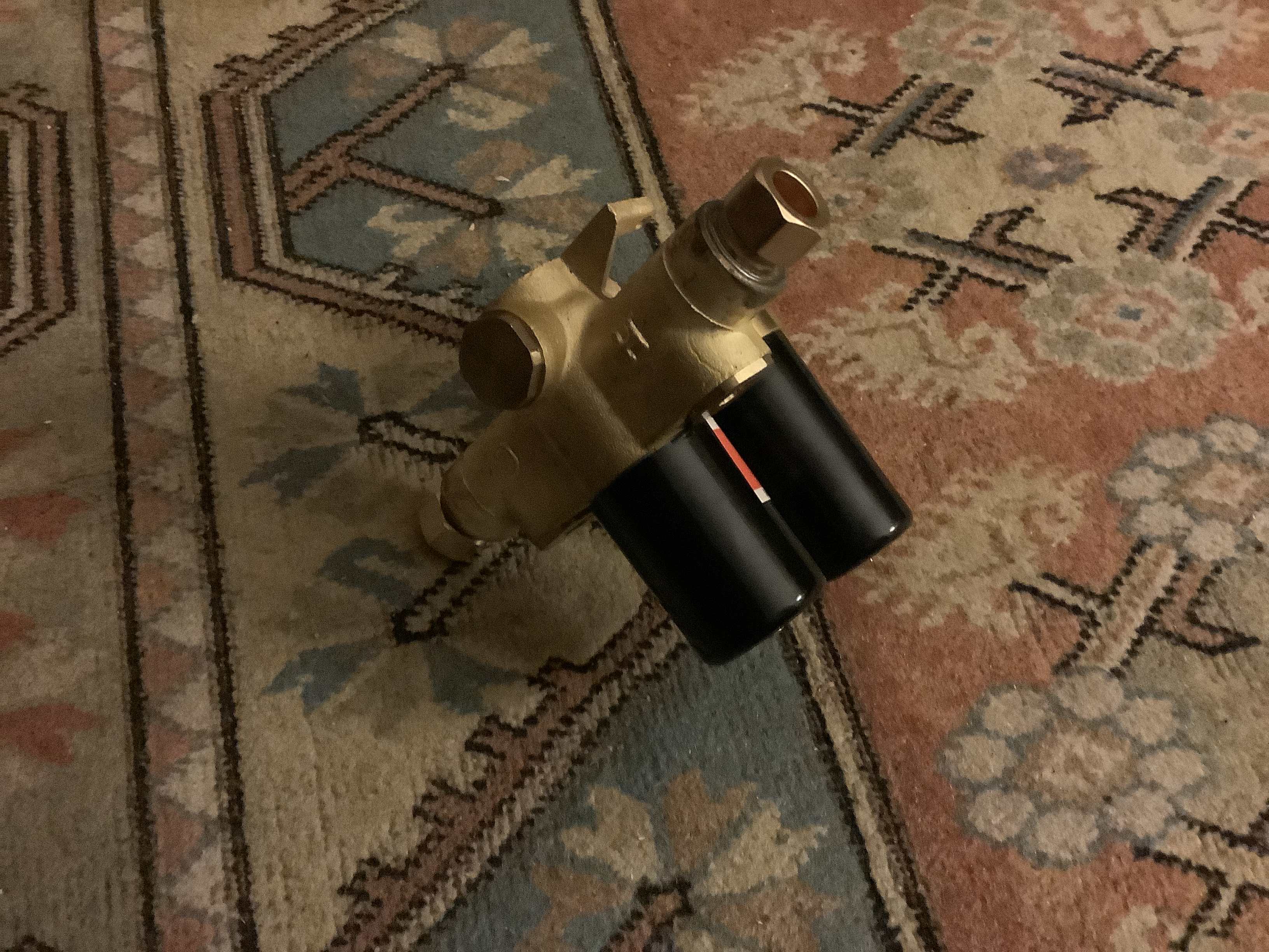

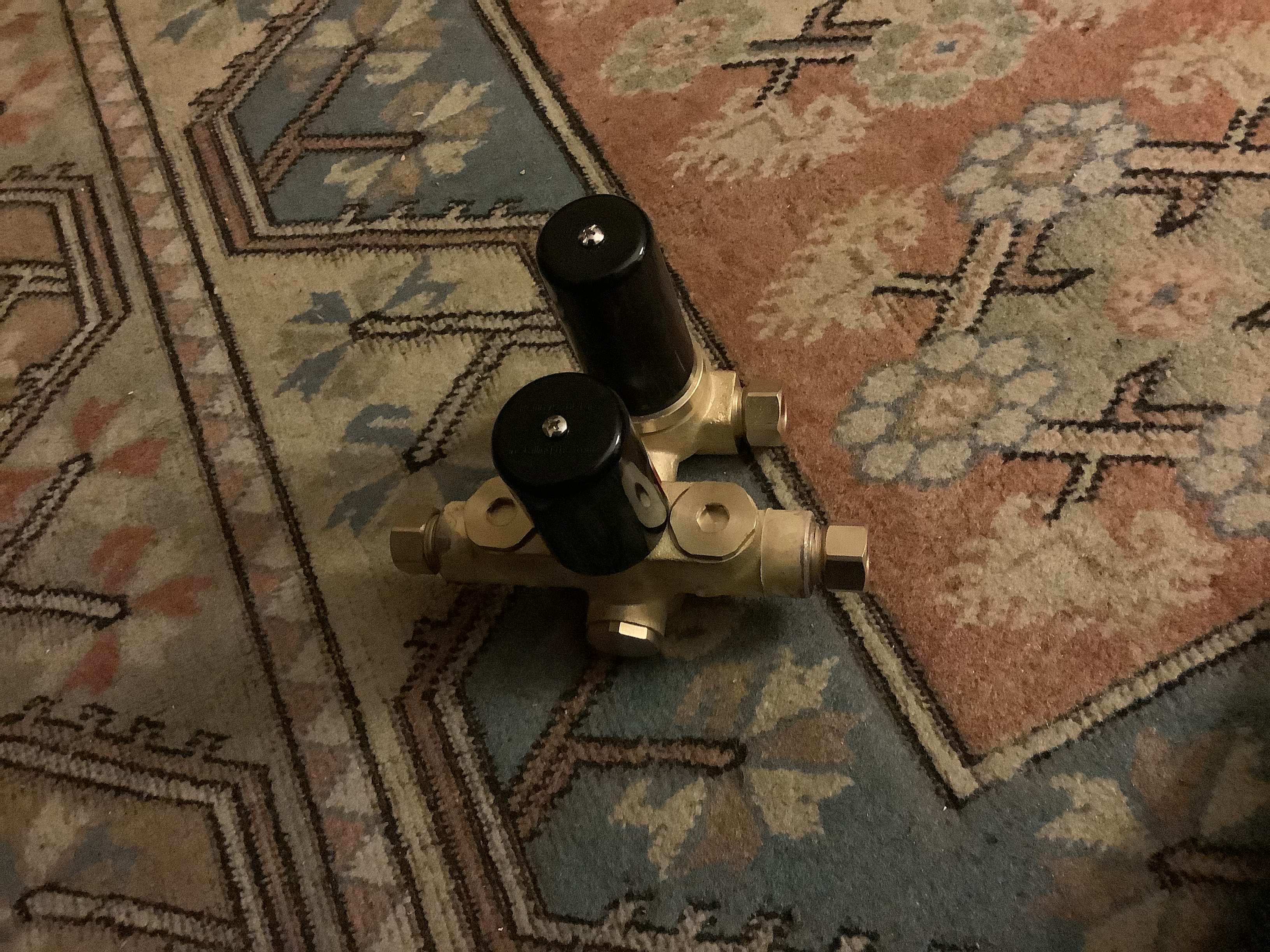

Here’s the valve…

10 hours ago, G and J said:
Here’s the valve
Does the front fascia plate allow access to those two brass hex inserts? Eg, when installed, will they need to be tiled over or is the plate big enough to have them left accessible?
Will chk this eve. And report back......thnx
The plate is big enough to cover the lot, and I could get the tiler to leave holes where the Allen socket bits are….  I’ve not studied the thing enough to understand future maintenance access (but really must soon).  But….
Doesn’t that mean that water getting behind the plate will get into the wall?  (I'm tired from a busy day on site, so if that’s a stupid question then I claim immunity from leg pulling on the grounds of exhaustion and you shouldn’t mock the afflicted!)
The hex bits are usually non returns and can fail, so you defo need JUST clear access to these; don’t let the tiler cut away any more than is necessary.
You put a small bead of clear CT1 around the top and each of the sides of the plate, and seal it to the tiles. Don’t seal the bottom as that gets left as a drip.

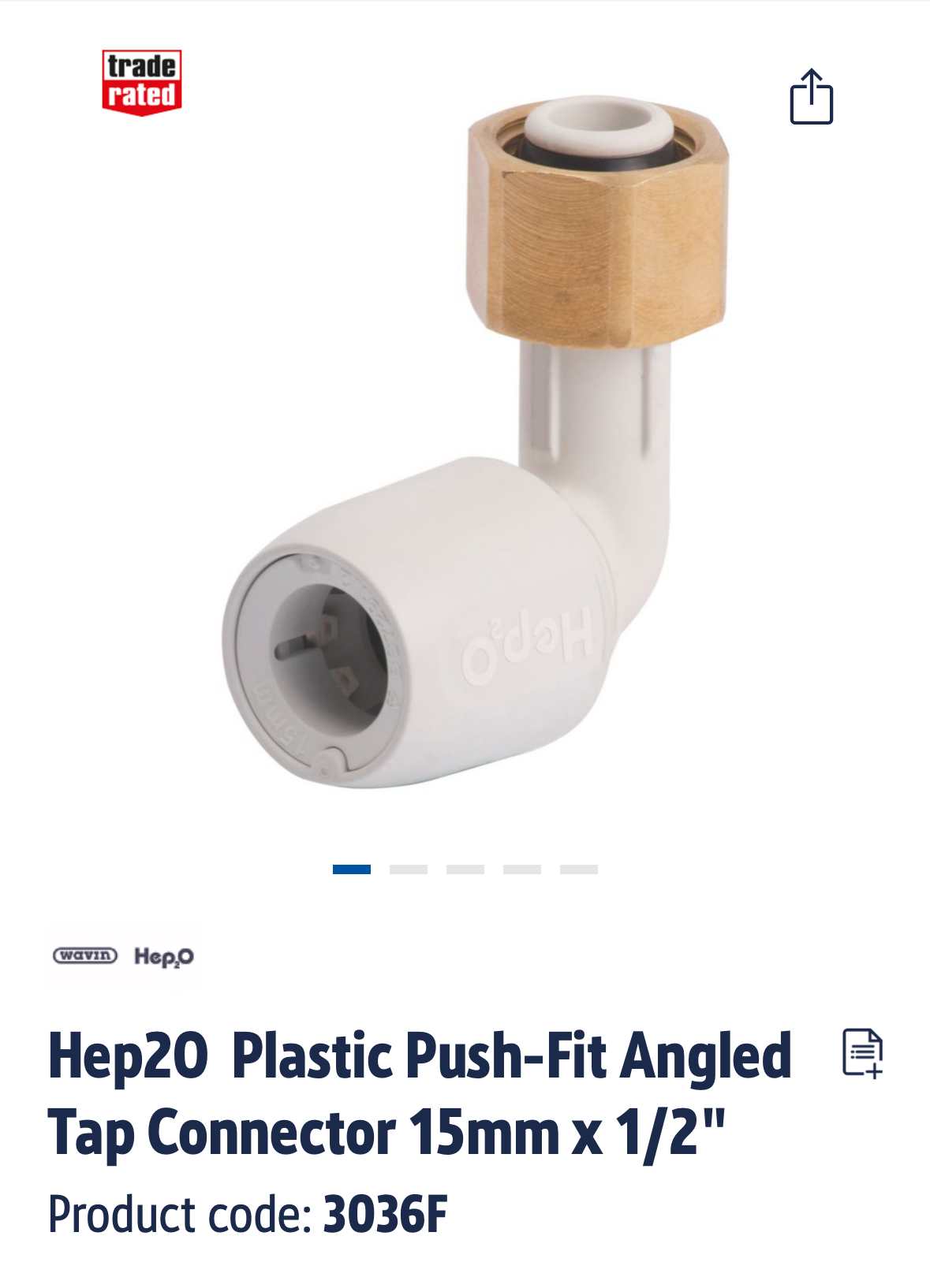

A thought, and maybe not a good one.
My shower valves have 25mm compression joints.  The thread on these is 1/2” BSP, so the same as a basin tap.
Can I just remove the nut and olive and use a HEP2O tap connector straight on to these?   Am I missing something obvious?
The larger ones should be 3/4” x 15mm so you have copper compression not BSP ‘irons’ to connect to.
The difference is one has a chamfered internal edge to accept the olive (you find the same opposing chamfer inside the compression nut).
The BSP irons have a flat face, which is what you’d connect a tap connector to.
Tap connectors have either a rubber or a nylon washer to squash up against the flat face.
......However!
The good people at Hepworth do a tap connector which is supplied with 2 different profiles for the rubber seal, and one is chamfered; the flat ‘square’ one goes in the bin or the spare’s tray, and the chamfered rubber will work for you here.
IMG_3703.thumb.jpeg.ff0a893c6565244759873a387a60a40e.jpegIMG_3702.thumb.jpeg.80dbc800c7b52f54112fa0a431c1bc9b.jpeg
If the 3/4” fittings can be wound out, you can put a 3/4” bush in
and then PTFE these and wind them into the bushes

Hold that thought for a moment, and get 1x of that fitting and see if the plastic centre will go into the 15mm compression connection, and THEN we can pucker up.
I’m thinking Officer and a Gentleman theme playing in the background for completeness.
Where’s your sense of adventure?  And anyway, I’ve got a multi tool and a lump hammer, so what could go wrong? (Opens window for small Screwfix order…..)

Rushed to screwfix after finishing on site.  Stumbled in through the doors, brandishing my phone with my “Good news, your order is ready” text like it was my bow of burning gold.
I grabbed my stuff, ignoring the sad “oh look, another weirdo” looks and raced home a fast as Skooby can manage nowadays, so at least there’s no risk to the licence.
Connected up the shower valve to the pressure tester via the ‘panacea connector’ and……..  watched the needle steadily drop.
Oh.
But wait!  I’ve been here before.  So I tested the tester.  Duff. Ah.
So whilst I can report that the connectors fit beautifully both the shower valve's and the tap connector’s compression thread, I can’t yet pressure test it.  I think I can fix my tester tomorrow, or if not I’ll buy another, so I’ll report back then.
