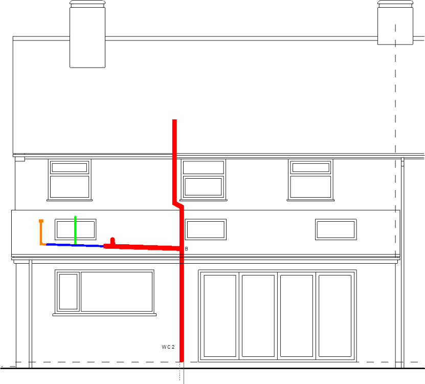

We have a ground floor extension underway, and I need to get the drainage from the existing upstairs bathroom sorted before the roof can go on.
We're adding a new W/C downstairs which has necessitated moving the soil stack over a few meters. (The underground drainage is already in place and signed off by building control with the upstairs W/C connected temporarily.)
Moving the soil stack leaves me with the problem that the bath waste is now more than 4m away. I understand the max run for 40mm waste is up to 3m, and 50mm is up to 4m.
This is what I have in mind.
Blue = 40mm bath waste
Green = 32mm basin waste
Red = 110mm
I was thinking it would be sensible to put rodding points in at A & B (with inspection covers internally).
I'm planning to use one of these (or similar) for the 40mm to 110mm connection.
Here's the house / extension in profile, so you can see that most of this pipework will be boxed in internally.
So you can see the full picture, this is the arrangement of the upstairs W/C, showing what it would look like if 40mm pipe was used for the full run.
The last diagram also shows the boiler condensate which I need to re-route into the bath waste. I plan to get this particular bit done by a Gas Safe registered plumber, but I'd still like to have a vague understanding of what needs to happen here so I can plan the other pipework accordingly - I'm not sure it's quite as simple as plumbing the condensate drain into a tee below the bath.
Does the arrangement look OK (ie., compliant with building regs), and does anyone have any clues on what needs to happen to plumb the condensate drain into the bath waste?
Thank you for any advice!

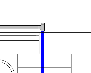

Sorry, I've just realised that isn't too clear.
This is what it would look like from inside the bathroom, so under 3m of 40mm from the bath. I'm just unsure about the transition into the 110mm, as I haven't seen it done this way before...
I suspect you'll get horrible gurgling in the bath and sink if there's no air admittance valve upstream of the basin.  Otherwise generally "better" to drop into the main sewer from the top rather than end (cap the end for rodding) - but you may not have enough fall available for that at the moment, and what you have in mind will work.

The pipe off the 110mm should be 50mm up to where it heads in to the bath, turning in on a T with a rodding access (cleaning eye) for maintenance.
From the 50mm T you reduce to 40mm to get to the bath T, and then the 40mm pipe continues to the boiler.
That then terminates at a 40mm T with the centre of the T having a 40 > 21.5mm reducer in it for the boiler condensate, and a 40mm air admittance valve to complete the run.
Absolutely ZERO need for a GSR plumber, this will just add wasted expense.

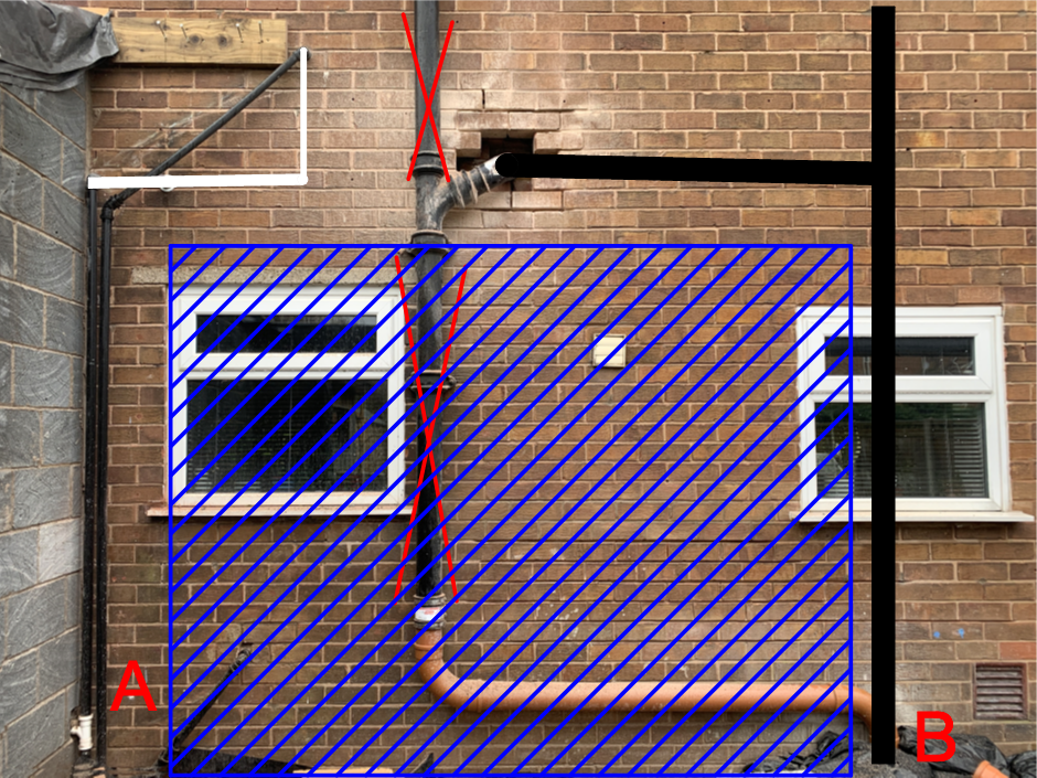

Right, I've made it to the outside and need to figure out the arrangement here...
Hopefully it's clear that the original / temporary stack is to be removed and the new stack is going over to the right.
Option A - I personally prefer this because it gives me a sharp drop immediately after the WC outlet - similar to the way it was installed originally which has always worked very well.
Its a bit lower, but still around 2.4m at the join to the new stack
Option B - seems more conventional, about 200mm higher.  Might end up having to use a strap boss for the 50mm pipe at the stack which I don't really like.
What's the preferred way to do this, and whereabouts are inspection / access covers recommended?

Option C - Previously the basin and bath went into a hopper where you can see the two temporary downpipes, these are currently just feeding into the old drain which is still there below the slab and working - ie., A & B join up underground anyway.  Reading the regs again, it does say that boiler condensate should be downstream of a sink (basin?), so maybe it's best to use this and box it in after all?  It would still be vented at the boiler end.

5 hours ago, Nickfromwales said:
What about opening the window?
Sorry, I should have made that clear.  We haven't broken through yet, but there will be a new internal opening, roughly as below - window will be bricked up when we get to that stage.
I could box the suggested pipework into that corner (A), but ideally I'd still run 50mm down the wall as far as possible to keep it tight.
I've learned this is known as a stub-stack?  They're only supposed to serve one storey if I'm understanding the regs correctly - which it would, being the upstairs bathroom (the white tee you can see going through the wall goes to the washing machine in the garage, but I could divert that off elsewhere to make building control happy).
This way the condensate waste is downstream of the basin so I don't need to run two pipes, and it isn't too cramped or long.
Not sure which way to go - this one seems the most straightforward for my plumbing skills, but feels like building control might raise an eyebrow?  Option A, someone commented if the toilet blocked it could back up to the basin?

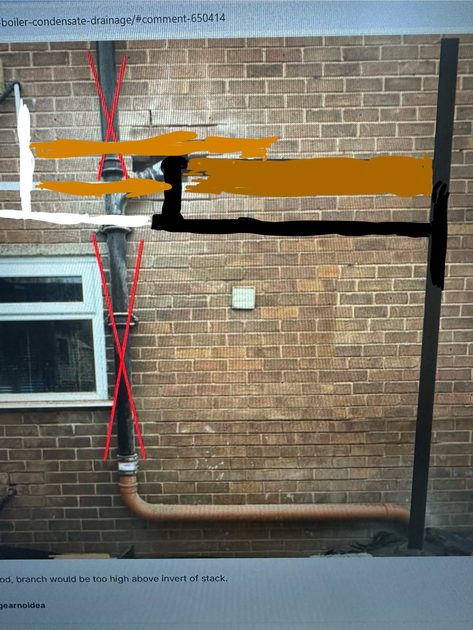

Final answer 🤣
32 > 40mm for the basin as it is more than 1.7m
Boiler / bath waste 40 > 50mm and downstream of the basin
Inspection bend at rear of WC
My 'stub stack' idea is no good, branch would be too high above invert of stack.

Where the new 110mm pipe travels horizontally to meet the new stack, just lower that so you can come out of the house, and drop down into a branch, and then the 50mm waste goes into the back of the branch. Saves the long 50mm waste run to the stack.
@Allthegearnoidea
Worlds shittest drawing, free-styling off my iPhone atm, but should explain what I mean.
Perfectly clear, thanks Nick 👍
Use a Y-branch (135 degree) and not a T ;) Put a 'single socket' 135 bend in the branch, and then go vertical to pick up the WC. That means when the goods in transit hit the branch they're already heading towards the stack, instead of dropping into a T with a "thud".

One of these in the open end of the branch, with the 50mm inlet at the bottom. Use a couple of 135 degree spigot (45's) in 50mm to jump into that.
https://skyplastics.co.uk/110mm-reducer-to-50mm-waste-pipe.html
I think this goes into the adaptor, but ring and check if you buy from here (good prices!).
https://skyplastics.co.uk/50x-63mm-solvent-boss-adaptor-black-olivw-grey.html
Then push the 50mm pipe in and job done.
