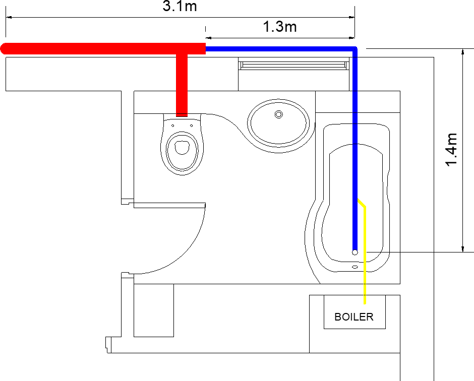

  12. Thank you Nick! Just to confirm - is this roughly correct? Red = 110mm Grey = 50mm Green = 32mm Blue = 40mm Yellow = 21.5mm On the other side of the wall, is this what you mean? One of the reasons I was going to get a plumber in for this was the mention of a trap in Approved Document H...is this necessary?

  15. Sorry, I've just realised that isn't too clear. This is what it would look like from inside the bathroom, so under 3m of 40mm from the bath. I'm just unsure about the transition into the 110mm, as I haven't seen it done this way before...

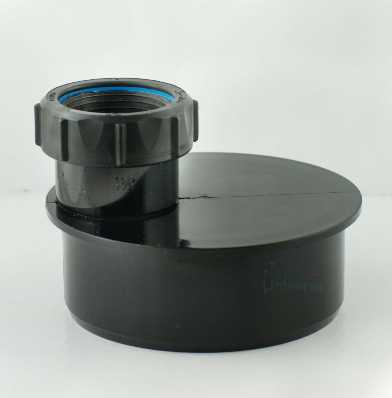

  16. Hello All! We have a ground floor extension underway, and I need to get the drainage from the existing upstairs bathroom sorted before the roof can go on. We're adding a new W/C downstairs which has necessitated moving the soil stack over a few meters. (The underground drainage is already in place and signed off by building control with the upstairs W/C connected temporarily.) Moving the soil stack leaves me with the problem that the bath waste is now more than 4m away. I understand the max run for 40mm waste is up to 3m, and 50mm is up to 4m. This is what I have in mind. Blue = 40mm bath waste Green = 32mm basin waste Red = 110mm I was thinking it would be sensible to put rodding points in at A & B (with inspection covers internally). I'm planning to use one of these (or similar) for the 40mm to 110mm connection. Here's the house / extension in profile, so you can see that most of this pipework will be boxed in internally. So you can see the full picture, this is the arrangement of the upstairs W/C, showing what it would look like if 40mm pipe was used for the full run. The last diagram also shows the boiler condensate which I need to re-route into the bath waste. I plan to get this particular bit done by a Gas Safe registered plumber, but I'd still like to have a vague understanding of what needs to happen here so I can plan the other pipework accordingly - I'm not sure it's quite as simple as plumbing the condensate drain into a tee below the bath. Does the arrangement look OK (ie., compliant with building regs), and does anyone have any clues on what needs to happen to plumb the condensate drain into the bath waste? Thank you for any advice!
