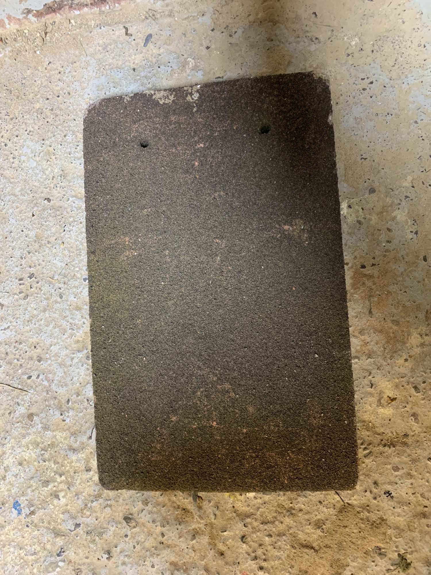

  1. Thanks Gus. Yes, there is felt under the tiles, and it's generally in good shape - we don't see any water in the loft anyway. I had a dry ridge installed not to long ago too. The single-storey extension we're building at the rear will make access a little more difficult, so I'm just trying to make sure it's in as good shape as possible while I can still access it relatively easy. And yes, due to the extension we are skint so I'm glad to hear it can probably last a few years longer! Some of the houses in our street are council owned and they had new tiles not too long ago so the council must have thought they were reaching the end of their life, or a contractor persuaded them to reach that conclusion anyway.

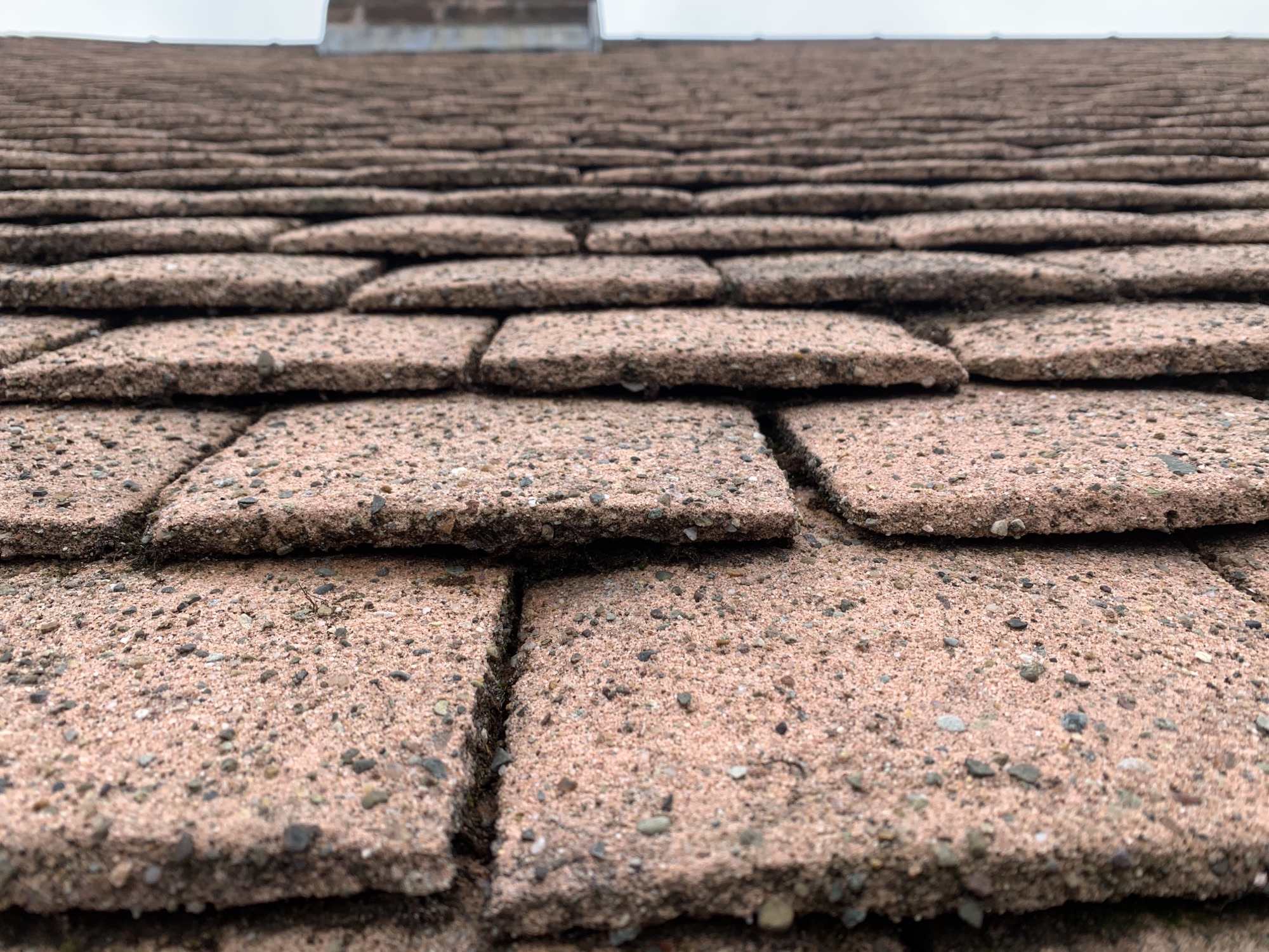

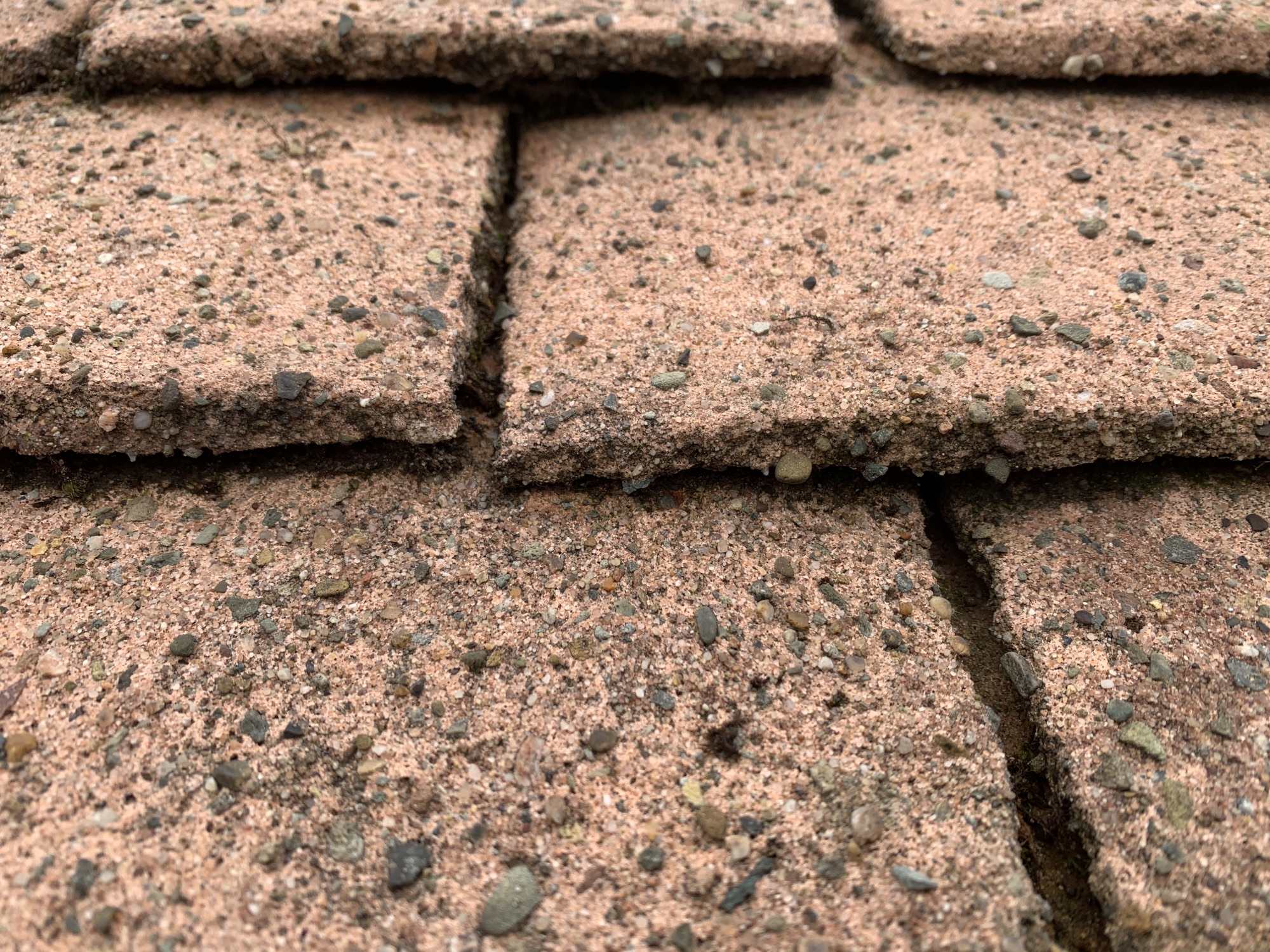

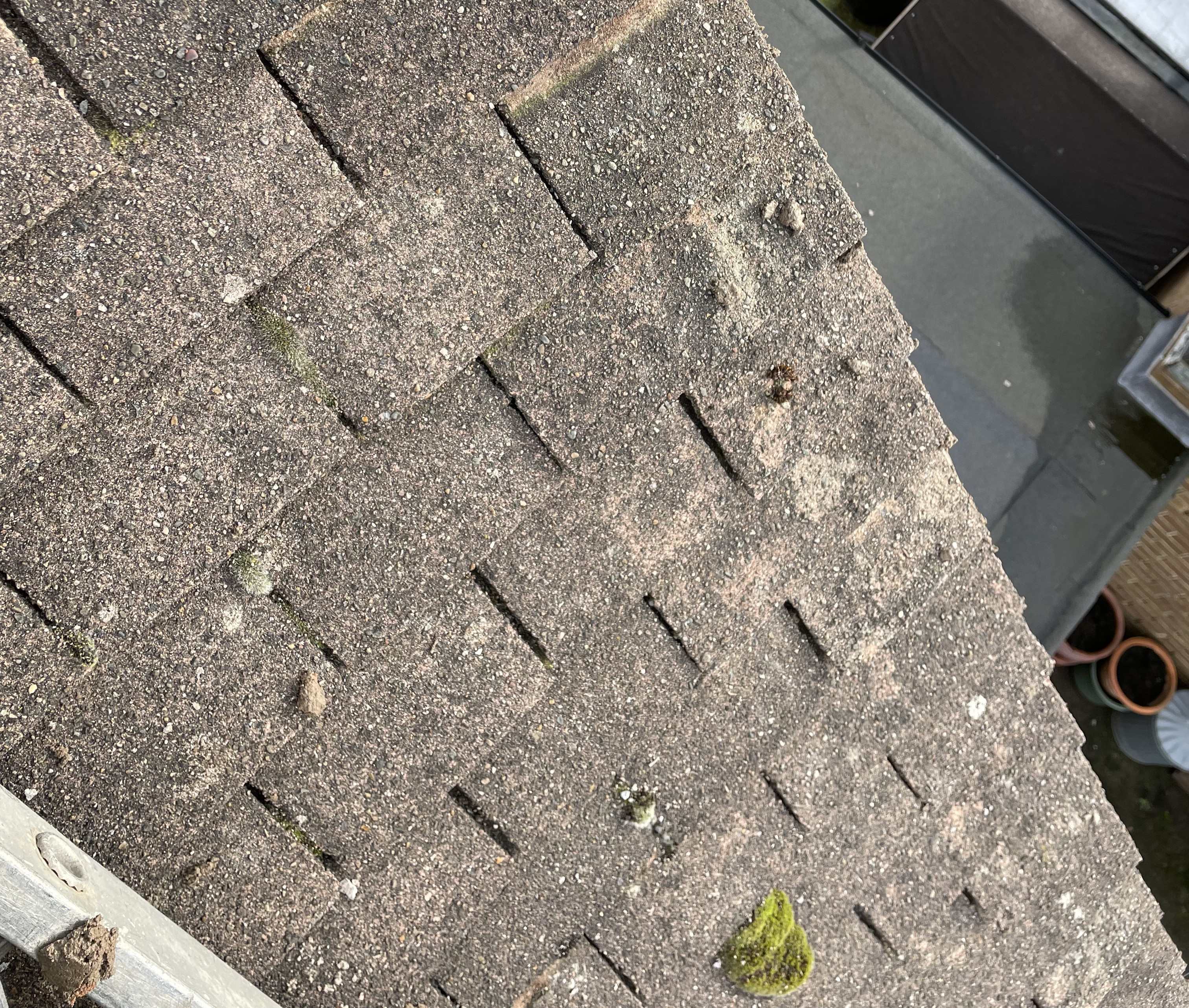

  2. I really debated having this done as I didn't want it to stand out like a sore thumb against other houses in the road, but several roofers recommended it even when they didn't offer the service themselves. Not sure whether this has caused a problem, exposed a problem, or I'm just worrying unnecessarily! It looks great from the ground, but up close the tiles look very eroded. These tiles would be approx. 70 years old! Before: After: An original tile (I think?) - it says Marley Eternit on the rear. The surface texture seems very different, so perhaps this isn't the original tile after all - or perhaps it's been eroded over the years? I would be grateful for any experience! Thank you

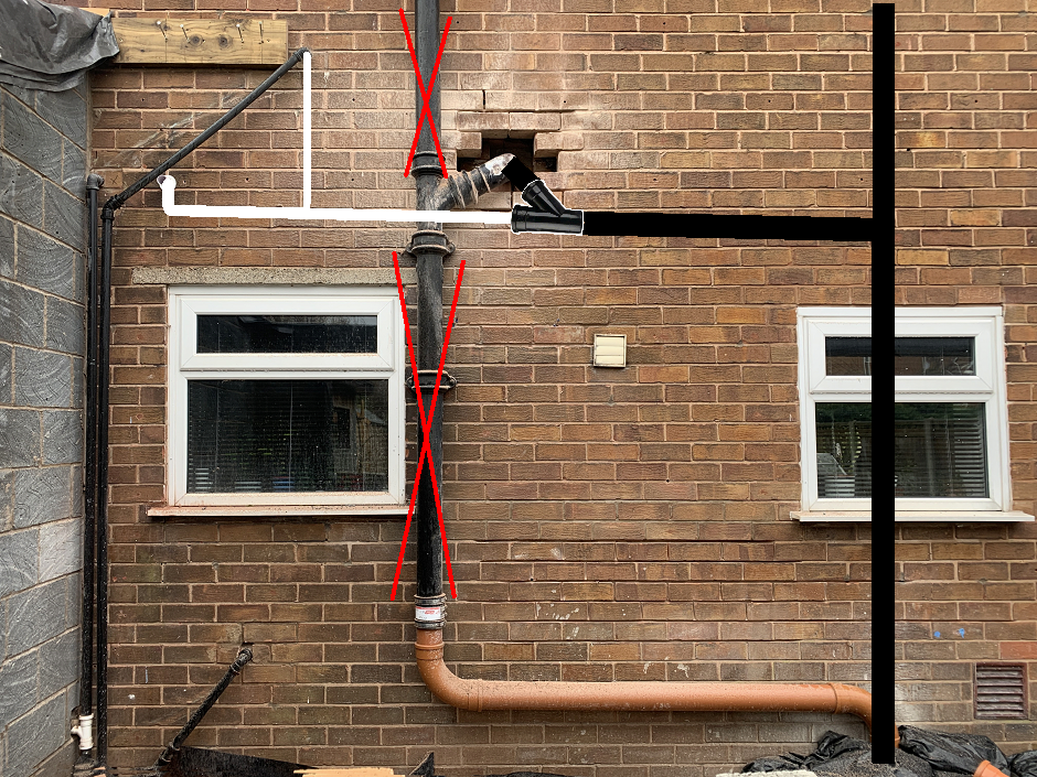

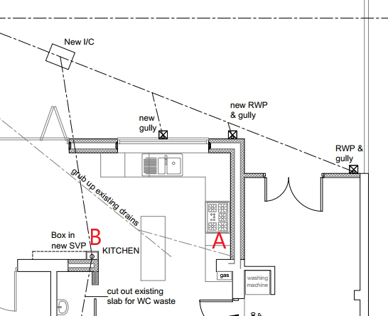

  4. Sorry, I should have made that clear. We haven't broken through yet, but there will be a new internal opening, roughly as below - window will be bricked up when we get to that stage. I could box the suggested pipework into that corner (A), but ideally I'd still run 50mm down the wall as far as possible to keep it tight. I've learned this is known as a stub-stack? They're only supposed to serve one storey if I'm understanding the regs correctly - which it would, being the upstairs bathroom (the white tee you can see going through the wall goes to the washing machine in the garage, but I could divert that off elsewhere to make building control happy). This way the condensate waste is downstream of the basin so I don't need to run two pipes, and it isn't too cramped or long. Not sure which way to go - this one seems the most straightforward for my plumbing skills, but feels like building control might raise an eyebrow? Option A, someone commented if the toilet blocked it could back up to the basin? Raining on it all day today anyway, luckily I'm not too worried about a bit of water getting into the cavity where I've knocked through behind the loo since I'm knocking that wall out anyway, but I've covered it over anyway to make myself feel better 😁

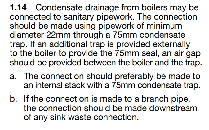

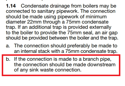

  5. Option C - Previously the basin and bath went into a hopper where you can see the two temporary downpipes, these are currently just feeding into the old drain which is still there below the slab and working - ie., A & B join up underground anyway. Reading the regs again, it does say that boiler condensate should be downstream of a sink (basin?), so maybe it's best to use this and box it in after all? It would still be vented at the boiler end.

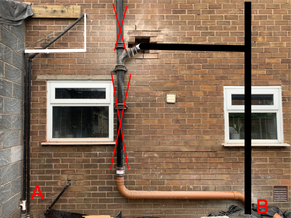

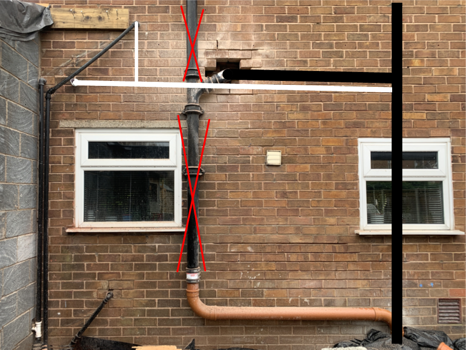

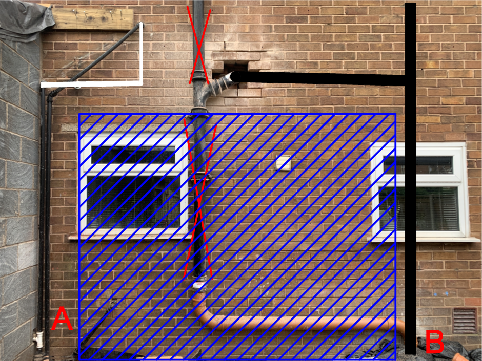

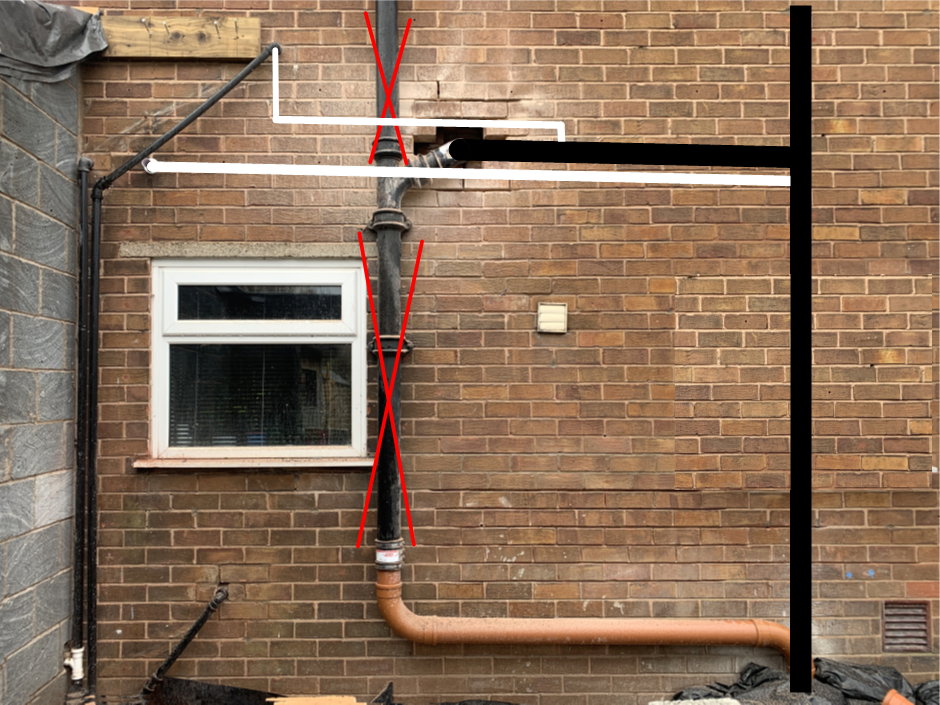

  6. Right, I've made it to the outside and need to figure out the arrangement here... Hopefully it's clear that the original / temporary stack is to be removed and the new stack is going over to the right. Option A - I personally prefer this because it gives me a sharp drop immediately after the WC outlet - similar to the way it was installed originally which has always worked very well. Its a bit lower, but still around 2.4m at the join to the new stack Option B - seems more conventional, about 200mm higher. Might end up having to use a strap boss for the 50mm pipe at the stack which I don't really like. What's the preferred way to do this, and whereabouts are inspection / access covers recommended? Pipework all to be boxed internally:

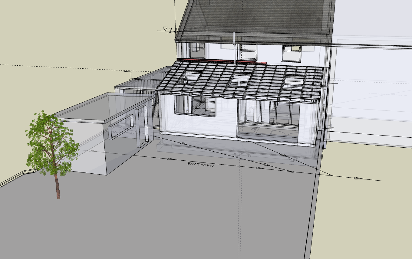

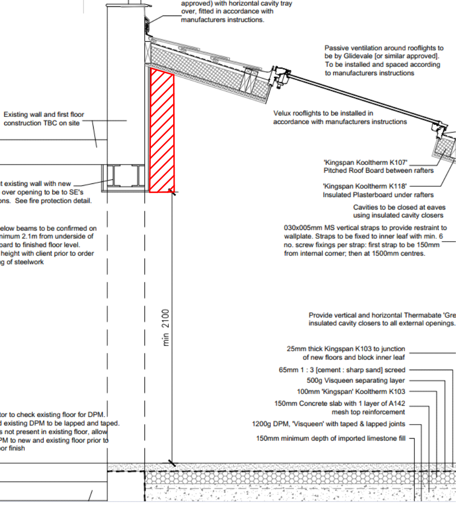

  9. Well, in hindsight and all that... If I'd known getting this part right would have been such an issue I might have done things differently. BC have signed off the drawings now and the walls are up, so pitched roof it is. I love EPDM, I've used it quite a bit before - but when it comes to the details such as sealing round rooflights, I can see that getting very fiddly. Once the roof is framed I think I'll be enlisting a roofer for the tiles.
  10. Hi, Yes, we have building control drawings all approved, they did show the WC connection but the groundworks guys missed it - I was in Scotland at the time doing my day job. Bit of a pain but they are a good bunch and are fine to come back and sort it. The roof design on the drawings is a bit vague and subject to structural calculations. Happily we have a retired SE in the family and he is working with me on this. I'm using Redline Mockbond tiles which will go down to 17.5deg which is really tight to the windows - plus, due to the design of the roof (no internal ceiling) it needs a skin of plywood to stiffen it which means double battening, bringing the height up again. I think I'm going to get away with it by shaving the lower battens and having a larger than usual birdsmouth with a bit of reinforcement...approval (from SE) pending.

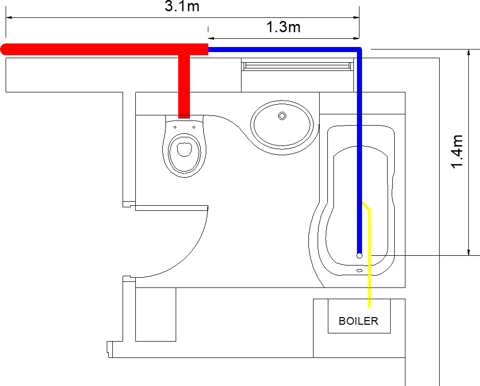

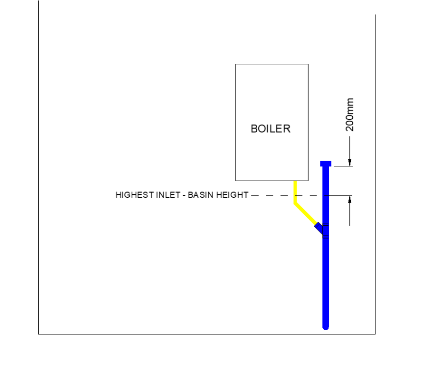

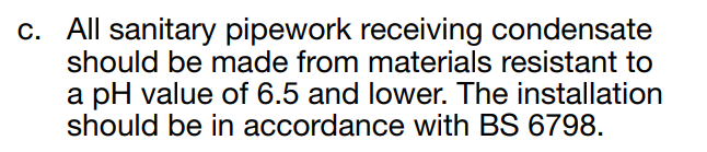

  12. Thank you Nick! Just to confirm - is this roughly correct? Red = 110mm Grey = 50mm Green = 32mm Blue = 40mm Yellow = 21.5mm On the other side of the wall, is this what you mean? One of the reasons I was going to get a plumber in for this was the mention of a trap in Approved Document H...is this necessary?
  13. Or I could try to get an AAV in here (in orange)...but it would be tough to get it above the basin trap height.

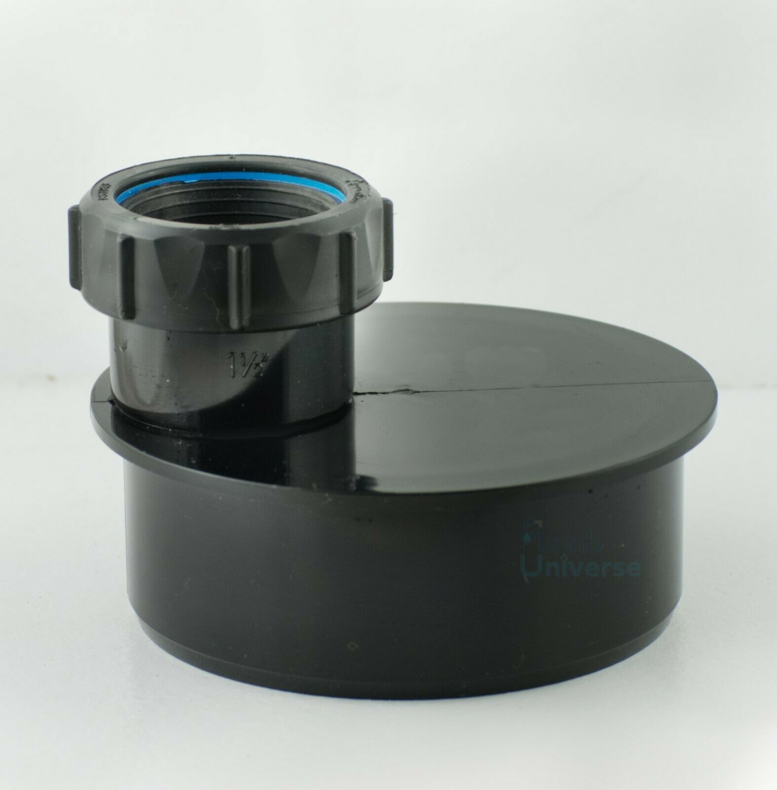

  14. Would one of these fitted to the basin help? Or do you think I would still have the same problem with the bath?
