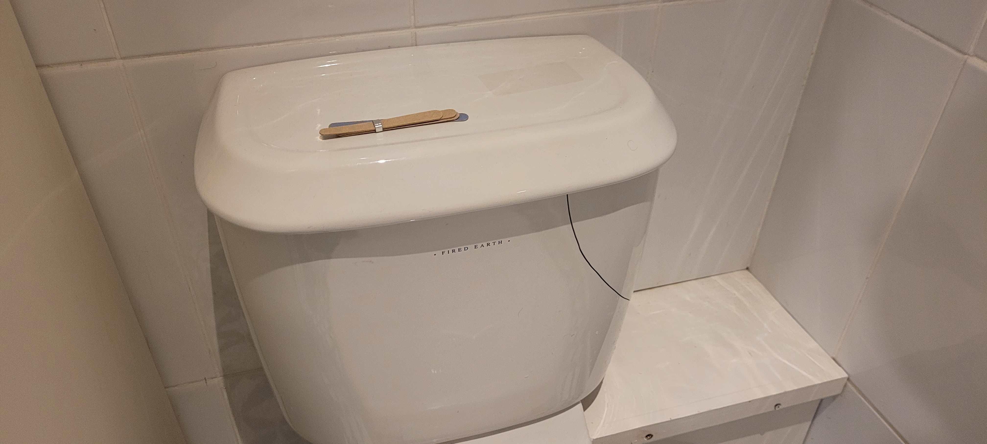

MikeSharp01 Posted January 24 Author Posted January 24 7 minutes ago, Nickfromwales said: You’re driving me to drink Mike… Yes sorry name mix up. To much happening in my world. After 20 years of trouble free service a cistern in one of our bathrooms just cracked without provocation, not been used since Christmas, drowned the router in the stairwell below, left us with no Internet and water everywhere. Sadly its a Fired Earth unit so no guarantee possible- still as I say it has done 20 years. 1
Nickfromwales Posted January 24 Posted January 24 That’s a piss-you-off!! CT1 will get that watertight temporary, if you need to keep using it. Just need to dry it out with a hairdryer and clean it before applying.
MikeSharp01 Posted January 25 Author Posted January 25 15 hours ago, Nickfromwales said: CT1 will get that watertight temporary, if you need to keep using it. Just need to dry it out with a hairdryer and clean it before applying. No we decided to get a new one, well two new ones, which I fitted yesterday. Yuk job. 1
