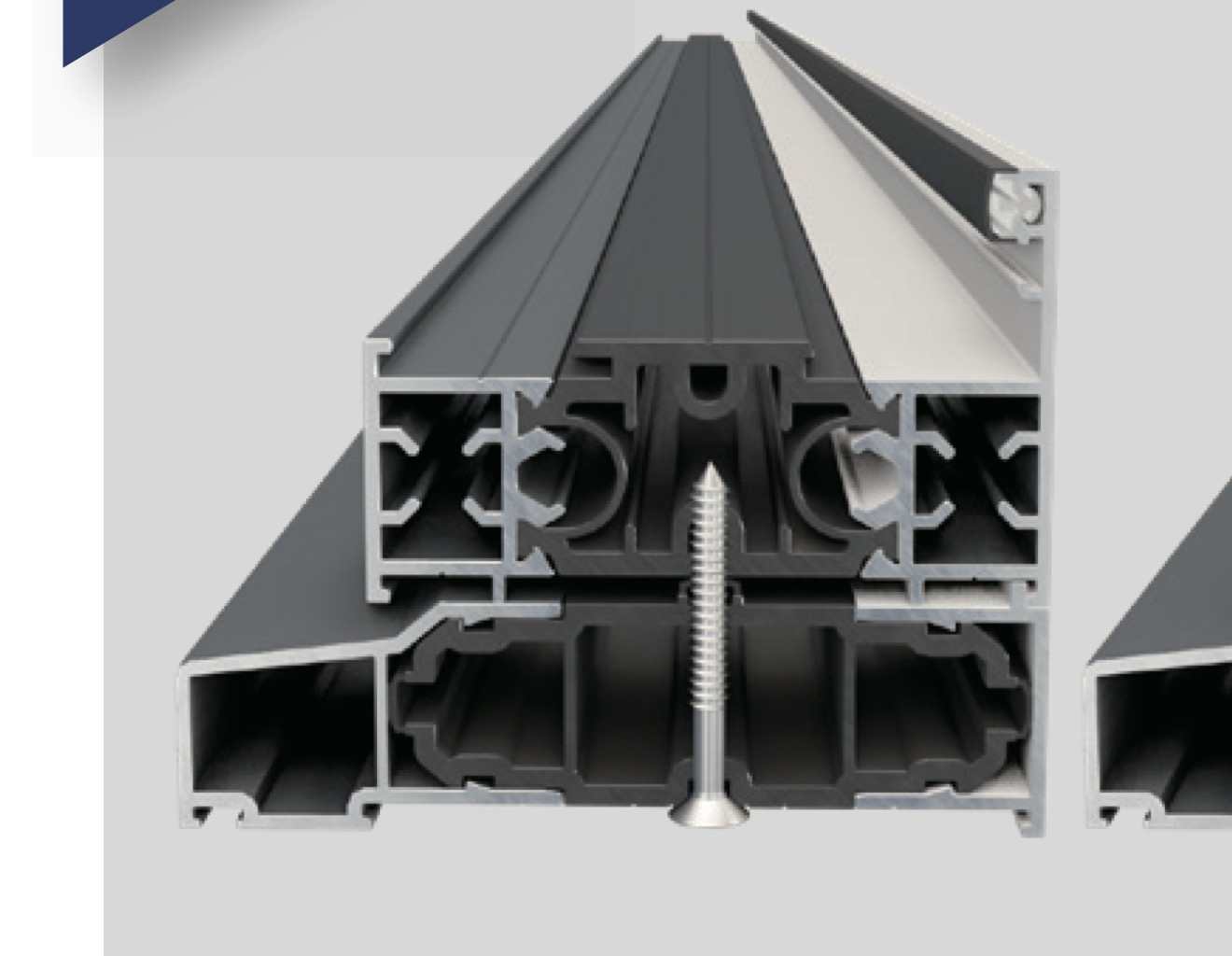

The windows are Prestige Sheerline. The cills overhang the cladding well and underneath is dry but the wind has blown hard pushing water into the lower right hand corner. I think my cladding reveal had been too tight to the cill and trapped water as seems quite waterlogged but… around the window I used compriband expandable tape and Tescon vana so should be well sealed. I’m a bit stumped how the water has got in but one possibility is through the end caps of the cill… (edit: on second look I don’t think that’s possible as the cill ends extend beyond the opening.)

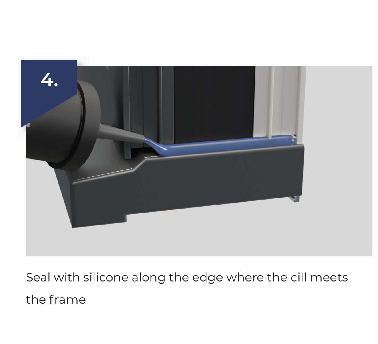

 one other possibility is that the water is being blown into the drainage area and sloping to the ends… according to prestige this should be sealed with silicone (see attached) and I can see some silicone but there’s no way of telling if it’s failed. I’ve added some manufactures pics but thinking it’s likely to be something I’ve done rather than manufactured but there was a lot of debris blown and washed into the end if the drainage area highlighted on one of the drawings so a lot of water has been pushed this way.

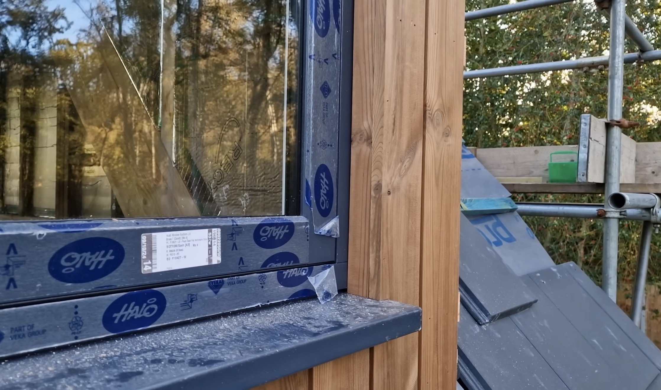

 The attached image is from ‘clevett’ video (not mine) but similar to my finished result.

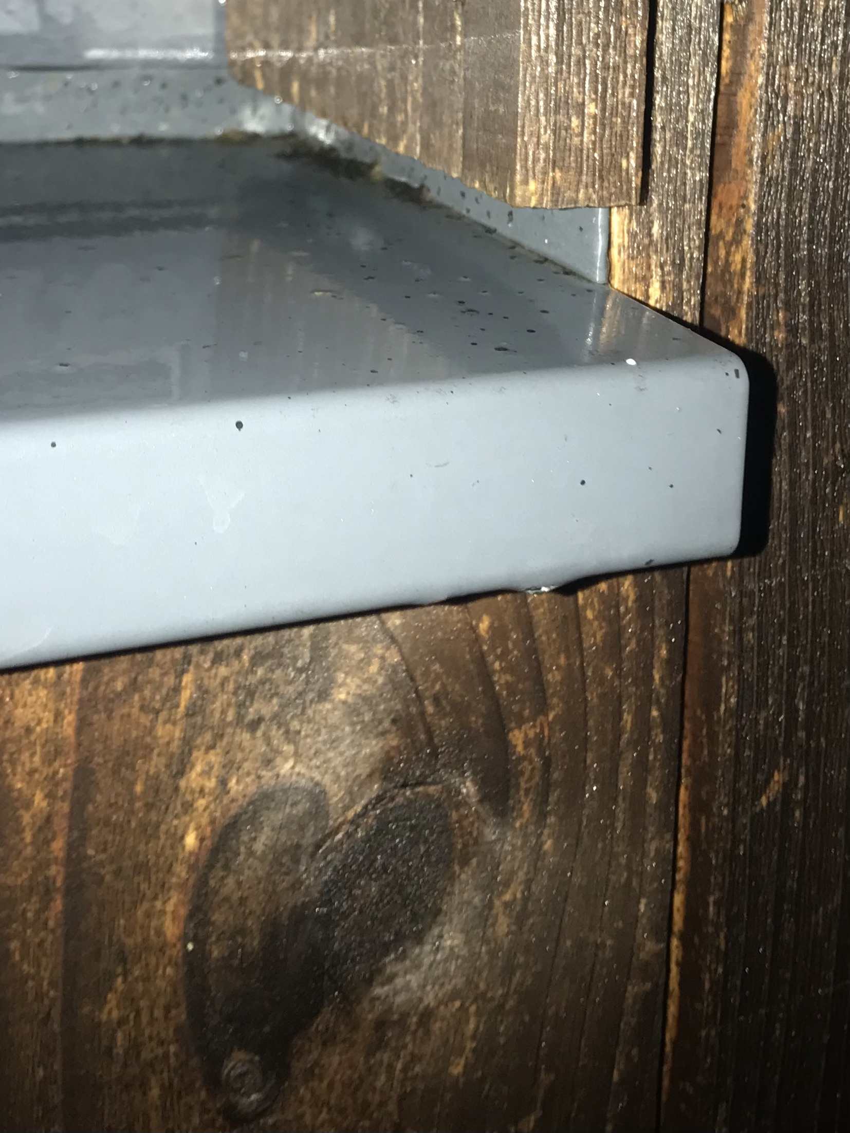

Is the cill part of the actual window frame?
My cills were separate to the window with 10mm upstands at the back and sides. Slotted into a grove within the bottom of the window frame.
The cedar cladding reveal then butted up next to the upstand at the sides with a small gap to allow water to escape.
Photo enclosed, it's bucketing down at the moment.

That looks neat. The cill and frame were fitted together but manufacture details show it as 2 parts. (See attached technical drawings) There’s no upstand though… that’s looks neat but not something on mine.

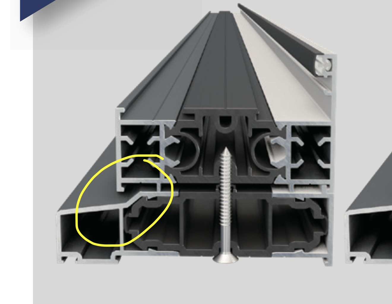

Thank you that’s helpful. Are you pointing to the groove in the window frame? One theory I have is that it’s getting in through the joint between frame and cill as circles in attached. Adding sealant where you suggest could be a solution.
My windows are constructed differently, but I think where you have circled the area in yellow, is probably the same.
