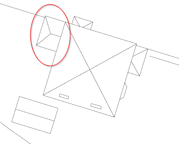

We would like to build a two-storey rear extension under our permitted development rights. However, I am concerned by an existing (presumed original) portion that juts-out at the back of our house.

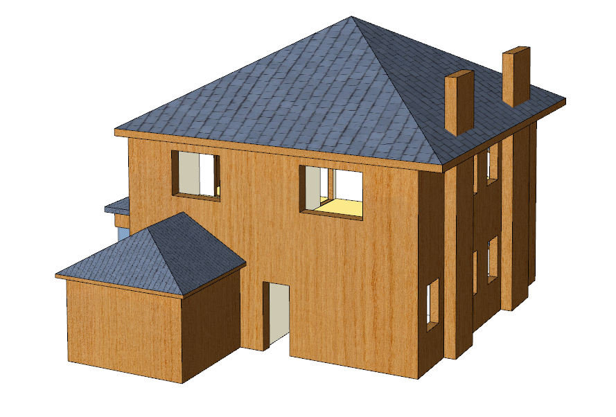

The above image shows the original property looking at the rear elevation.

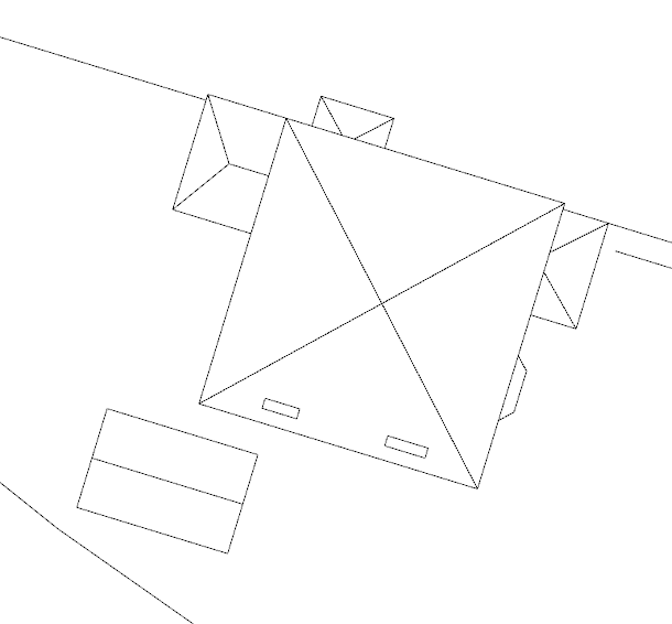

The plan is shown above. The rear elevation is on the left. (The smaller building in the lower left corner is a wooden shed built around 1970)

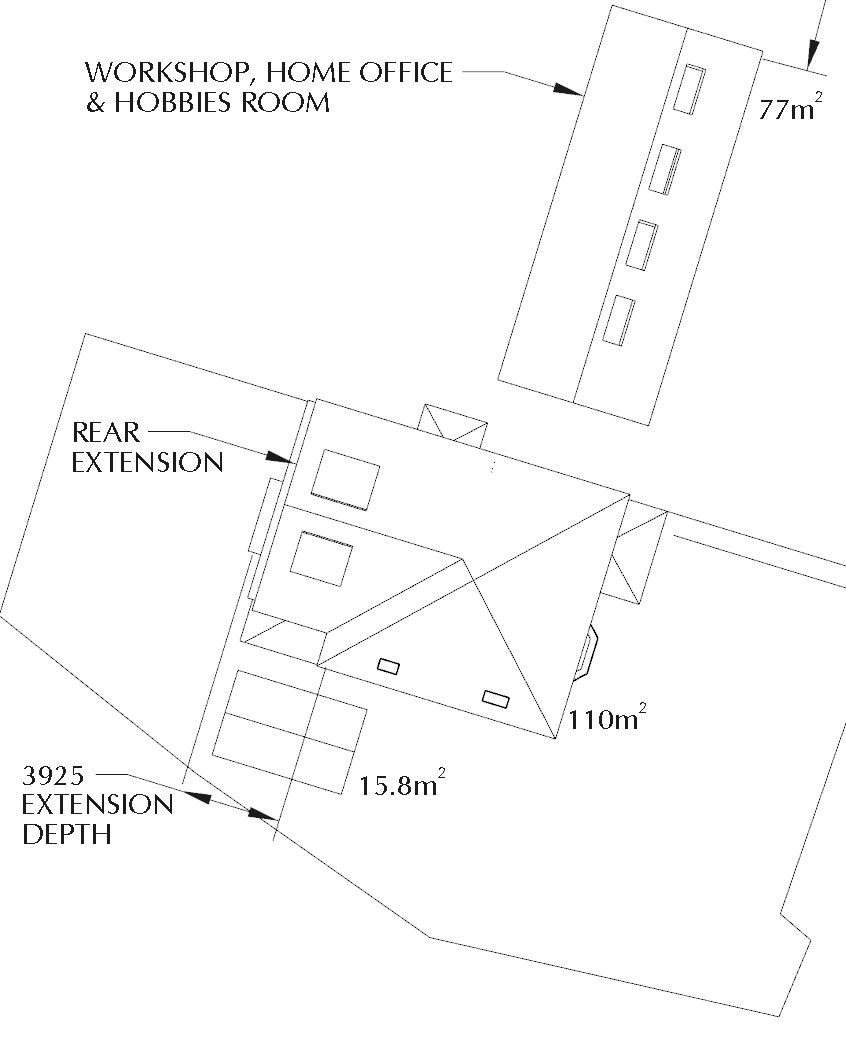

This is what I would like to do.
And the proposed plan. (The new outbuilding is single storey.)
We are within the curtilage and boundary distance requirements. However, my concern is that the small protrusion at the back of the original house (WC and pantry outlined in red) means that the proposed extension to the main house would have to meet both rear and side extension requirements when considering permitted development rights, [Permitted development rights for householders, pg 23].
This means my proposed extension is too wide. (5.1m allowable half-width, 5.4m extension width). More importantly, side extensions can only be single storey under permitted development.  I can see that this is not the first time that this problem has been discussed and I have a few questions:
1. Does this particular arrangement mean that I am missing something and that I can actually build as proposed under PD rights?
2. Are there any small changes that I can make that mean I can build under PD rights?
3. I presume the offending lump on the back is original, but I don't actually know. Could I argue that it might have been an extension?

Whatever has been added to the very original house is another bite out of your PD.
Why aren’t you just simplifying this by going for a full planning application? If they refuse at least you’ll know why and what’s not ‘acceptable’, but nothing stands out as offensive or domineering so I doubt you’ll have issues; unless the planning officer was bullied at school.

This is definitely not permitted development, not just for the reasons you've mentioned but because you're changing a relatively low profile hipped roof at the rear into a much more prominent gable end.

Why build and restrict yourself to 3 metres depth with PD?
Need to go full plans.
Go full plans, at present the rear extension is greater than 3.0m deep and more than one storey as well as being a side extension to the existing rear single storey part and is more than half the width of the original house. I'd rather not risk building that without a certificate of lawfulness to confirm it's PD and if you're doing that (and I think you would fail) you might as well go for full planning.
