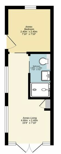

Hi All,
Thanks for the comments
The system works in a basic fashion, but having done some research into UFH I'm confused as to how to set it up to run most effciently (heating and cost). I can get each zone to call for heat.
Zone 1, bedroom (6m2), Zone 2 batchroom (3m2), Zone 3 (9m2, (12m2-3m2))
Currently it take arounf 12 hours to heat the space from 15C to 20C and the things i'm concered about are;
Pump flow is set to max, none of the zone are balanced and all run at over 5l/m if they get activated alone and 3l/m if all zone call for heat at the same time.
I know how to set the flow by turning the flow meters but dont know what flow to set them, or what setting to have the pump on speed and contnast or PV or PC?
The return temprature is only a couple of degrees lower than the outlet tempature.
What does the red dial do, I have no idea nad can seem to find a refernce so am leaving it along?
Which is the correct wiring for the thermostat? they are hardwired back to the Heamister UH4
Does it run from it's own boiler?  or does it share the output of the house boiler?
UFH does take a long time to heat up.  It is best run to be on most of the day, some run it all the time.
To set the flow rates can be a long process, run it for a long time with all the room thermostats turned up high, the rooms that get too hot, turn their flow rate down, the rooms that are cold, turn their flow rates up. You are aiming to get all rooms to heat up at the same time.
r/DIYUK - UFH Pump and Flow setting help!
The red knob at the bottom is an automatic bypass valve, you don't need to do anything with that.
The black knob below the pump is the mixing valve and sets the water temperature in the UFH loops  The little guage top left of the manifold is showing the water temperature, looks to be about 40 degrees, I would not go any higher.
Would suggest running the pump in CP (constant pressure) mode (second pictogram down) on setting II which at ~ 4.2M head should be ample for your flowrate requirements, suggest setting the flowmeters to 2/2.5LPM, if you have temperature gauges on the manifolds note the readings and compare them with the present readings.
