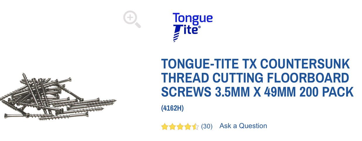

Nestor Posted December 5, 2025 Posted December 5, 2025 I used 1000's of these from Screwfix to fix Cedar and Douglas Fir Cladding. Worked well, good value, a little delicate if you want to keep removing them. Need to be square on. Described as stainless steel construction.
ectoplasmosis Posted December 6, 2025 Posted December 6, 2025 14 hours ago, Nestor said: I used 1000's of these from Screwfix to fix Cedar and Douglas Fir Cladding. Worked well, good value, a little delicate if you want to keep removing them. Need to be square on. Described as stainless steel construction. These are great, I used them to fix the T&G plywood flooring in my loft. Tiny heads which become almost invisible, and easily removable should you require.

marmic Posted December 7, 2025 Author Posted December 7, 2025 I looked at these but only A2, they also offer A4 with a slighty different [deck version] - but decided the square/robertson drive not for me with more chance of camming out - albeit will probably 'stick on the bit better' and perhaps look a little nicer 1
Nestor Posted December 7, 2025 Posted December 7, 2025 16 minutes ago, marmic said: I looked at these but only A2, they also offer A4 with a slighty different [deck version] I am still learning, the molybdenum is the difference.
JohnMo Posted December 7, 2025 Posted December 7, 2025 22 minutes ago, Nestor said: I am still learning, the molybdenum is the difference. It's a bit more than that, physically they have different yield and tensile strength and different corrosion resistance. A4 being better than A2.
