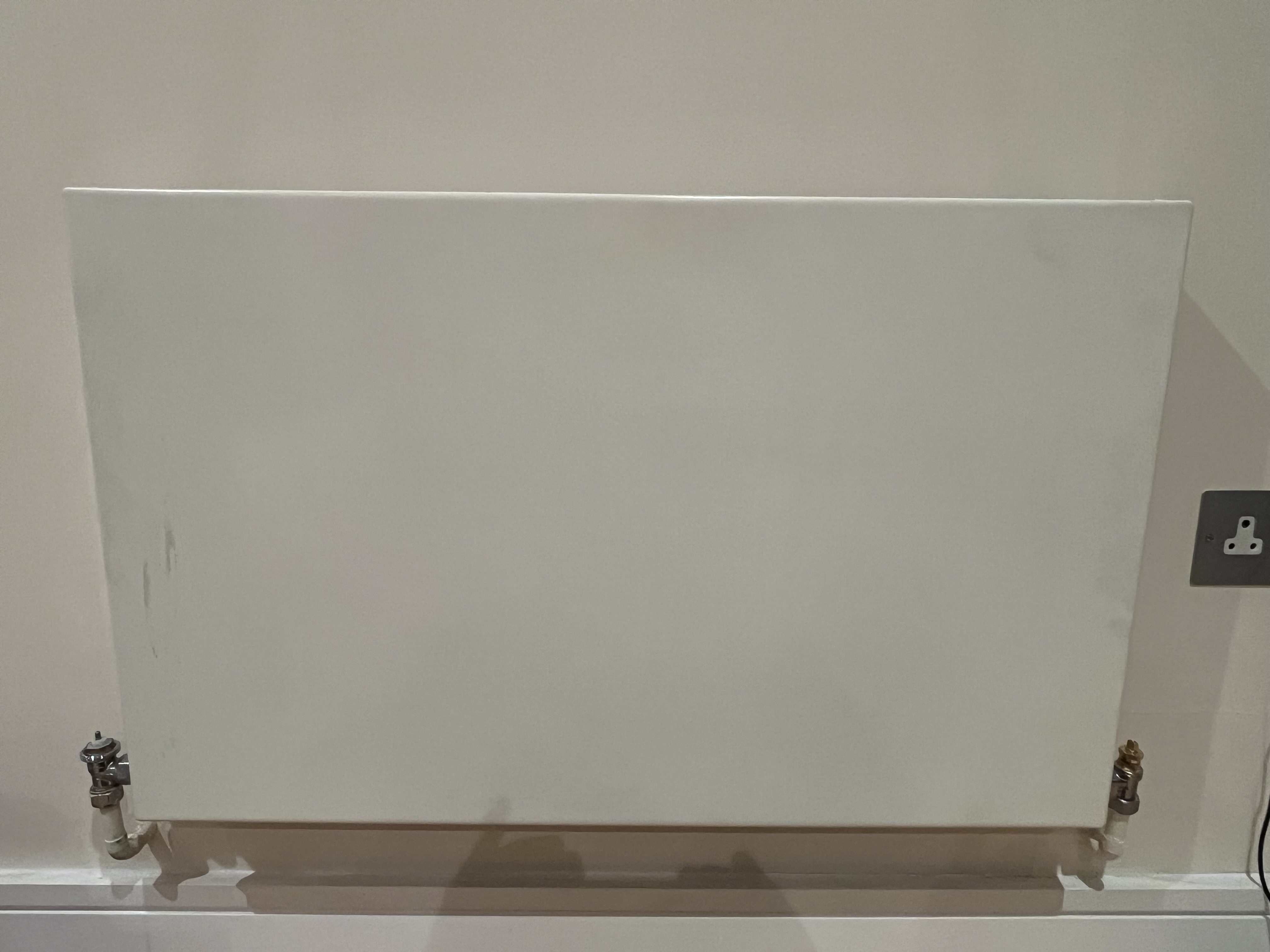

December 1, 2025Dec 1 How are you measuring your rad flow and return temps? Have you a picture of the rads (as an example) - even my old 1980's single panel, single convector rads at 60 deg C with the old boiler had a half decent temp drop Are they piped up BBOE or TBOE?
December 1, 2025Dec 1 Author 49 minutes ago, marshian said: How are you measuring your rad flow and return temps? Measuring the pipes before the valves. I started with a thermal probe (admittedly designed for meat). Wasn't convinced I was getting accurate temps (I think I could do but it was frustrating and fiddly). So I bought a IR thermometer. After a bit of learning how to get good results from it (keep distance short, make sure sensor is in line with what you want to measure, black tape over exposed copper, etc) I think I'm getting good readings. They are broadly similar to those with the meat probes (good thing about them is they could measure both at same time). I am also reading the boiler flow/return temps via Opentherm using the Home Assistant Wiser integration, though these temps are not quite the same as those measured with the probes, the deltas are similar. 49 minutes ago, marshian said: Have you a picture of the rads (as an example) - even my old 1980's single panel, single convector rads at 60 deg C with the old boiler had a half decent temp drop 49 minutes ago, marshian said: Are they piped up BBOE or TBOE? All BBOE Edited December 1, 2025Dec 1 by -rick-
December 1, 2025Dec 1 9 minutes ago, -rick- said: Measuring the pipes before the valves. I started with a thermal probe (admittedly designed for meat). Wasn't convinced I was getting accurate temps (I think I could do but it was frustrating and fiddly). So I bought a IR thermometer. After a bit of learning how to get good results from it (keep distance short, make sure sensor is in line with what you want to measure, black tape over exposed copper, etc) I think I'm getting good readings. They are broadly similar to those with the meat probes (good thing about them is they could measure both at same time). I am also reading the boiler flow/return temps via Opentherm using the Home Assistant Wiser integration, though these temps are not quite the same as those measured with the probes, the deltas are similar. All BBOE Whats the delta like if you measure top left corner and bottom right corner of that rad?

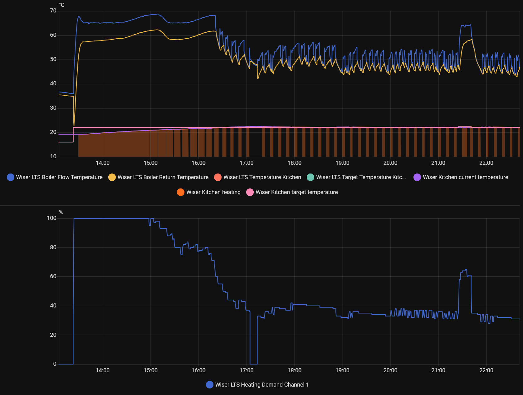

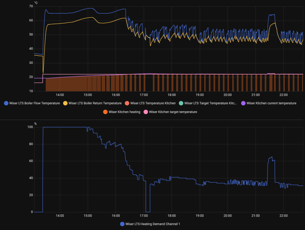

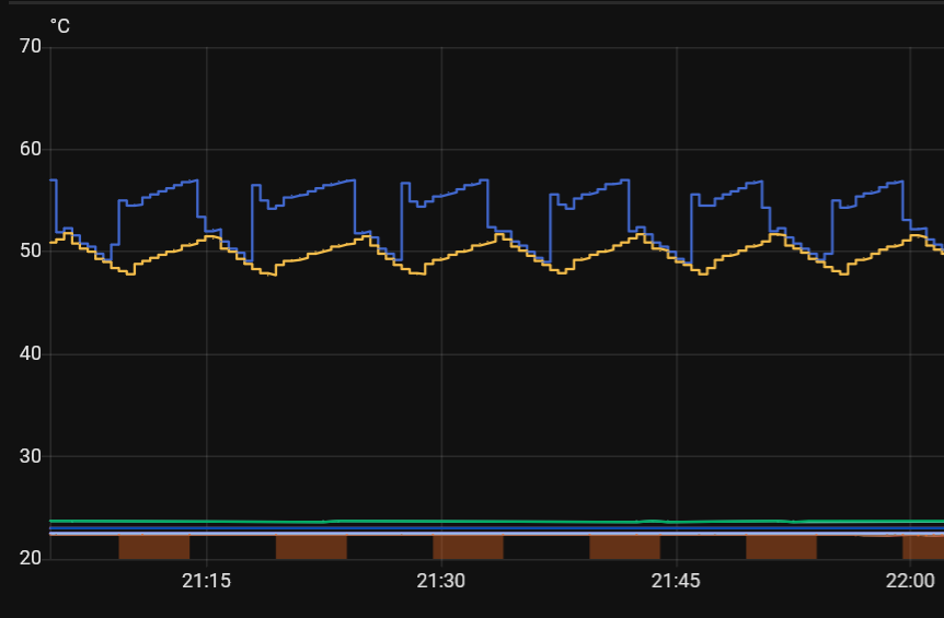

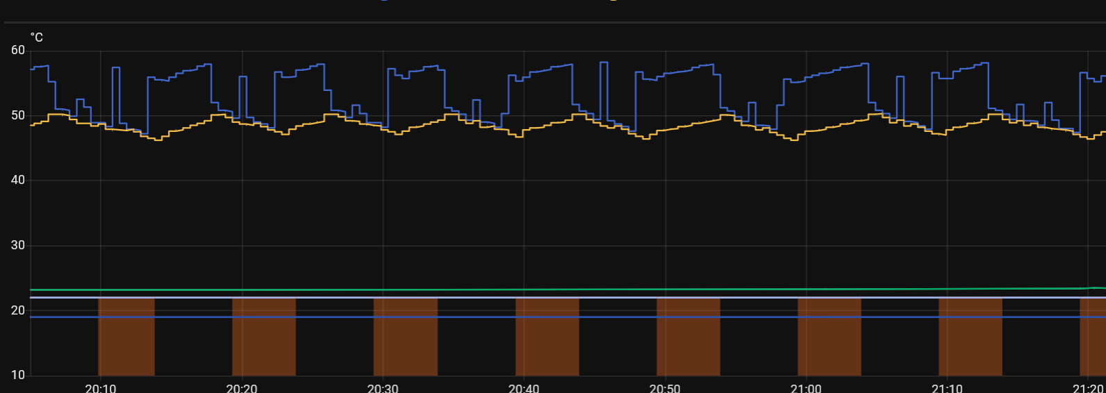

December 1, 2025Dec 1 Author Since yesterday, I've opened up various valves, the two most distant radiators fully open, and opened the towel rails a bit. The system manages very long burns if allowed a higher temperature and it's not close to set point, but as it gets close to set point it drops the temperature and cycles more. By staring at the Home Assistant graphs, I'm still seeing some very short cycles but a lot of them I can connect to Wiser demand changing mid flow (which seems like a bad design from them). BTW I do have it set up as Oil boiler, which should limit things to 3 cycles per hour, but obviously getting a lot more than that.
December 1, 2025Dec 1 Author Quote Whats the delta like if you measure top left corner and bottom right corner of that rad? 3C (seems to track the difference measuring at the pipes closely) I did have it at 8 or so yesterday with the lockshield about a quarter turn open Edited December 1, 2025Dec 1 by -rick-
December 1, 2025Dec 1 7 minutes ago, -rick- said: I'm still seeing some very short cycles but a lot of them I can connect to Wiser demand changing mid flow (which seems like a bad design from them). BTW I do have it set up as Oil boiler, which should limit things to 3 cycles per hour, but obviously getting a lot more than that. Assuming here you have Wiser Hub and One room stat (no smart TRV's) Watch the hub - if the CH light goes out it's killing the boiler because it's trying to stop temperature overshoot I agree this is an annoying characteristic If the CH light is not going out then it's not interveening My solution to the issue was to set the room stat or a smart TRV to a higher target temp that cannot be achieved - that way the Wiser Hub doesn't get to screw around making the boiler cycle or stopping it mid burn (which is what it did with my old boiler when I had it set up with a really long anticycle timer to give the rads chance to dump the heat)
