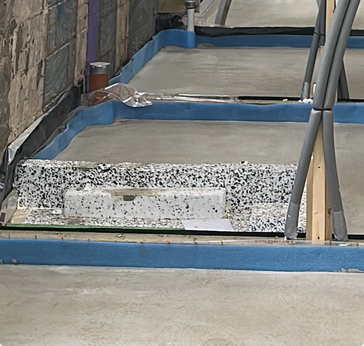

My ‘trick’ is to use 150mm concrete screws to set into the main screed as catchers / rebar pins, so the infill of SLC / tile adhesive can bind to those. Zoom in and you’ll see these pushed half way into the EPS blocks I made as shuttering. You need to have these low enough not to interfere with the tray when set into the void.
The blue expansion skirting wasn’t necessary around this, but the 3rd party UFH company did it anyways…. :S

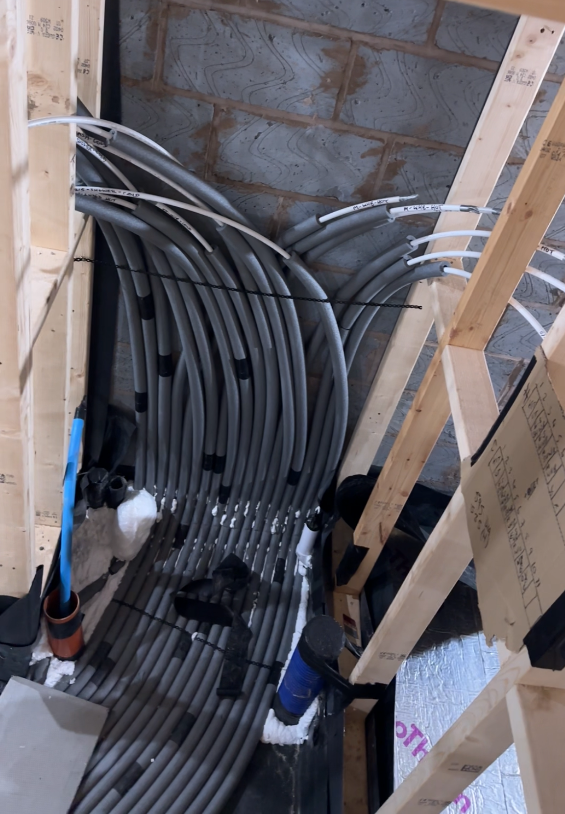

Down at the end is a buried 50mm waste pipe for me to jump on later, which all went in as 1st fix with hot / cold / waste plumbing all got installed / hidden below the insulation. I’ve set the waste pipe low enough to allow for the tray to be slightly recessed eg lower than the surrounding screed to reduce the step / lip left after tiling, however the clients have chosen very low profile pre-finished trays so probably only dropping those by 5mm or so to leave 10mm of shower tray showing above the tiled floor.
All hot and cold feeds went in on a radial setup.

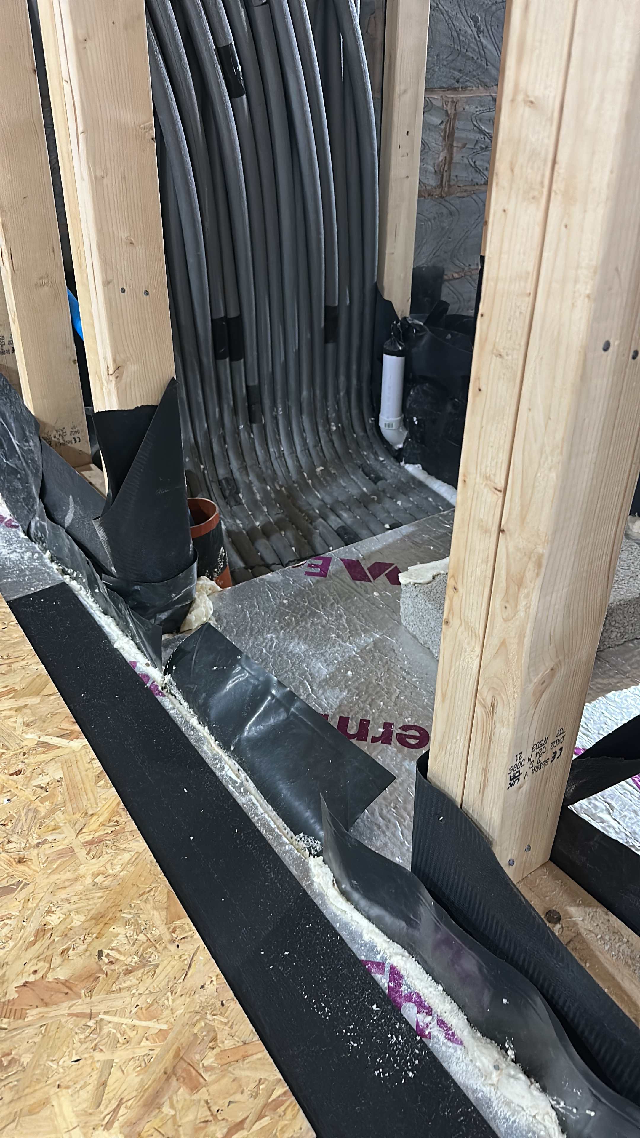

Another 100mm of PIR got put down there after I sorted out DPM etc around the pita pipes / other obstacles in the plant cupboard.
If you’ve still got an opportunity to get the 1st fix in the ground floor like this then it’s something to consider, as it makes 1st fix much easier imho, but more relevant here as it is a bungalow with vaulted ceilings / no attic void for services.

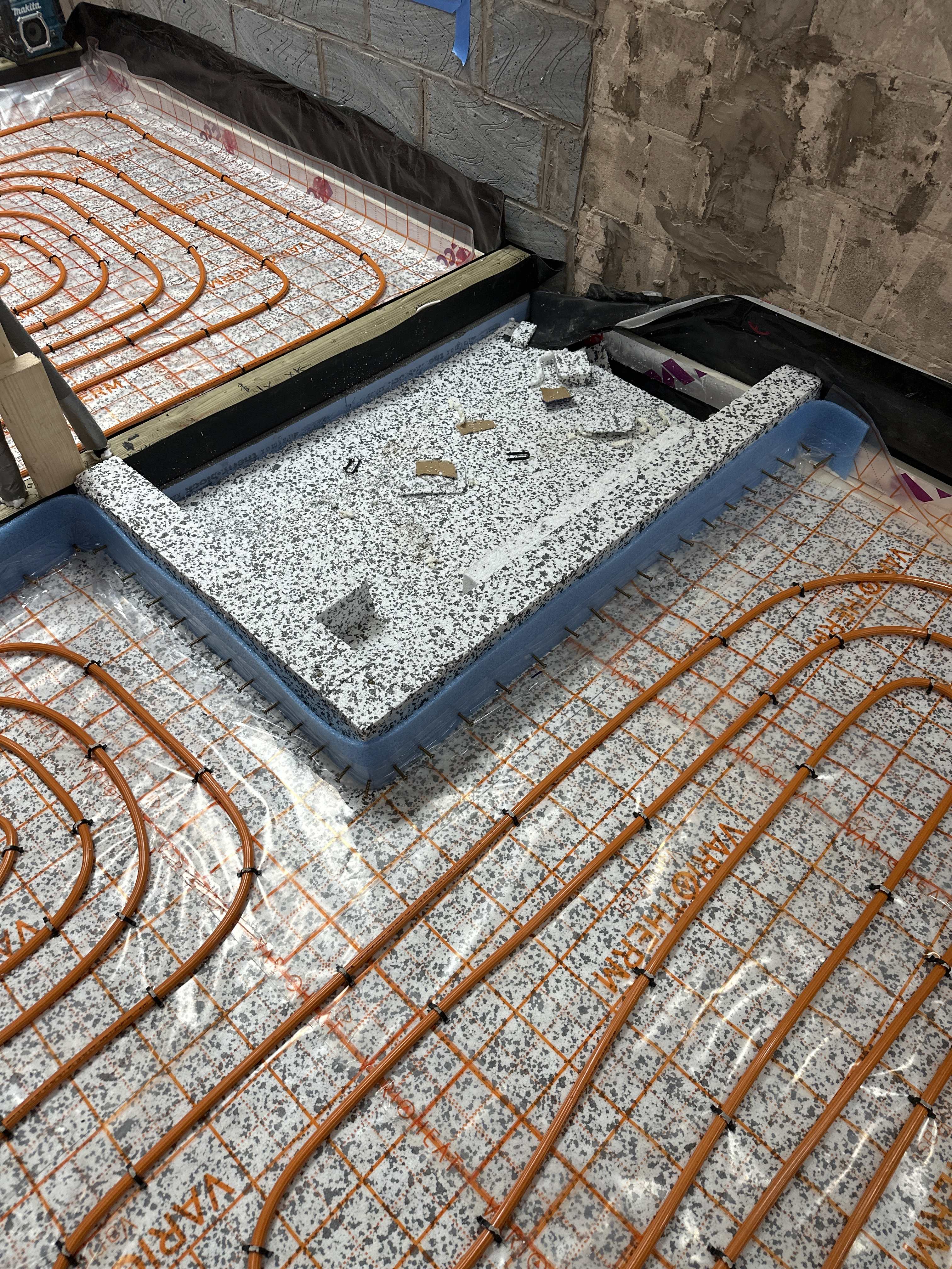

Shuttering worked perfectly for the screed pour (liquid cement)
Shuttering now removed and all walls gone up. Getting boarded atm ready for my very good plasterer mate to come and do his thing.

Are the concrete screws those black ones horizontally through the blue expansion skirt?

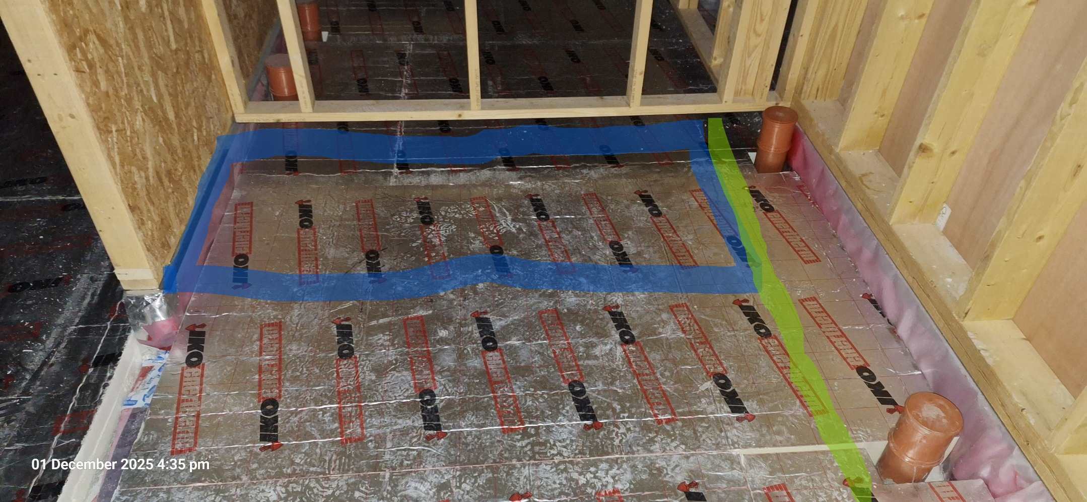

In my case the shower will be going in against 2 walls and I'll need to build a third stud wall to separate the soil stack (green line). I was going to shutter off along the edge of the shower tray +50mm. (Only 1 of the 2 layers of PIR is down on the floor in this photo. Next set to go in with staggered joints).
So you suggest that this would be fine with just the PIR and self leveling compound topped with flexible tile adhesive - what relative depths? I have 50mm to make up.
Given we haven't decided on a tray yet, I am wondering whether leaving out the PIR in this area would be wiser to allow better access for installing the waste, rather than digging it out later. If so, are you suggesting that laying the tray on the added-back-in PIR plus tile adhesive is NOT appropriate in this case?

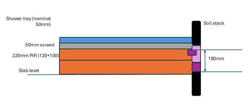

The other "exciting" challenge is that will I have to connnect the 50mm shower waste to the soil stack which is currently just that stub in the top right hand corner. A female/female straight coupler and a boss adapter (such as https://www.screwfix.com/p/floplast-push-fit-3-boss-single-socket-pipe-black-110mm/97309) puts the top of the 50mm boss at 190mm above the bottom of the coupler. With my 220mm PIR + 50mm screed the bottom of my shower tray is 270mm above the slab so I've got 80mm to play with. Even with a shallow waste, say the Macalpine 53mm (https://mcalpineplumbing.com/traps/shower-traps-accessories/90mm-shallow-shower-trap-53mm-high/) and assuming a drain in the long-side of the 1700mm tray (i.e. 1m from the stack) I'd need about 18mm fall so I'd be cutting the stub off with the coupler stopping only 20mm above slab level. Feels tight!  Solvent weld boss adaptor may be better here, assuming solvent weld is OK on the brown underground type pipe? But obviously comes with its own risks - one shot to get it right. Any other suggestions?
All sounding good atm, just not the take out / put back in of the insulation part.
This should be continuous where it appears out from under the screed into the shuttered area.
When installing the layer of insulation where the trays going, use a load of exp foam and put some weight (sand / blocks) on top to keep it all bonded whilst it cures (30 mins or so).
I use the solvent weld boss on orange (underground) pipe quite often, just clean it and rough it up with some sandpaper.
