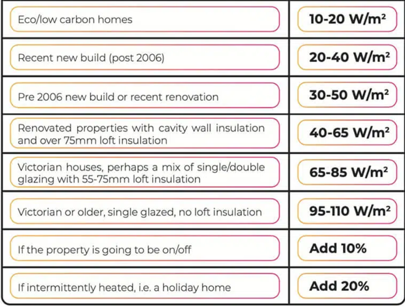

December 22, 2025Dec 22 Author **UPDATE** Following all the great advice kindly offered on here, I managed to establish a working relationship with a WB approved installer just a couple of miles away. The ageing Baxi 105e has been replaced with a WB Greenstar 4000 rated at 30kw for DHW/24kw for CH. I calculated the heat loss for the building at 12.5-15kw (it's a 2002 build of 340m2 set over three floors, with total volume of 1,120m3) at ambient of 5C and inside at 16C. We don't like the house too warm, so these metrics are fine for us. The boiler has a turndown ratio of 1-8, so 3kw up to 24kw is the operational output range. Before looking at weather compensation, I've been experimenting with simple inputs like range reduction, flow temperatures, and proper use of our existing TRVs; the system remains under the control of a Hive Mini on/off arrangement. The original twenty radiators were substantially over-sized when the house was built in 2002, so this will work in our favour for a 'long and low' regime. I've range rated the boiler down to 50% (12.5kw) and reduced the CH flow temp to 50C; I have also dropped the DHW to the same value and might go lower than this eventually. All the rads were balanced with the TRVs wide open and heat loss across the panel is around 10C. All the rads across the three floors heat up fairly evenly from cold, and after two hours the house is really very comfortable. The boiler's return temperature after two hours of heating is 44C and it's condensing really well; the amount of water it discharges is extraordinary. Now the fun bit for the techies on here. Having range rated the maximum CH output to 12.5kw, how come my Octopus smart meter says I'm using 20kw per hour of gas when the boiler is firing from cold? The half hourly plot does show the boiler modulating down a bit as the system heats up, but it's still using around 18kw each hour. The input to output ratio for the boiler is almost the same, so I am completely mystified. Am I wrong in believing that 12.5kw is the most the boiler can consume for CH?
December 22, 2025Dec 22 25 minutes ago, FlatMax said: ambient of 5C and inside at 16C Pretty flawed heat loss calculation you should have done it at -3 outside and 20 inside, but your boiler is still ok for that. Your just fooling yourself with overly small heat losses and too smaller range rating figure. Range rating to your calculations for heat losses at +5, what happens when you get a zero degree day, and your house drops to 11 degs? Because your boiler output is too low. Think I would rerun the heat loss calculation for realistic figures and range rated accordingly. 44 minutes ago, FlatMax said: from cold, and after two hours the house is really very comfortable First alarm bell is this. If you letting the house get cold (16 is cold in my book and that's your target temperature), the boiler needs to run balls out (especially when range rated right down), so may actually be struggling. Taking a long time to find a comfortable running point. To get a house to 16 with radiators in 2 hours is a long time. For me You have range rated too low You allow too much set back when heating is off - at a target of 16 why would you set back at all. Just let the heating run 24-7. Let everything stabilise. Your boiler will start to run more efficiently and modulate down on its own. Range rating is good for stop start heating as it allows a level of heating output more suited to the house at startup, but you have to careful, analogy If you are trying to fill a bucket with a hole in it (your heat loss), the hole allows 10L per minute to leak out. You open the tap (your boiler) and it flows at 10L per minute you will never fill the bucket. Open to 11L per minute it going to take a long time to fill. That is where you are now. Boiler running hard for too long.
December 22, 2025Dec 22 5 hours ago, FlatMax said: boiler is firing from cold The useful efficiency will be pretty poor initially as little condensing may be happening. The 12.5 kW you have limited to may only be a rough setting and is the thermal output. The efficiency may be down to 65% at start up, which is getting close to 20 kW. Or Was it heating water then?
December 22, 2025Dec 22 Author Thanks everyone; most helpful. So, @JohnMo I have re-rated the heat loss as per the scale shown by @marshian; it's Category three, pre-2006 new build. Using this chart gives 30-50w/m2 so between 10.5kw and 17kw plus 10% for on/off. If I take the mid-point then it's 15kw including the 10%, so I am too low at 12.5kw as @JohnMo says; I'm going to range rate it for 17kw and see what we get. Just as an aside, how quickly should the rads heat up to 50C if the boiler is correctly rated? Ours are taking about 45 minutes. (BTW @SteamyTea, there was no call for DHW when the CH was running) I'll post an update, but again many thanks for taking the time to respond to my query. Cheers.

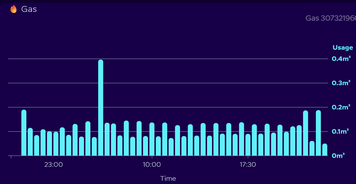

December 22, 2025Dec 22 53 minutes ago, FlatMax said: says; I'm going to range rate it for 17kw and see what we get. I wouldn’t range rate it at all if heating to a schedule to start with but I’d assess the warm up time and consider range rating only if house heat up was very fast - even then I’d probably not bother with scheduled heating and that’s coming from someone who has range rated boilers in the past but only when they’ve been grossly oversized maybe monitor your gas usage over the winter period and look at it again with a bit of data from octopus (where you can get a massive amount of half hourly data)
December 22, 2025Dec 22 21 minutes ago, marshian said: maybe monitor your gas usage over the winter period and look at it again with a bit of data from octopus (where you can get a massive amount of half hourly data) Saturdays usage in graphical form But you can extract it in 30 min slots in excel format - once you have that you can use HDD data to get a very good picture of your heat loss if heating 24/7 - on a schedule it's not going to be as accurate but it'll give you a good guide PS the peak at 06:00 to 06:30 was my water heating slot Edited December 22, 2025Dec 22 by marshian Clarify the peak
