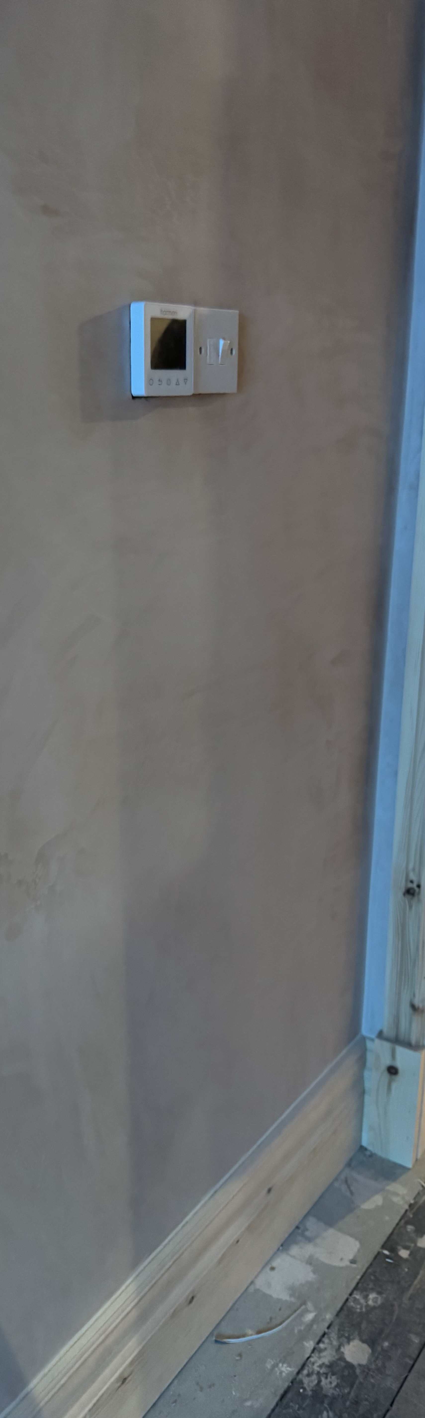

The contractors electrician has butted a spur switch right next to the heating thermostat. It’s a child’s bedroom and near the door,  so the child may think it’s a light switch.
how easy is it to move this to a lower level?
do you think a different electrician could move it?
He hasn’t done other thermostats in the house like this so it’s very odd.
What does it do if you turn the FCU off?  Does it turn off all the thermostats?
Simplest solution would be leave it where it is, but swap it to a fused connection unit without a switch.
