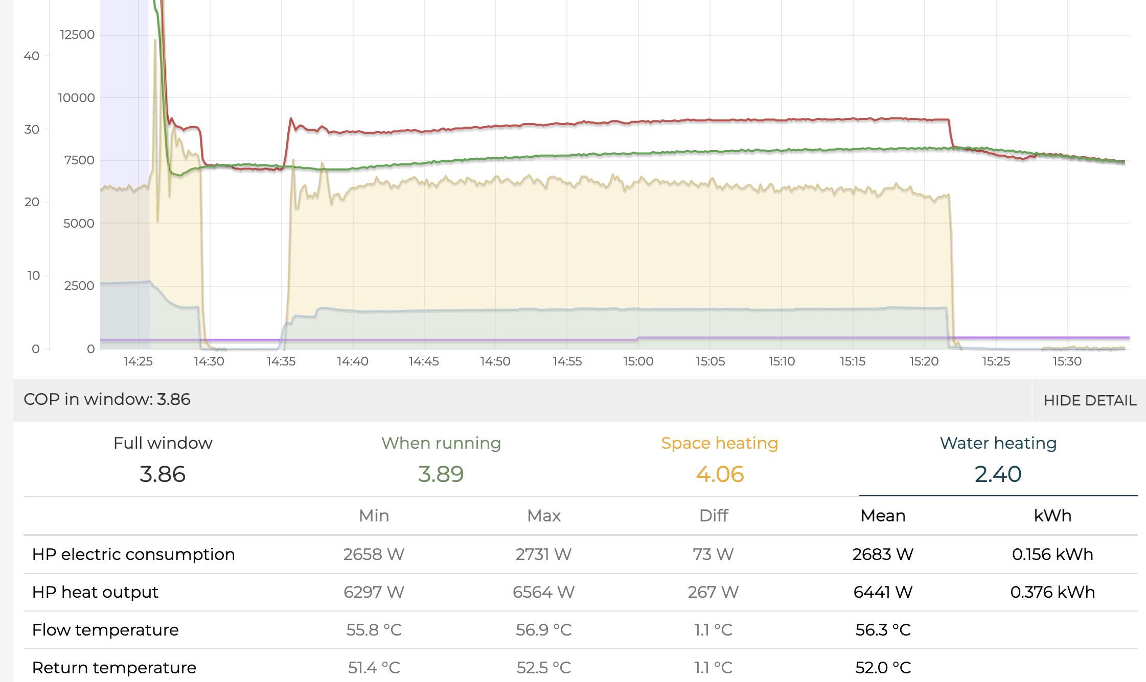

JohnMo Posted November 21, 2025 Posted November 21, 2025 At 15 to 16 your floor is certainly not giving heat off, so no surprise you dT is zero. So you are getting heat added to the system as you have gone from 15 to 25 degs flow temp. But it could be your boiler has so little to do it just puts a blast of heat in to get the general water temp to 25. To demonstrate what I mean, this is my heat pump, when running its flowing about 30 degs, and has a dT of about 4-5. However when the heat pump or boiler is not actively heating, there is being little or no work done or energy added to the system, so the flow return temps dT drops to zero. This could be what you are seeing, so the yellow section is the kW being added to system, the red and green the flow and return. See how they converge once the heat pump stops adding heat. At time of screen shot the water temp had decreased to mid 20s. The heat is still being added to house as floor is warmer that the air. How is your boiler connected to the heating system? And how are you mixing the flow from boiler to UFH? With carpets you may need to go a little hotter yet to get any meaningful heat from the floor.
