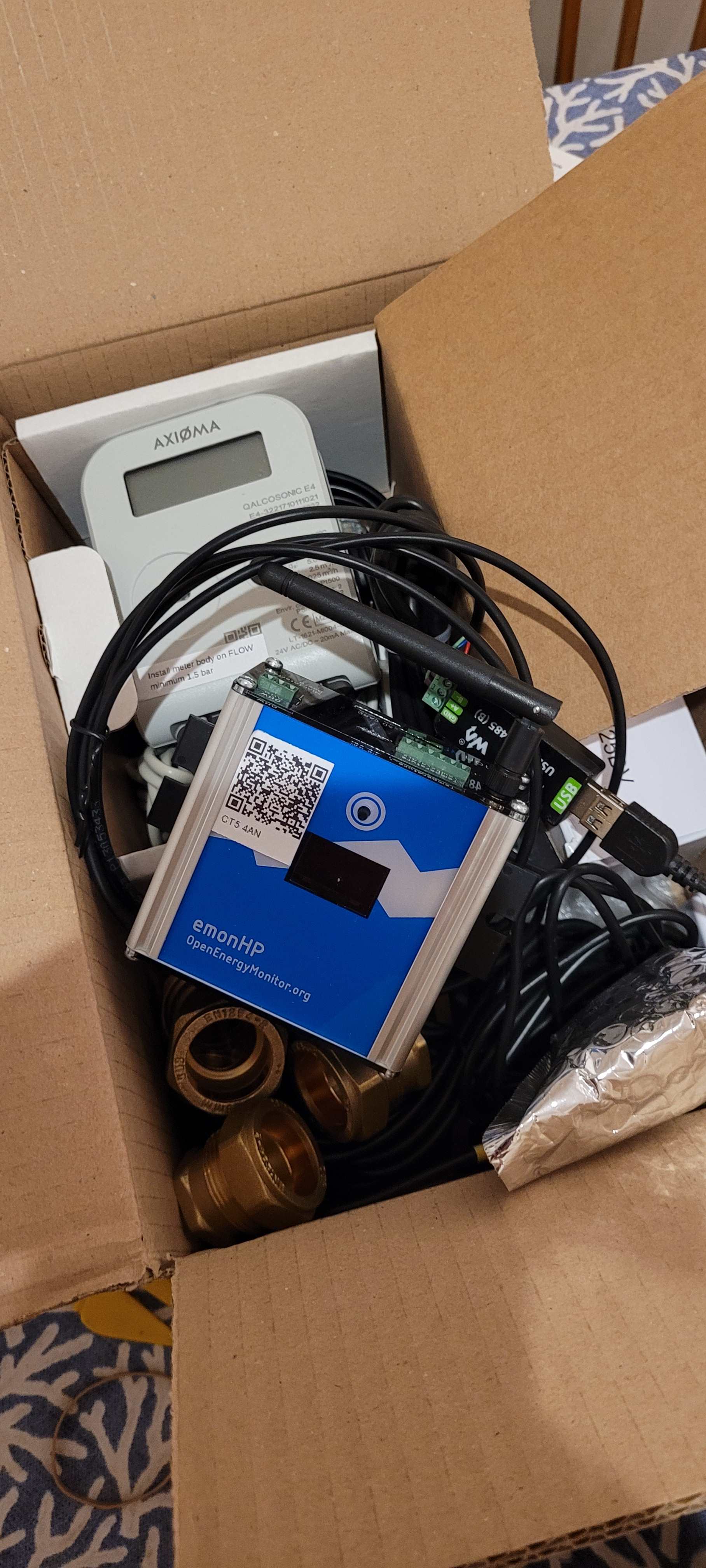

Today's learning point is this. The heat meter arrived yesterday and very smart the OpenEnergyMonitor.org Level 3 system is! 20251118_192116.thumb.jpg.2c66fdf03322c965a2f79c53cbbef447.jpg However pasted across the flowmeter port is a sticker that says '1.5bar minimum pressure' which gave me cause for concern because our system only has a 9m head pump and in normal operation we will be using only 2.7m of that at 5oC delta T  (5.57m at 3oC delta T) which is only about .25bar. So I called the suppliers and asked how this would work and got a simple, but not obvious to me, answer that you need to pressurise the system first. Reflecting on this news I think I get why the system might need a base load pressure.
