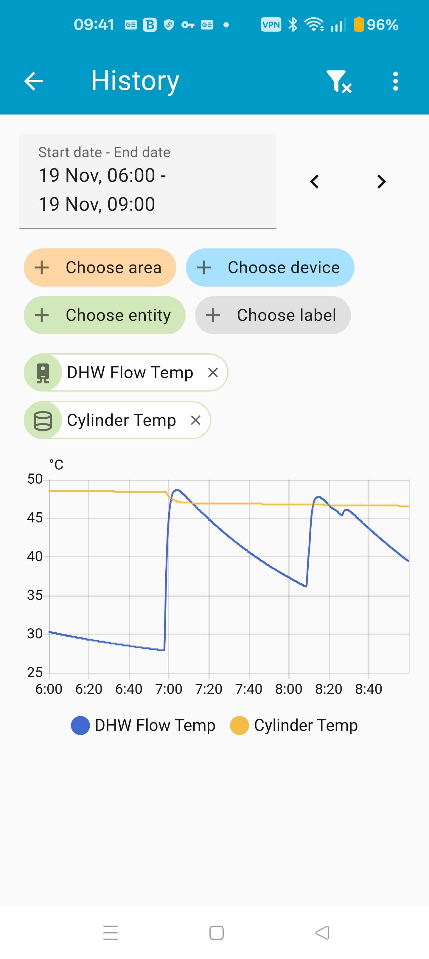

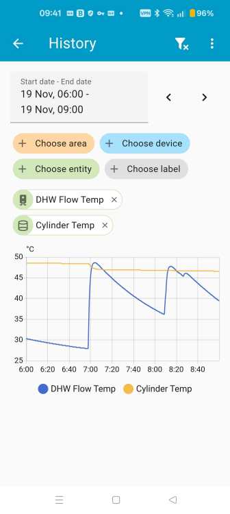

Buy a pump with built in thermostat and timer. Set thermostat so water is at a comfortable level - not super hot. Only time when you are likely to be there to use the tap. We have to our ensuite (20m from cylinder), only have it on first thing in the morning. I shower at night, and don't have secondary circulation on then as it's not needed, start shower when a go into room, by the time I'm undressed and finished messing about, the shower is almost hot anyway.  A visual of what it does, from this morning, a temperature measure of the cylinder in orange and the other is the water flowing out of the top of the cylinder. So pump effectively does two short runs over a 3 hour period.
