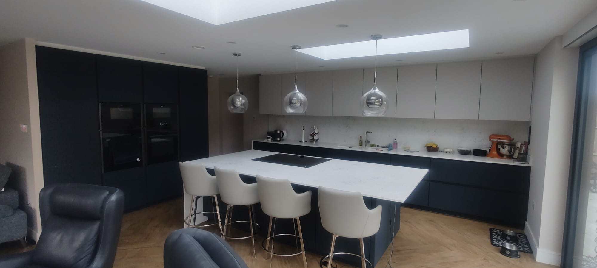

November 16, 2025Nov 16 We* use our Neff Downdraft every time the hob is used. It has a setting that adjusts automatically to accomodate the amount of steam that is being generated. Ours is on an island with a large rooflight over part of it, so keeping the ceiling clear was very important to us aesthetically We actually went to the Siemens demo kitchen to see the identical downdraft hob in action and it has proved as effective in practice as it was in the showroom. THEY ARE NOT CHEAP, but this was an early line item in our budget and we got a great cashback from Neff by buying multiple items in their annual Autumn offer. We had them in boxes for nearly 8 months before they were installed. JohnMo is dead right about the MVHR and humidity. Our MVHR inlet is positioned at the left-hand corner of the pic below. It has two extract pipes in it. We would use the "boost" function but I haven't found a way to make my Alexa+Shelly switch work yet and it seems to work perfectly well without Regards Tet

April 8Apr 8 6 hours ago, CJER said: Hi, I found your post and was hoping you could let me know where your ducting for the island sits under your floor, we're currently looking to have one installed and are rebuilding the floor due to an extension, have you gone above/below DPM, we're looking to take the ducting under our new sub-floor. Our downdraft has no external ducting. The post-filter exhaust vents through the plinth into the room. We have MVHR that gets rid of the moisture as a whole-house solution but we have a double extract over the island (you can see it above the bottom left corner of the island) Regards Tet

April 11Apr 11 1 hour ago, Dave Jones said: have exactly the same. really wish I had ducted it. It would take some thought though as the duct would defiantly condensate and would need to go uphill at somepoint to connect to a external vent and there would be pooling of condensation with the associated smells. I had exactly the same concerns about the duct and have none of the regrets that you do. Why do you wish you HAD ducted it? The only weird thing is the draught from under the island Regards Tet
