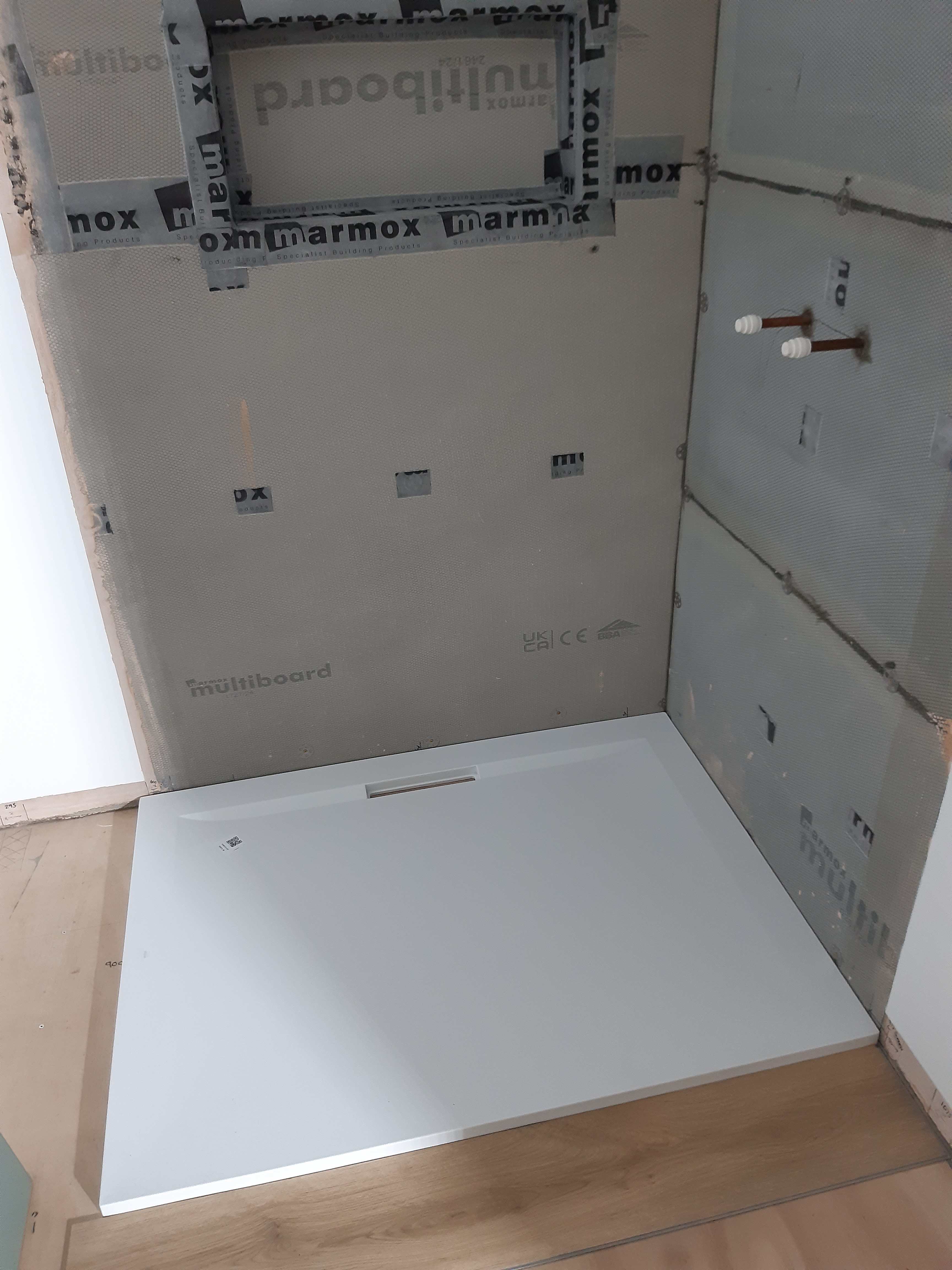

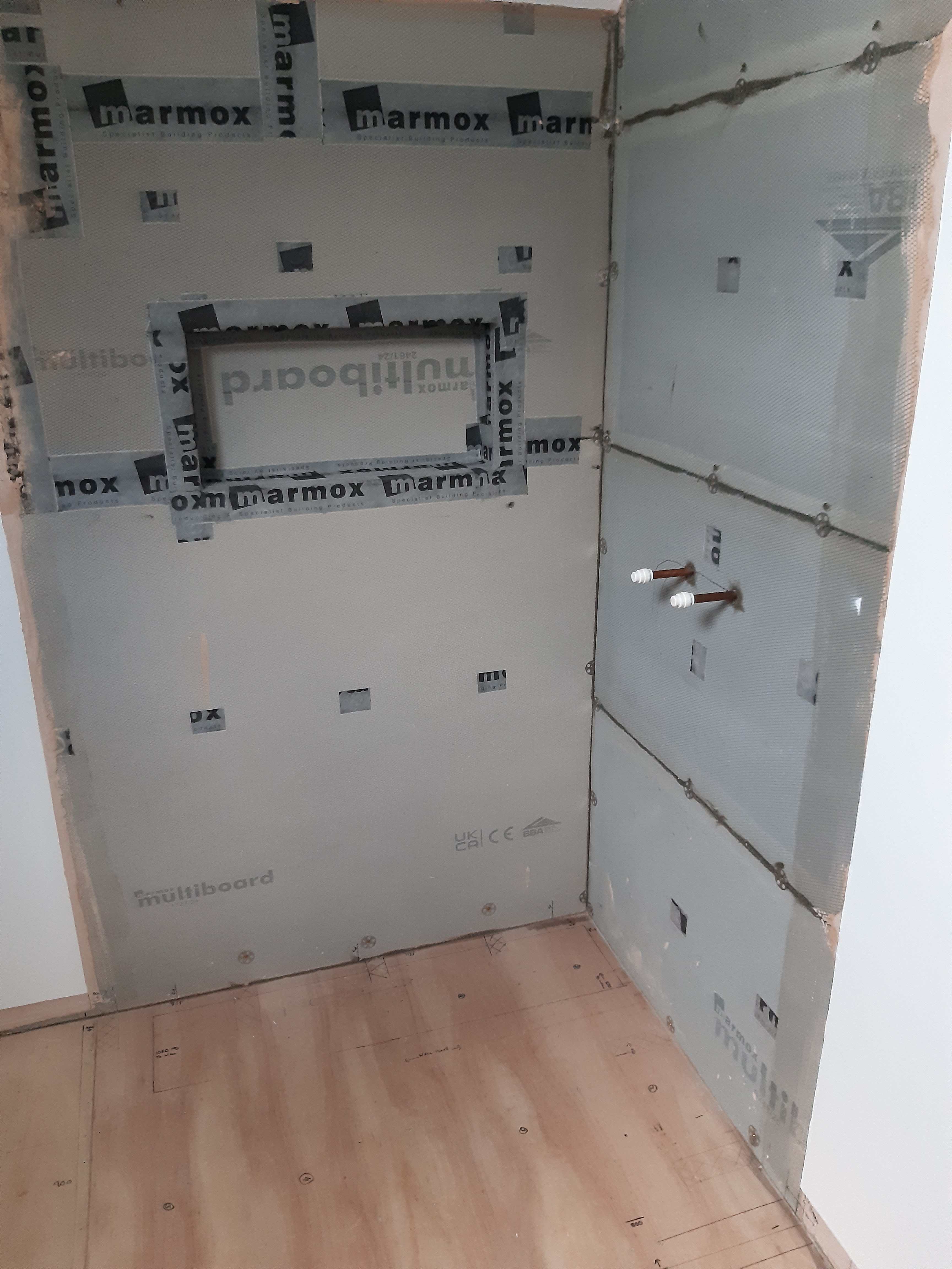

Hi, I'm looking for some advice on the best practice to prepare my new shower area for tiling.  It's situated in a first floor room that I have created in my loft space.  The marine plywood floor is sat on 8x2 joists and is solid.  The floor covering will be done in Luxury Vinyl flooring which claims to be 100% waterproof.  Shower area will be tiled and a glass screen fitted.  The cut out in the wall will have a metal preformed niche installed.  Finally, the shower itself is a hansgrohe bar type, no rain shower head though.  I have boarded out the stud walls with Marmox Multi board and sealed all of the joints with Marmox MSP360 adhesive/sealant.  Fixing screws and washers have been covered in Marmox waterproof tape.  The remaining walls have been skimmed and decorated.
I'm now at the stage where I want to add some tanking material prior to installing the shower tray (Mira Flight 25 Low Level 1200x900).  Planning to use something like CT1 for bedding the tray onto the floor.  I have a Dukkaboard Aqua 77 5kg tanking kit ready to go and am looking for the best way to go about this.

Just done a couple of new showers in our place. I put the tray on the ply with no tanking, because as you say, water really shouldn't be getting to it anyway. Also, I didn’t want the flooring in while I'm still bashing around with shower panels, toilet pans, etc.
Fixed the tray down with OB1, which is much like CT1, and used some levelling packers as the floor was not quite perfect. I had a Mapei tanking kit but had problems, as the tape wouldn't stick to the shower tray — remedied it with more CT1. I had enough tanking to cover the whole area, not just the joins, so I did the whole area anyway.
Having used these tanking kits in our old place nearly 20 years ago and never having a leak, I trust them.
Absolutely do not lay the tray over LVT!
You need to primer the plywood and bond the tray down, usually done with flexible tile adhesive but you can check with the MI’s to see what they suggest.
One key thing is to decontaminate the underside of the tray, as sometimes these have things like release agent etc or just a lot of dust from being refinished, and then nothing will stick to it.
Set the tray in to the return walls with CT1 / similar and NOT silicone.
Search in here for tanking / wet room / shower tray etc and you’ll see many of my ramblings on how to best achieve this.
NEVER use a kit or other that has something that sticks to the tray, these are not a good product / idea imho, as you’re forever reliant on that adhesion.

Zero cutting of anything!
Whoa!
I am referring to setting the tray on the deck, with the CT / OB 1 under it, and then you pull the tray away from each wall of multi board by about 5mm, and then pump the gap full of CT1.
You then push the tray back to the wall, displacing the excess CT1 and wipe the excess away (baby wipes, lots of them, are your friend here).
Check for level, and leave to cure for 48hrs.

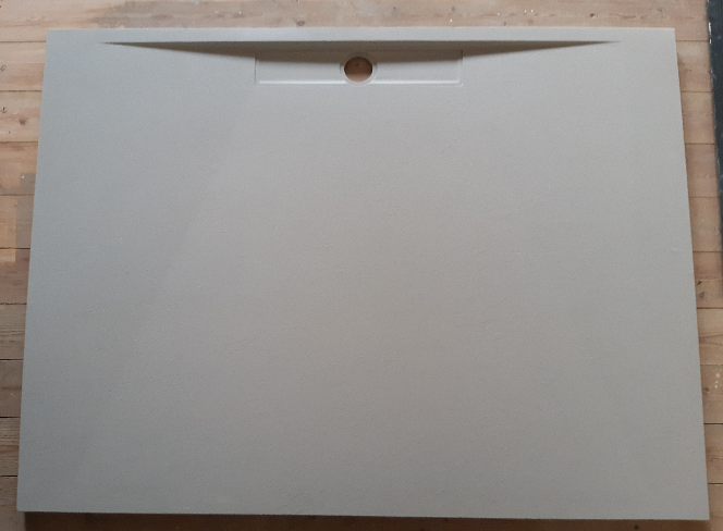

Bit of an update on this shower tray installation.  Long story short but the original Mira tray I had was warped so ended up sending it back and picked up a nice Stone Resin Duplach tray which I believe are made in Spain.

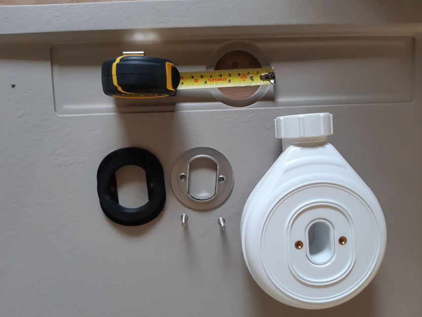

This tray is perfectly flat and straight so will be getting put in shortly.  I have a question though about the waste trap that is suppled with it, not seen one like this and is quite shallow.  No idea who makes it or what flow rate it has.  No markings on it and nothing in the manufacturers literature about it.
The hole for the waste is 55mm and the recess for the cover is about 72mm.  I understand that European pipe sizes are different to UK ones so an adaptor is supplied to join the trap to pipe (not shown).  I like the supplied rubber seal as it seals to the trap and passes through the tray flange then is bolted down with the metal disc shown.
Would people be happy installing this trap or going for a more UK recognisable one, Mcalpine for example?  A bit limited by the 55mm waste hole, my waste pipe is 50mm and will be solvent welded.  Joist depth is 200mm and tray is sat on 18mm ply.
Any recs for a suitable trap for this situation?
