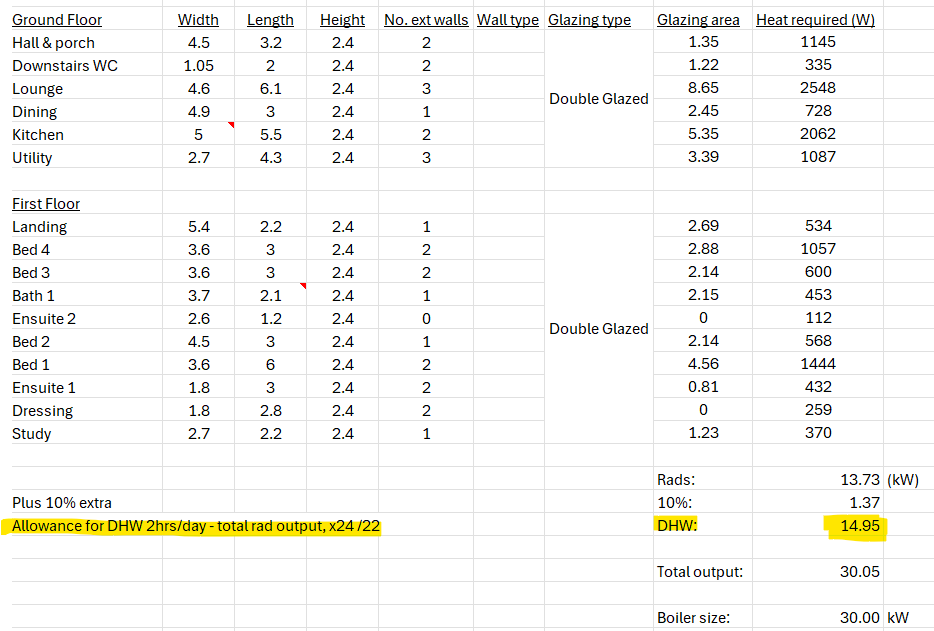

Rick734 Posted October 22, 2025 Posted October 22, 2025 (edited) Evening good ladies and gents of BH, Question on my new boiler if you would be so kind as to vent your opinions. Doing a full refurb on my 1960s 4/5-bed detached in Devon. Been getting quotes on a new system boiler and cylinder from a few local plumbers and have a bit of a dilemma on the kW of the boiler. So firstly a bit about the house - it does have cavity insulation (albeit probably a bit patchy, is evidently not too new), approx 2200sq ft GIFA, 1 main bathroom (separate bath and shower) plus 2 ensuites each with 1 shower, updated loft insulation (another ~200mm on top of the original), brand new double-glazing all round, radiators will be all-new as well. I need the capacity to, in worst-case scenario, have a house full of people in the middle of winter, with all 3 showers running at once. Cylinder will be 300L. Have had 4 quotes from various firms - 3 guys have quoted for a 30kW, which to me seems reasonable given the size of house and what I've seen in other similar-sized houses (but only gut feel) - however the guy I was thinking of using has quoted on a 24kW. He is the Ideal servicing firm for the area, has multiple engineers and should definitely know what he's talking about, and assures me that he's done all the heat calcs and it's absolutely fine etc....however the fact that everyone else has quoted on a 30kW is leaving me uneasy, and (gut feel again) a 30kW just seems like a bit more appropriate for the size of house (Which obviously you good people can't really judge from afar). What do you guys think is the best approach here, I'm practical on quite a few aspects but plumbing & heating is a bit of a grey area for me. I'm willing to challenge him again, but would like to get some independent opinions from the forum here to give me something to think about. Also not entirely sure what is the best way to do the calcs myself, if anyone can point me in the right direction...tried working it out earlier and it was recommending a 6.3kW or something...any help appreciated! Thanks, Edited October 22, 2025 by Rick734 Adding detail
JohnMo Posted October 22, 2025 Posted October 22, 2025 28 minutes ago, Rick734 said: 30kW, which to me seems reasonable given the size of house First you don't size a boiler based on house foot print or size, you size based on heat loss. Nearly every boiler installed in the UK is massively oversized. So to size well you need to do heat loss calculation. Second at a more average heating day in the UK it's about 7 degs - so heat loss is approx half your design heating day -3(ISH). So you want a boiler that modulates down to pretty close to the output of the 7 Deg day, then it can just tick away adding only the heat lost. 29 minutes ago, Rick734 said: need the capacity to, in worst-case scenario, have a house full of people in the middle of winter, with all 3 showers running at once. So you are looking to size system based on a once a year eventually if ever. This can get difficult, expensive and maybe make system over kill so be careful what you ask for. Two showers at full performance is easy, three may push things at full flow depending on shower heads. I would do your 300L but insist on a heat pump one with 3m² coil - this gives super fast reheats or you can reheat at a much lower flow rate for added efficiency, in a more normal time. Boiler plumbing - Do not accept anything other than PDHW (priority domestic hot water), this allows one flow temp for cylinder heating and a different one for central heating. And you fully boiler power given to the cylinder. So S and Y plan is out. If your plumber doesn't understand priority domestic, strike from the list automatically. 1

marshian Posted October 23, 2025 Posted October 23, 2025 5 minutes ago, Rick734 said: Thanks Marshian - will get my head around weather compensated but PDHW definitely sounds like the way to go here. Hopefully the gaff won't be too leaky and definitely isn't huge so as you say will have to get one that modulates down to house heat loss. Have run heat loss calcs based on Stelrad's online tool which suggests 75deg flow temps as standard... Heat loss calcs A great video by Urban Plumbers covering how to do a basic heat loss calc - worth watching There are other tools on the net like Heat Punk who offer online modelling of heat losses @Jeremy Harris Tool on here is often highly praised but I've never used it 1 minute ago, Rick734 said: Thanks JohnMo super helpful, so just so I've understood your point about the DHW requirement correctly...my rad kW requirement x 24 then /22 should give me the DHW element of the boiler size? So as below...would you say that's correct? All fine until the end - based on the above you need a 16kW boiler max

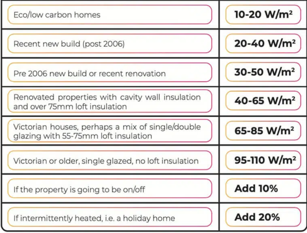

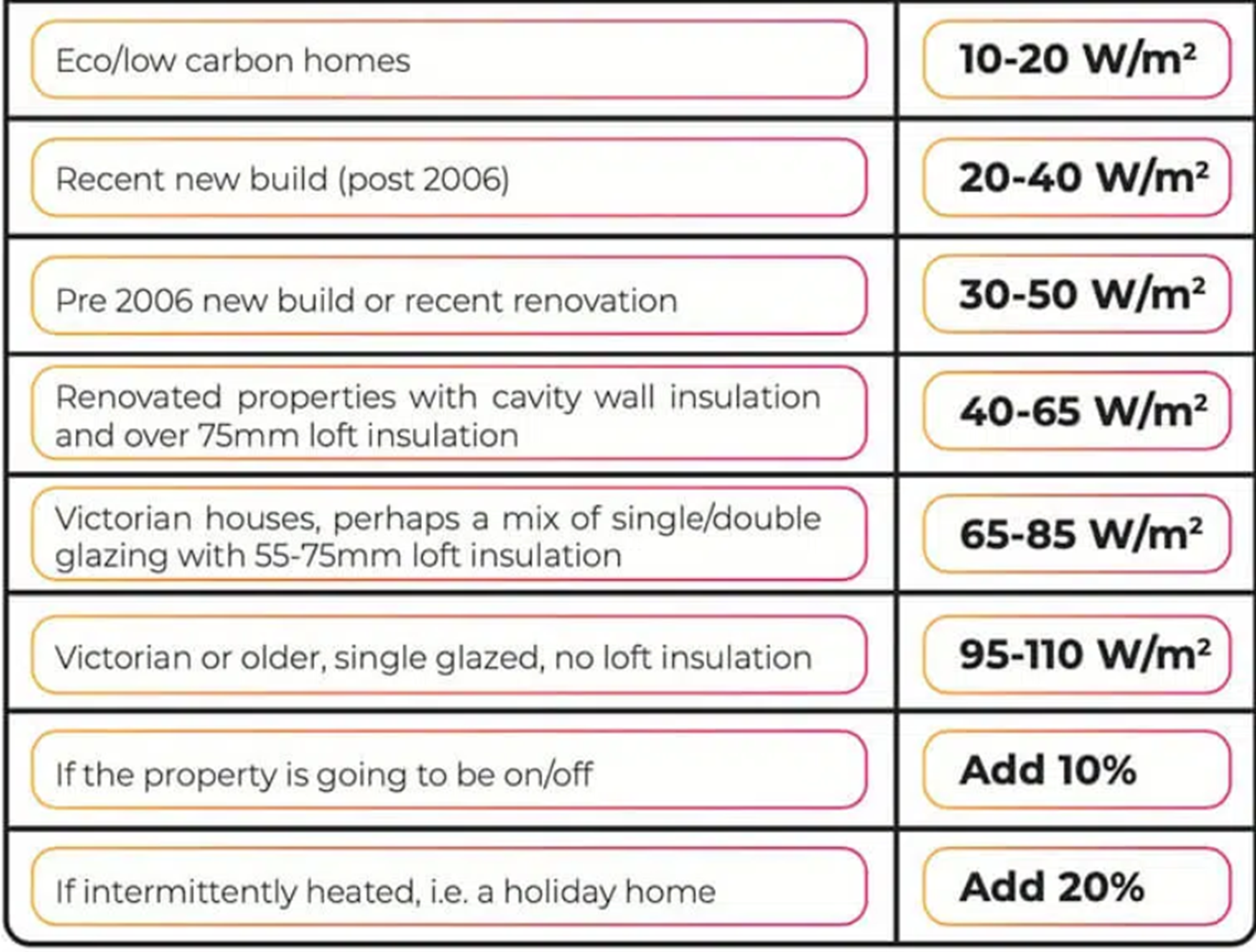

marshian Posted October 23, 2025 Posted October 23, 2025 Oh and I do think those calcs are a little on the strong size Based on Heat Geek Guidelines Quick and Dirty from your earlier calcs Says for Renovated property with CWI and over 75mm of LI - best case 40 W/m2 worst case 65 W/m2 So Your worst case would be 11.5 kW best case 7.5 kW (not including HW Demand) I have an early 80's 4 Bed detached house which is a stupid T shape so lots of rooms with 2 or more external walls and my overall W/m2 is 35 Improvements post construction are CWI, 300 mm of LI, SUDG Windows and Doors, 52 m2 of 75mm PIR under the suspended ground floor - not much more I can do to it now.

JohnMo Posted October 23, 2025 Posted October 23, 2025 50 minutes ago, Rick734 said: DHW requirement correctly...my rad kW requirement x 24 then /22 should give me the DHW element of the boiler size? Not quite correct. The calculation gives you your boiler size. If you need 13.7 for central heating - 13.7 x 24 is 329kWh for your daily heating. To complete the central heating and allow 2 hrs for DHW, you divide 329 by 22, that is 15kW. This is your boiler size.required for central heating and DHW. The above assumes you have done your heat loss calculation correctly. Using the Jeremy spreadsheet is good if close to passive, but can be quite a way off if you are not. I would use the info posted by @marshian to get a best guess. Your calculation doesn't seem to include much in the calculation, cannot see floor or wall or roof U values or ventilation losses, hence saying using the approx information above by @marshian.
