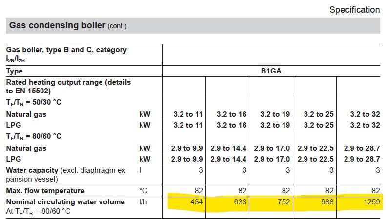

marshian Posted October 22, 2025 Posted October 22, 2025 Just now, SimonD said: As @JohnMo suggests it's down to flow temps and latent heat when condensing. 1:5 modulation ratio ain't that good. Better go with a Viessmann if modulation is important to you. Personally I'd also lean to a system boiler unless you've got particular system issues that make it impractical. The min outputs are very much aligned to flow temps you are running My Viessmann 100-W 16 kW Heat only (Open Vented) is rated at 2.9 at 80/60 but that increases to 3.2 at 50/30 I'm running it at max 32/25 at -2.5 OAT - it's range rated to absolute min for CH and my data gathering tells me that clearly it's running at 4.0 output under those temps which is perfect for me because house heat loss is a smidge under 4.0kW So in a nutshell the modulation ratio is actually 4.0 but it doesn't really matter to me as it's sized to meet the heat loss of the house with a max of 16 kW which I need to heat HW tank in a reasonable time frame. Ignore the yellow highlighting I used the image elsewhere (Highlighting the importance of knowing what your boiler needs to function properly)
