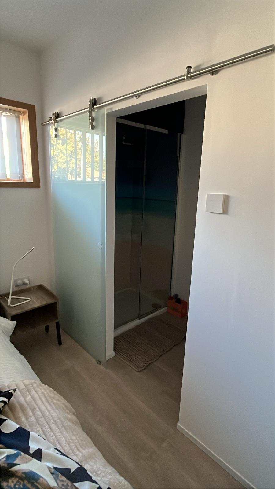

Simon R Posted October 6, 2025 Posted October 6, 2025 An alternative you might consider using a glass sliding door surface mounted. It makes finishing a bit easier than a pocket and is much more robust . 1

finito Posted October 6, 2025 Author Posted October 6, 2025 15 minutes ago, Simon R said: An alternative you might consider using a glass sliding door surface mounted. It makes finishing a bit easier than a pocket and is much more robust . Thanks Simon, looks really neat, but the new door would connect the bathroom with the hall so can't have a glass unfortunately.
