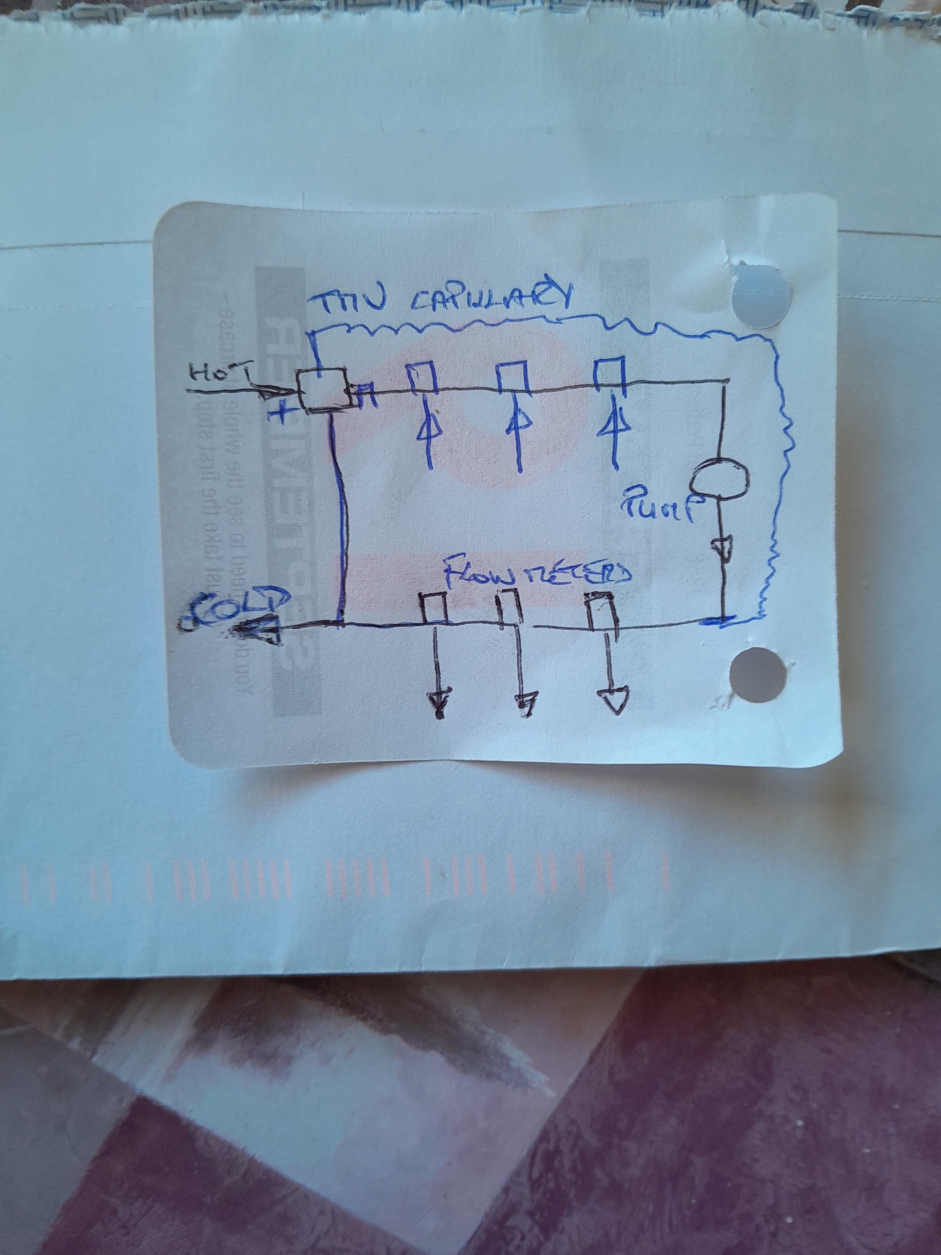

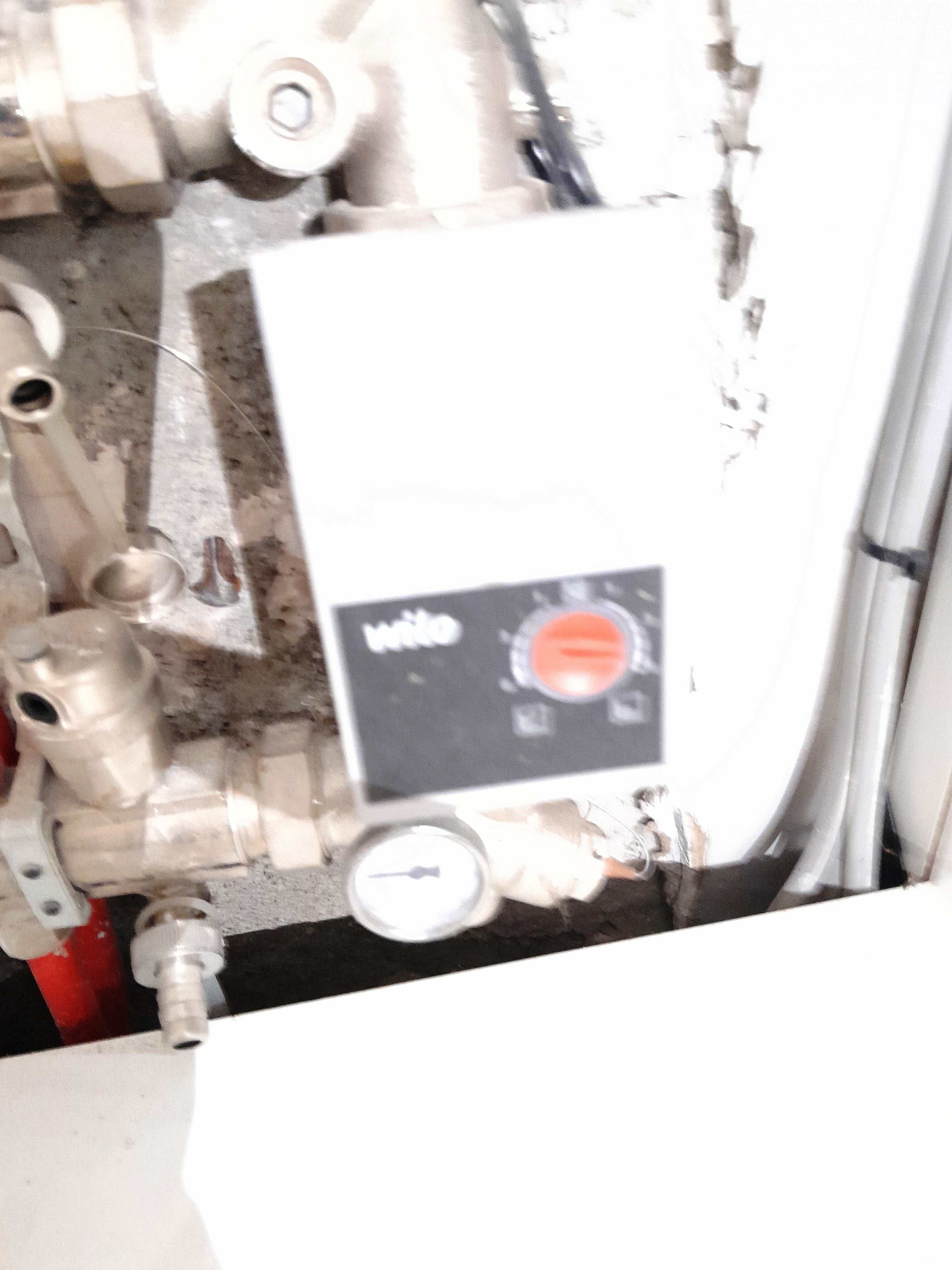

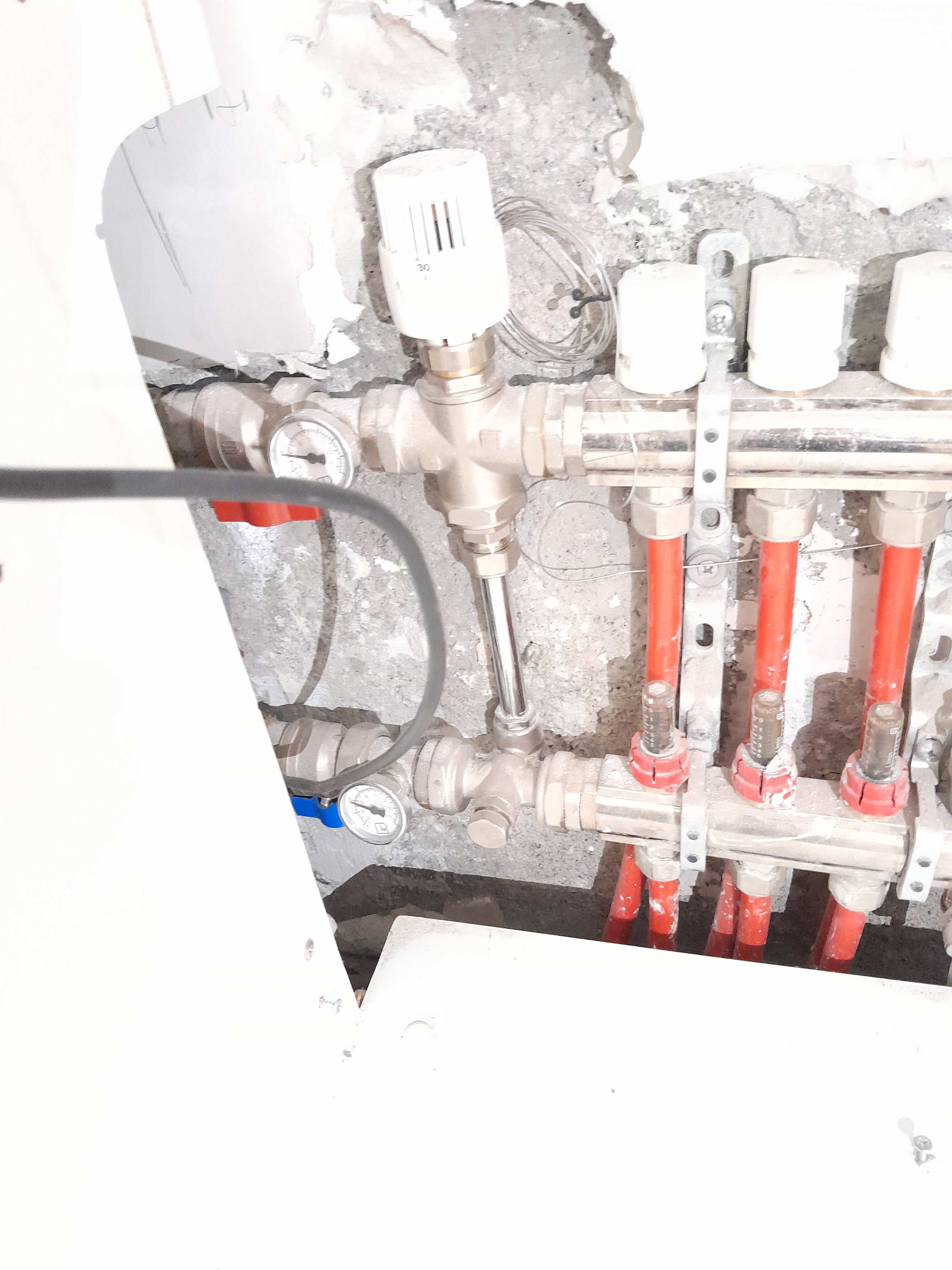

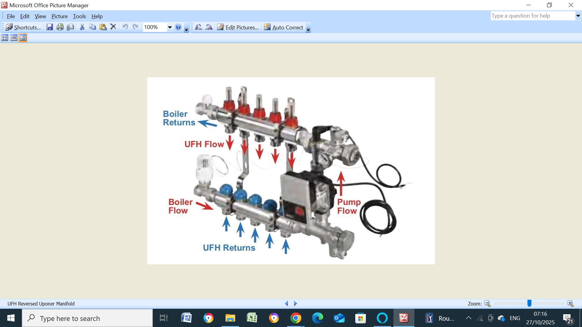

John Carroll Posted October 4, 2025 Posted October 4, 2025 (edited) This setup is apparently working fine for the past 10 years, its set to give a UFH temp of 30C from a oil fired boiler running with a 65C flow temp. I havn't seen it in action yet but just can't figure out how it actually works, the manifold pump is pumping downwards but I can't see how any cold (UFH manifold return) water is returned to the boiler. Edited October 4, 2025 by John Carroll

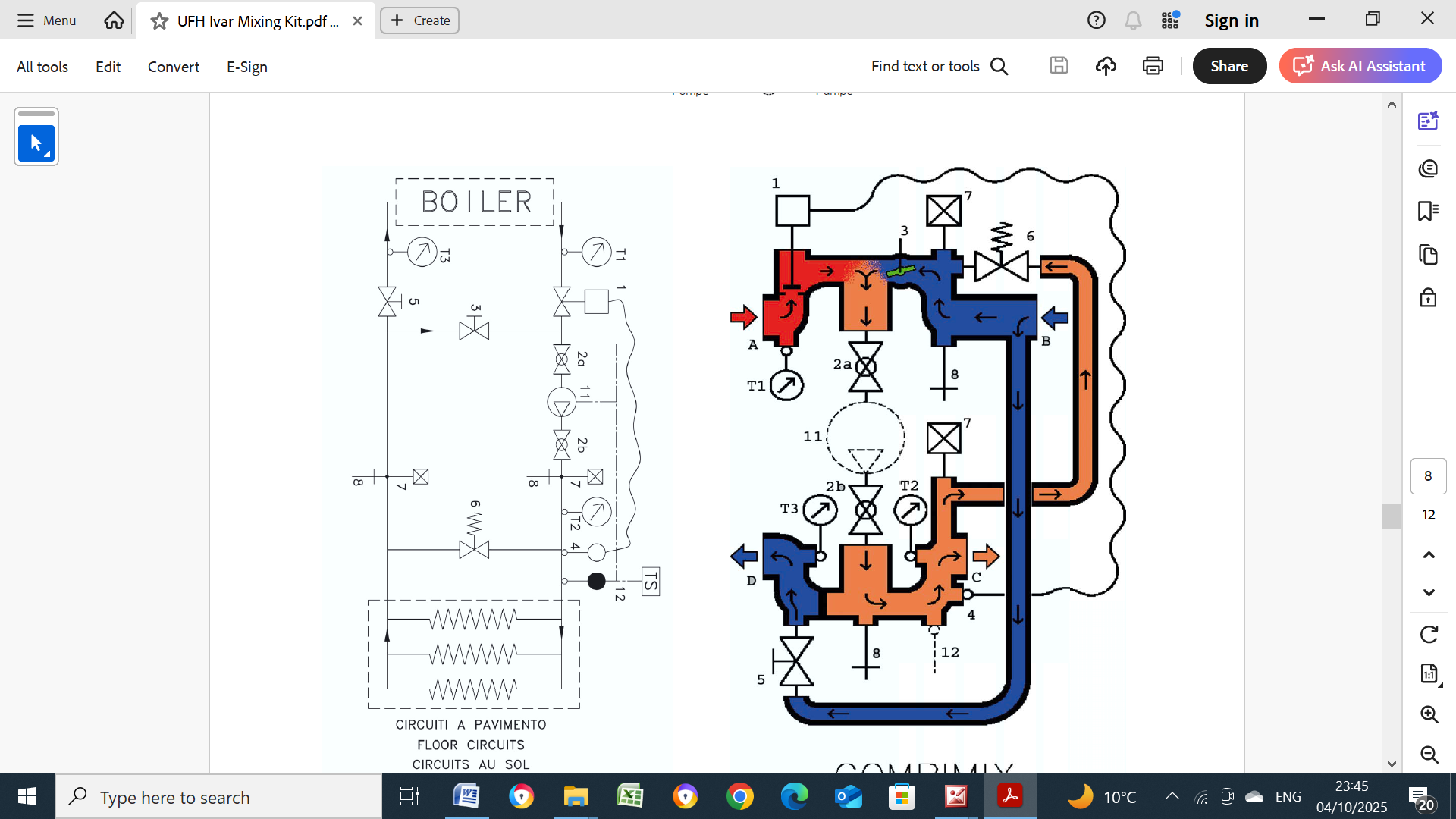

John Carroll Posted October 4, 2025 Author Posted October 4, 2025 36 minutes ago, JohnMo said: Ok, obviously our answers not good enough, I won't bother next time I appreciate all answers John, the nearest arrangement I can find is the one below which makes perfect sense.

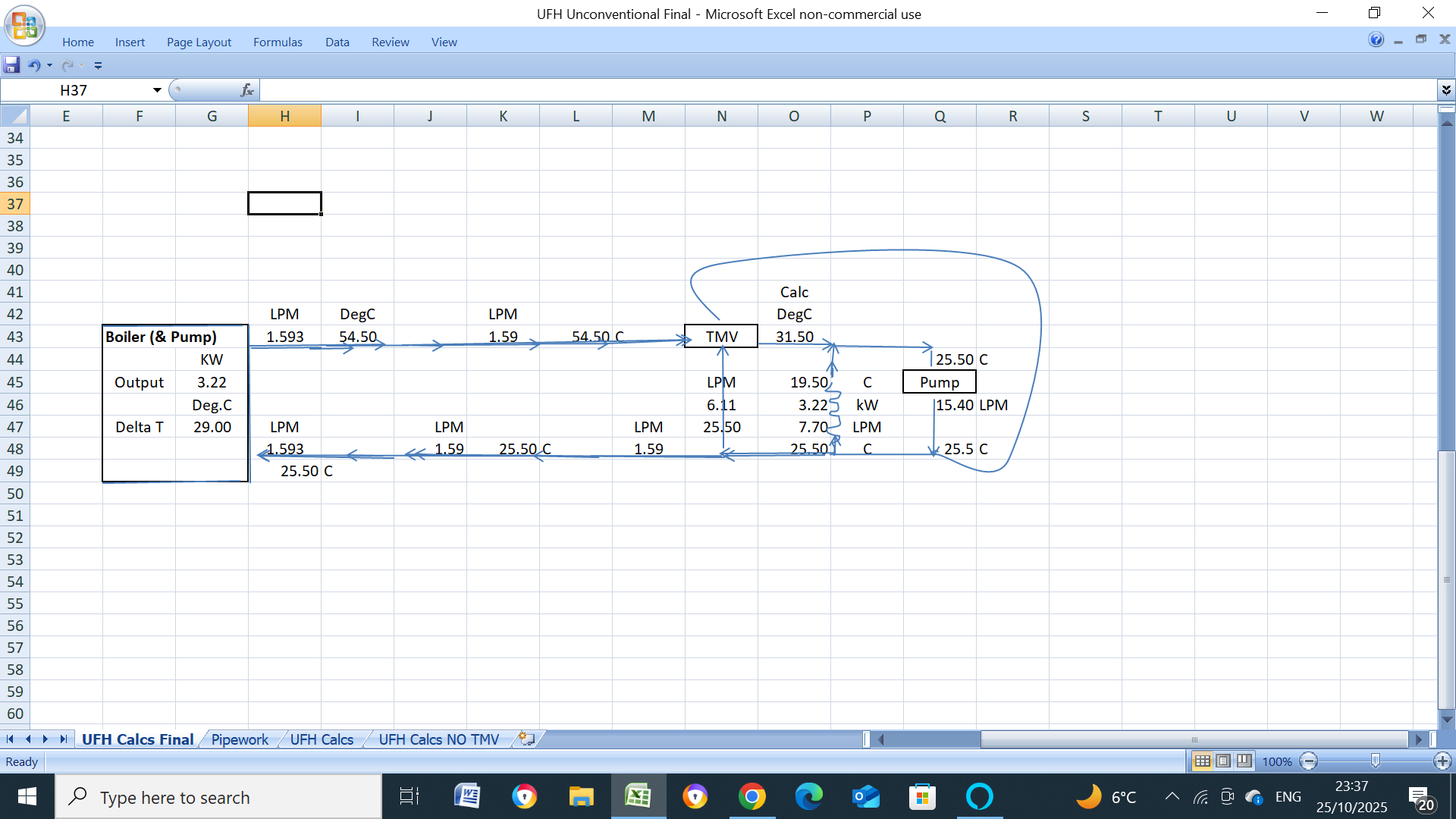

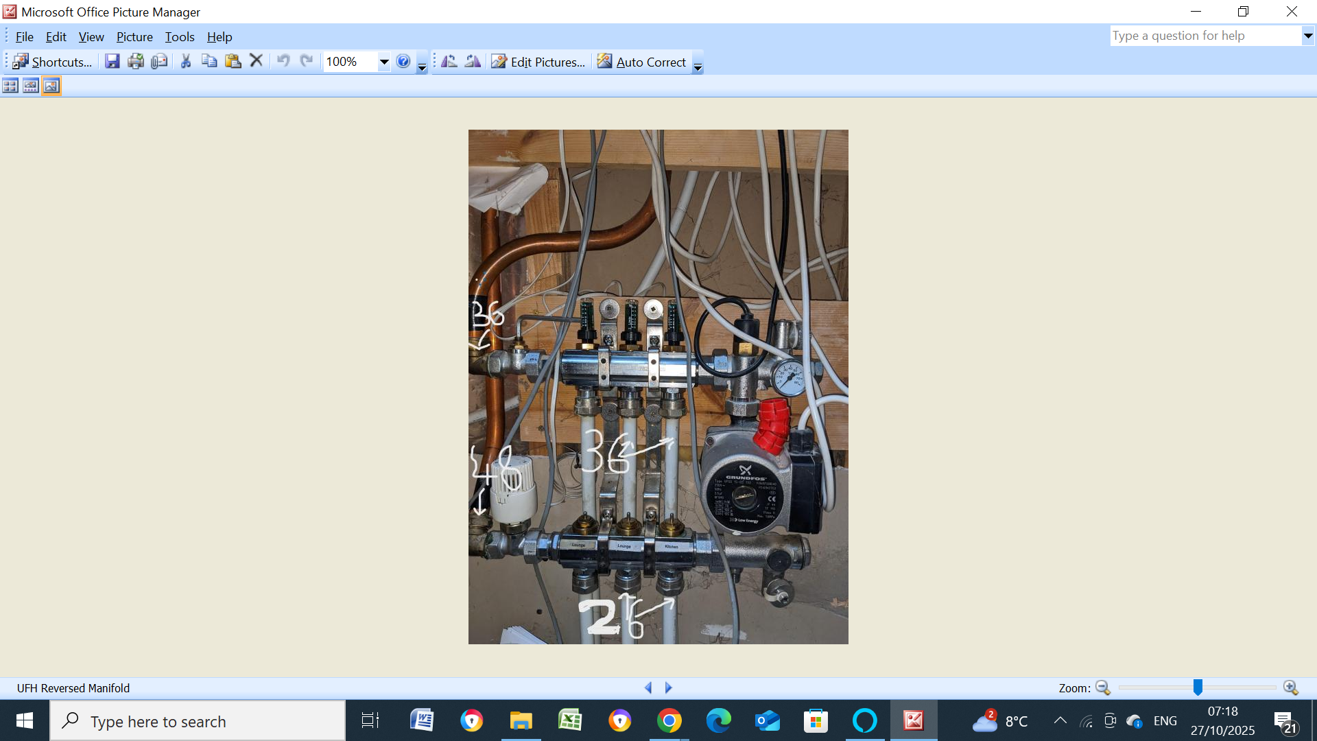

John Carroll Posted October 25, 2025 Author Posted October 25, 2025 Glad to report that after viewing it, I can see that this UFH is operating fine. The manifold pump is pumping downwards, the 3 flowmeters are reading a total of (2.5+2.7+2.5), 7.7LPM, the UFH loops are operating at a dT of, (25.5-19.5), 6.0C, this gves a calculated Boiler/UFH output of (7.7*60*6.0/860), 3.22kW. The downside of this set up is, one, that the mixed water is returned to the boiler and not the UFH outlet water which means that returned water temperature is higher, in this case, returned at 25.5C and not 19.5C, resulting in a slight loss in condensing efficiency, and, two, the manifold circ pump is circulating at twice the UFH loops flowrate resulting in greater pump power required.
JohnMo Posted October 25, 2025 Posted October 25, 2025 21 minutes ago, John Carroll said: The downside of this set up is, one, that the mixed water is returned to the boiler and not the UFH outlet water which means that returned water temperature is higher, in this case, returned at 25.5C and not 19.5C, resulting in a slight loss in condensing efficiency Is it really a down side? If you only allowed UFH return back to boiler the flow through the boiler would be very low and most likely just short cycle.
John Carroll Posted October 25, 2025 Author Posted October 25, 2025 (edited) No John, not really, the oil fired boiler here has a TMV to maintain 40C return to prevent corrosion but I've omitted it for simplicity, but I suppose gas fired boilers on UFH only can be run with very low flow/return temps and some can now modulate down to ~ 2.0kW, so some impact here, still it seems a very unconventional way of implementing the UFH and took me a long time to realize that the mixed water can also be used to reduce the UFH flow temperature. I think this schematic might show how this system was running when I noted the data. Edited October 25, 2025 by John Carroll
John Carroll Posted October 27, 2025 Author Posted October 27, 2025 (edited) Upnor apparently sell (or did, in 2023) a system something like the subject one and don't even use a TMV, they simply use a Tapstat with some the mixed water also returning to the boiler/ASHP. First screeshot below shows a live system with a ASHP. The manifold pump is pumping Upwards. Edited October 27, 2025 by John Carroll
Sumo Posted October 27, 2025 Posted October 27, 2025 Hello John Caroll. I hope you are well. I am the poster/owner of that uhf loop. Not sure this will help. I have one question for you, to see if we can improve your efficency? Can your floor surfaces tolerate more than the 30 centigrade that your ufh TMV is set at? The closer your tmv is to your boiler flow, the less the loss, John Cantor did a youtube on it. As you say you need your boiler return at a minium of 40, it would make sense to target an ufh return of at least 40. Also that way you are reducing the loss through mixing at the manifold. Can your boiler target lower than 59, or is that needed for elsewhere.

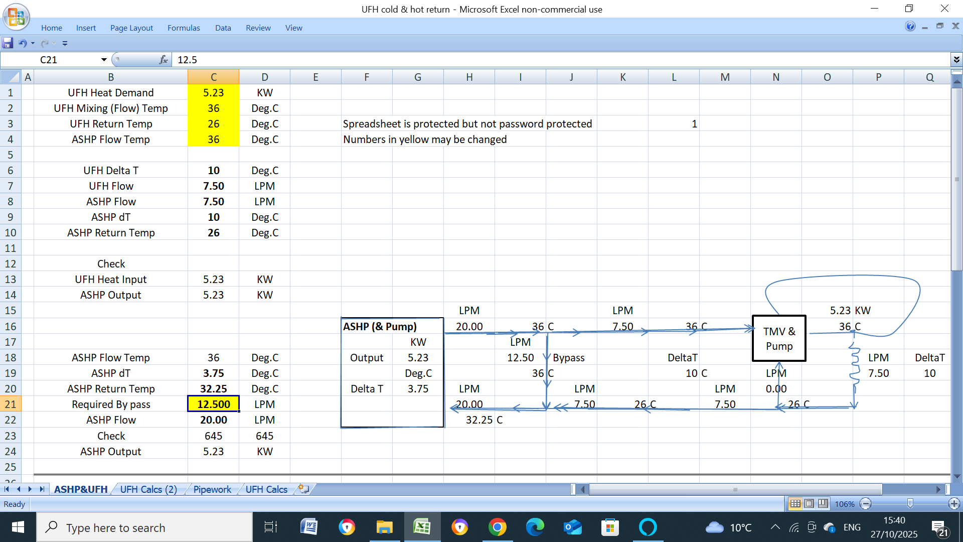

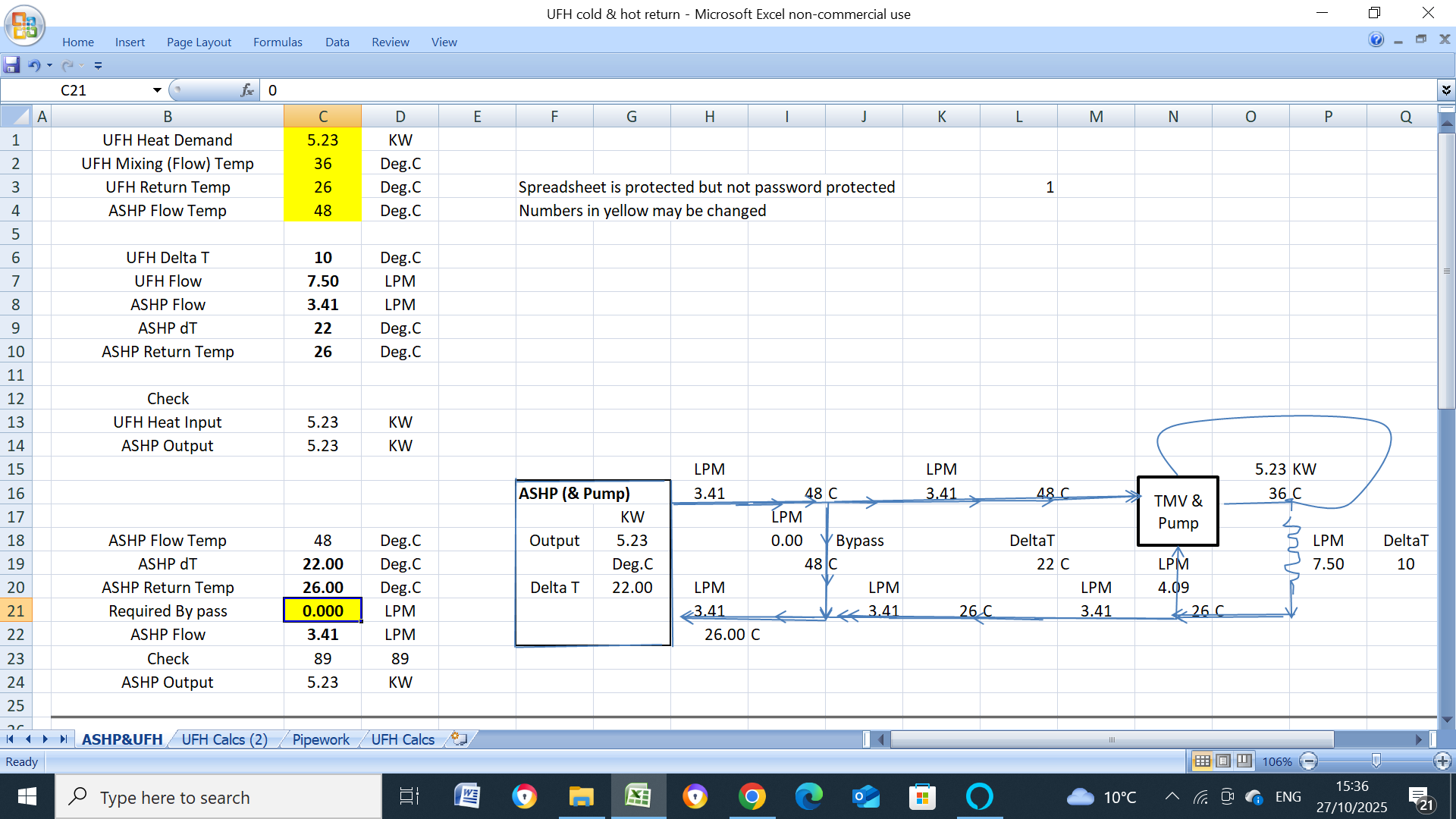

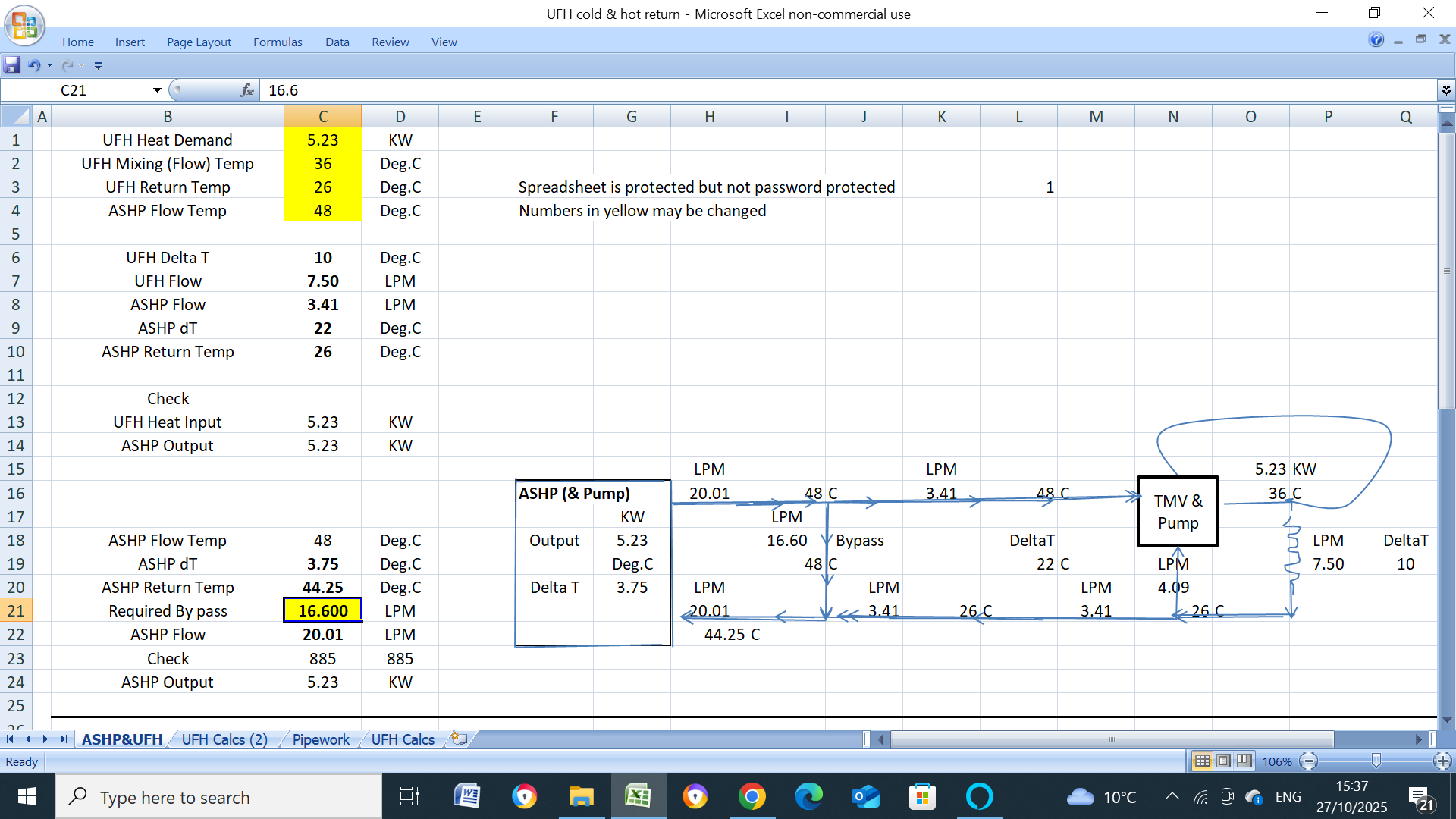

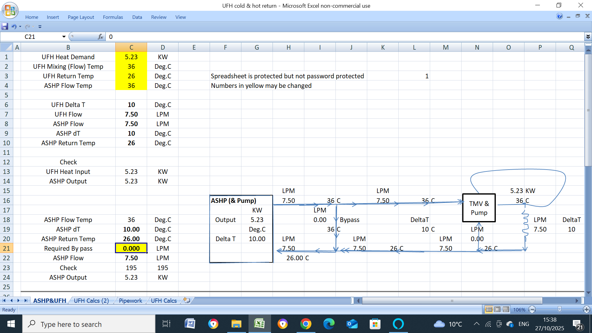

John Carroll Posted October 27, 2025 Author Posted October 27, 2025 (edited) No, its the boiler return temperature that primarily determines the Boiler efficiency, the colder the return temperature, the colder the boiler flue gases are, leading to greater efficiency, if you could lower the retur temperature to say 20C then you would have a almost 100% boiler efficiency. The flow through the loops will always and only be greater than the ASHP return flow when the required Loop flow temperature is less than the ASHP flow temperature, for example, with loop flow/return of 36C/26C and ASHP flow/return of 48C/26C, the % ASHP flow is (36-26)/(48-26), 10/22, 0.4545, 45.45%, a loop flow of 7.5LPM will return 7.5*45.45%, 3.41LPM to the ASHP and recirculate/mix , 7.5-3.41, 4.09LPM with the 3.41LPM from the ASHP at 48C to give the 7.5LPM at 36C loop flow temp, (3.41*48)+(4.09*26) = 7.5*36. If, both the flow/return temps are the same for both the loops and the ASHP, then both flowrates exactly the same. The bottom, 4th fom top screenshot below shows this, the 3rd from top screenshot shows the bypass required to give your required ASHP flowrate of 20LPM. The 2nd from top screenshot shows the data if you run with loop and ASHP flow/return the same at 36C/26C and the top screenshot just below shows the bypass required to give that required ASHP flowrate of 20LPM. Hope this is of some help. Edited October 27, 2025 by John Carroll
John Carroll Posted October 28, 2025 Author Posted October 28, 2025 Have attached two files which combine the UFH+Rads, the other just shows UFH only but you or anyone can play around with the values and you can see the effect, hopefully, more easily. You can configure any one of S.Sheets for UFH only, Rads only or UFH+rads. by just changing the values in yellow. UFH ONLY Sumo Extract Rev0.xlsx UFH + Rads Sumo Extract Rev0.xlsx
Sumo Posted November 2, 2025 Posted November 2, 2025 Thank you for all your efforts, John. I will spend some time digesting and altering them to see the changes. My head is elsewhere due to a crisis at home, so I probably need more time to learn some more. The 4l/min used by the ufh only, from the ashp flow, highlights why the ashp struggles to modulate to the low demand, especially as ours does Not have a auto-bypass around the ufh manifold. If the ufh was left as two zones, then a demand of 2l/min would be making the ashp run, crazy to design a system that can call for power yet only need to use 10% of the capacity. Thanks again.
