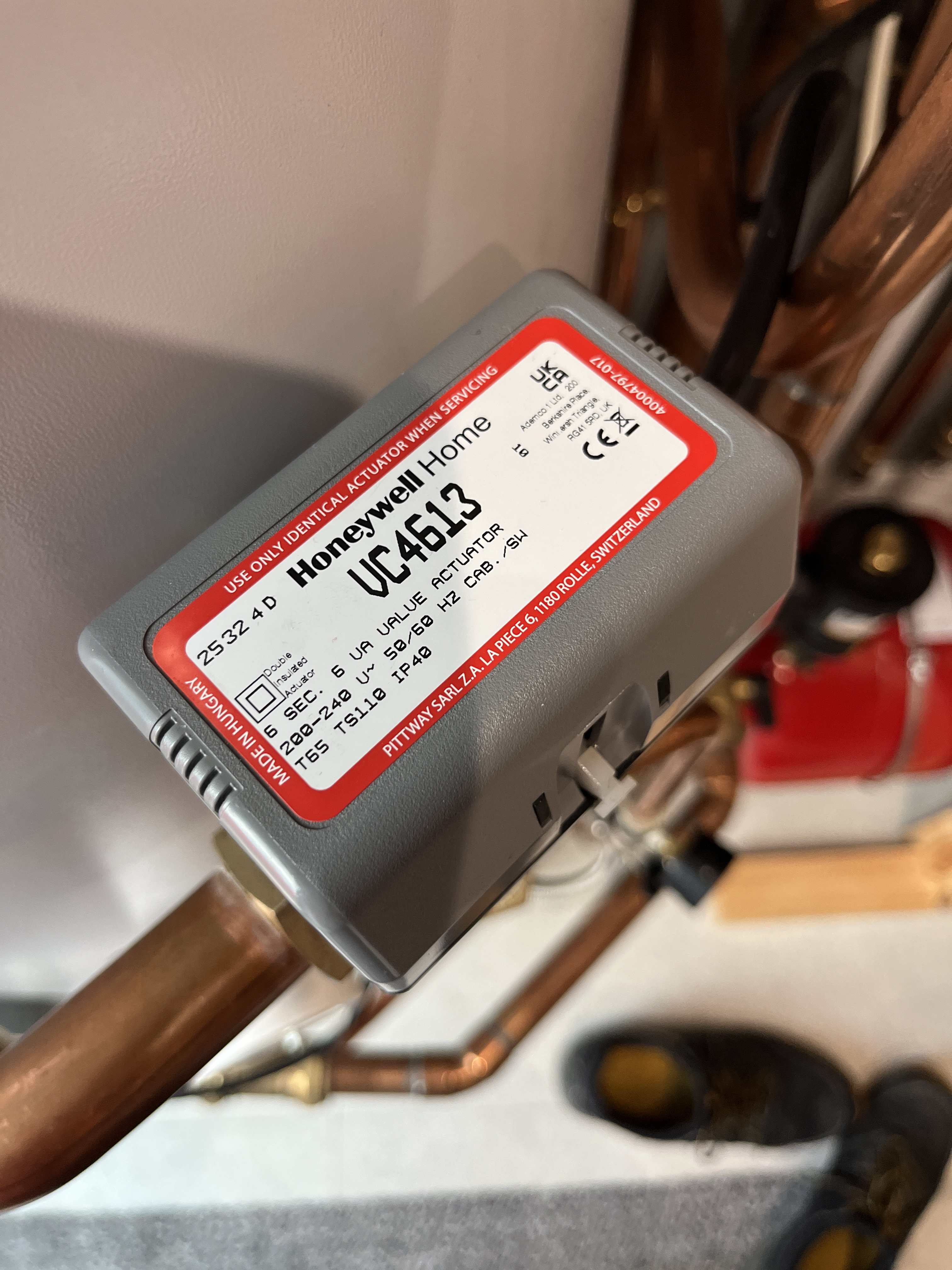

Is there a hidden setting to stop the circ pump when the 3 port changes over? We’re getting banging noises from the primary pipework when the valve changes from dhw back to heating and I’m pretty sure it’s because the pump is still running.

What series have you got? I'm guessing that the DIP switch to enable DHW functionality is set correctly or you'd likely not have any DHW options at all. Assuming the switch is set correctly, any options for DHW settings should be showing in the installer menu but I dont remember seeing anything about settings during changeover.
If you've got rattling pipework options I'd look at would be-
Secure the pipework
Throttle the pumps maximum output in the installer menu
Change your diverter for one that doesn't block the flow when it's changing from one port to the other
This is a 5kW gen4 on 3.06.9
I’ll try setting the pump to a fixed dT5, it’s set to maximum flow at the moment (we were chasing a ch14 error)…..
Valve is a standard Honeywell diverter in 28mm… same as used on my Vaillant cylinder (heated by a CoolEnergy), and a Samsung I commissioned at another property.

I'm guessing that if there's some knocking when the diverter changes over that there's a short period when it's closed to both DHW and CH which is causing the knocking?? Slowing the flow might be the easiest fix but if that doesn't work then a change of valve or securing the pipework could be the next step. I think you've got a display of flow rate on the series 4 so can see if you're maintaining a decent flow if you back off the pump
I don’t get this behaviour on my CE iVT9, with the same diverter, but I’m pretty sure that stops the pump on changeover.

If the ivt9 stops the pump then that seems to be different to the Therma V?? A bit of experimentation needed

I’ve set the pump control to fixed dT5 for both dhw and heating, still getting the knocking on changeover.
re-pressurised the expansion in the outdoor unit (the only expansion on this system), pipe work seems quite secure. Not too sure what to try next apart from adding more expansion or changing the valve. I was mistaken, it’s actually an EPH controls valve, not a Honeywell.
Swapped the 3 port round and moved the wiring to suit, B to bath, all quiet now… not compliant with BR but we’ll ignore that for now.

Nope, that didn’t fix it…had to swap the valve for something less rubbish….IMG_1444.thumb.jpeg.488d368ad9006bb942c5040c754b97aa.jpeg
