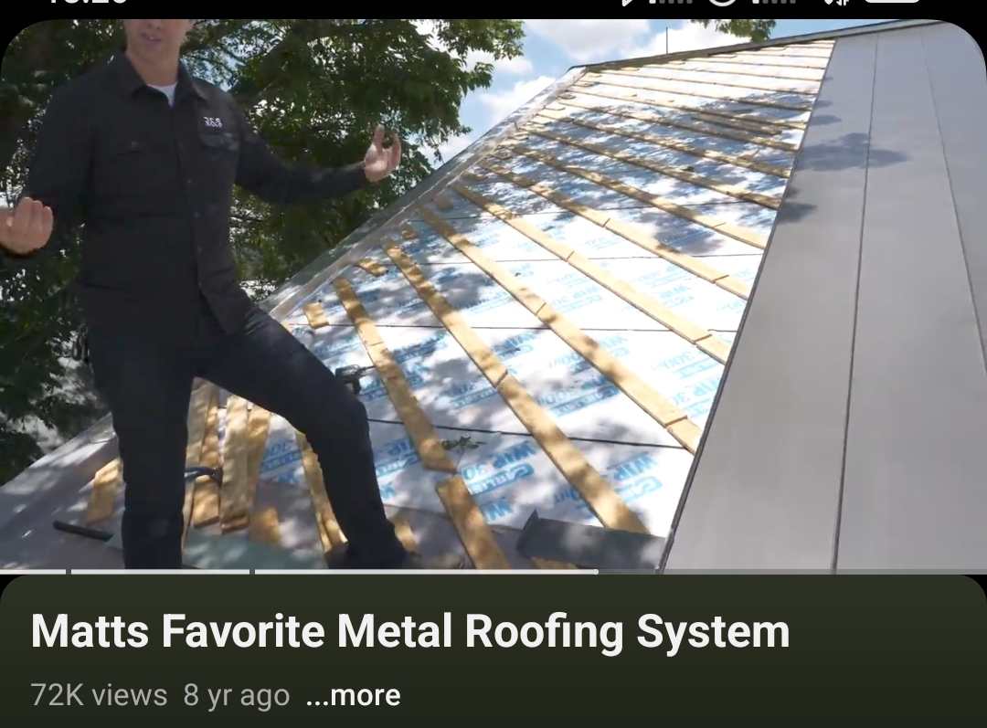

Iceverge Posted September 6, 2025 Posted September 6, 2025 I would consider omitting the top layer of OSB entirely. It's doing nothing really. I would just diligently tape the joints in the ply too and forget about the vapour membrane. You could spec the trusses with a wider top chord from the Factory to avoid the need for the additional batten. In any case I would use 2x layers of 100mm PIR, joints staggered foamed and taped. Don't fret about thermally broken fasteners. They'll be almost zero performance difference to a metal one as the cross sectional area is so small over 200mm. The counter battens and batten is good for tiles but for metal cladding you could save some work and just put a 45deg (allowing for drainage) 70*20mm batten instead. The recess in the corrugation making up the rest of the ventilation. ( I personally think the corrugations alone are enough.....) Have you a need for overhangs and eaves? Do you have a detail for these?
jakeR Posted September 7, 2025 Author Posted September 7, 2025 Hmmm, very interesting, thanks! The top layer of OSB was really just for walking round on while I did the rest of the roof but it would save a grand or so not having it. Perhaps I can omit the top breather membrane as well? The idea behind using the Alutrix Vapour barrier is that the roof is watertight from this point which will help in construction. I'm replacing the roof on existing roof trusses so am unfortunately stuck with the top cord, hence the additional batten. I would much rather not use the thermally broken fixings as they are expensive and look a bit fiddly to use. I was worried about thermal bridging but don't really know what difference this will mean in the real world, so maybe normal screws will be just fine. I've not seen 45 degree battens before so that could be good. The roof currently has a reasonable overhang at the eaves (I'll post some photos) which I will probably keep. I was hoping to do something clever where I can trim the trusses back outside the building so that the overall thickness of the roof doesn't look too chunky from the outside.
