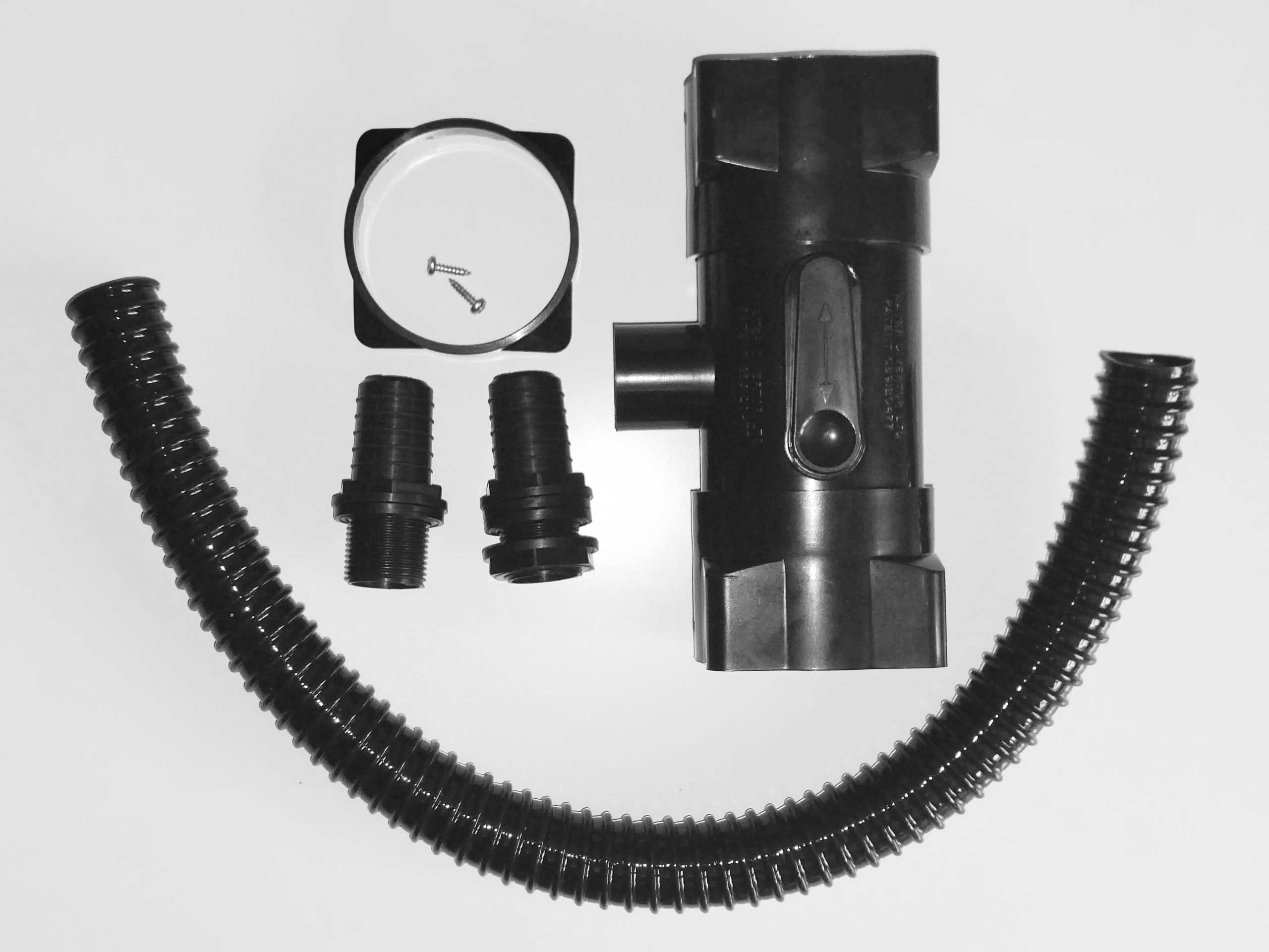

marshian Posted Thursday at 00:03 Posted Thursday at 00:03 Back in 2006 I got utterly piddled off with std DIY shop rainwater diverters (we had a few water butts dotted round various gutter downpipes for general garden watering) Reasons why….. 1. they blocked up really fast with moss or leaf debris 2. any decent rainfall and they had limited capacity to harvest all the rainwater coming down the gutter 3. In decent rainfall they tended to soak the walls 4. Slugs loved them and made good homes in them 5. Had to remove them in winter and replace with straight pipe to stop the butts being filled and then the water freezing. I searched the internet and found what I thought would be better. UK made, switchable so a harvest position and a divert to drain position. Decent depth before the overflow was reached (maximising volume harvested in a good rain shower. below is what I found only I bought the version made in white 19 years of use and exposure to UV has meant they are past their best (Brttle and leaky) but worst news of all was the company that used to manufacture them had gone under and they were out of stock everywhere so the search was on for replacements who knew it could be so difficult…….. Seems all the usual places just stocked the std ones with all their issues Then Google took me to Australia and I found what I’m looking for I bought 3 and tonight I fitted the first one can be removed easily without stripping downpipe has recirc back to soakaway if butt is full has leaf/moss filter/ switchable for winter Claims 600 ltrs per hour with garden hose but 1200 litres per hour with 32mm pipe (so I’ve fitted 32 mm pipe version) being Oz spec 75mm diameter downpipe fittings i had to create so adsptors to suit the UK 68mm but not exactly tricky 3

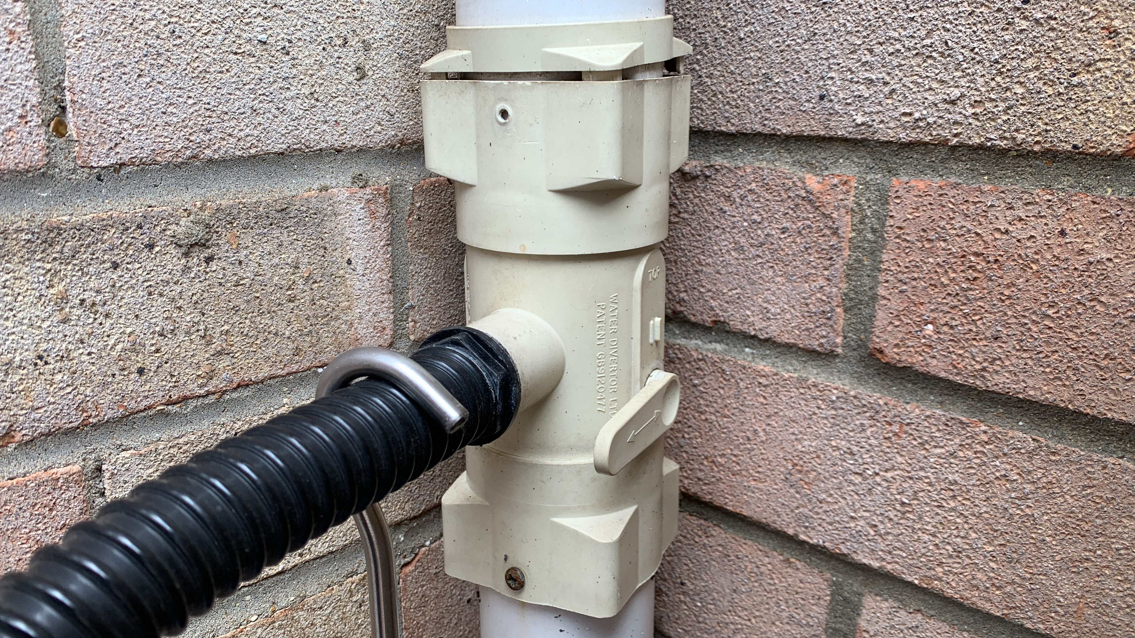

marshian Posted Thursday at 09:53 Author Posted Thursday at 09:53 1 hour ago, sgt_woulds said: Can you provide a link to a website? I need similar... I can but I can make it easier than my journey (to get them from Australia and wait for them) as now I have one I googled the part number and they come up in Amazon EU) so I’ll link to that when I’m on a PC meantime heres a better picture of the old ones I used to use - next one to replace lever horizontal shuts the flap and it harvests - lever vertical is winter setting (nothing goes to the water butt)

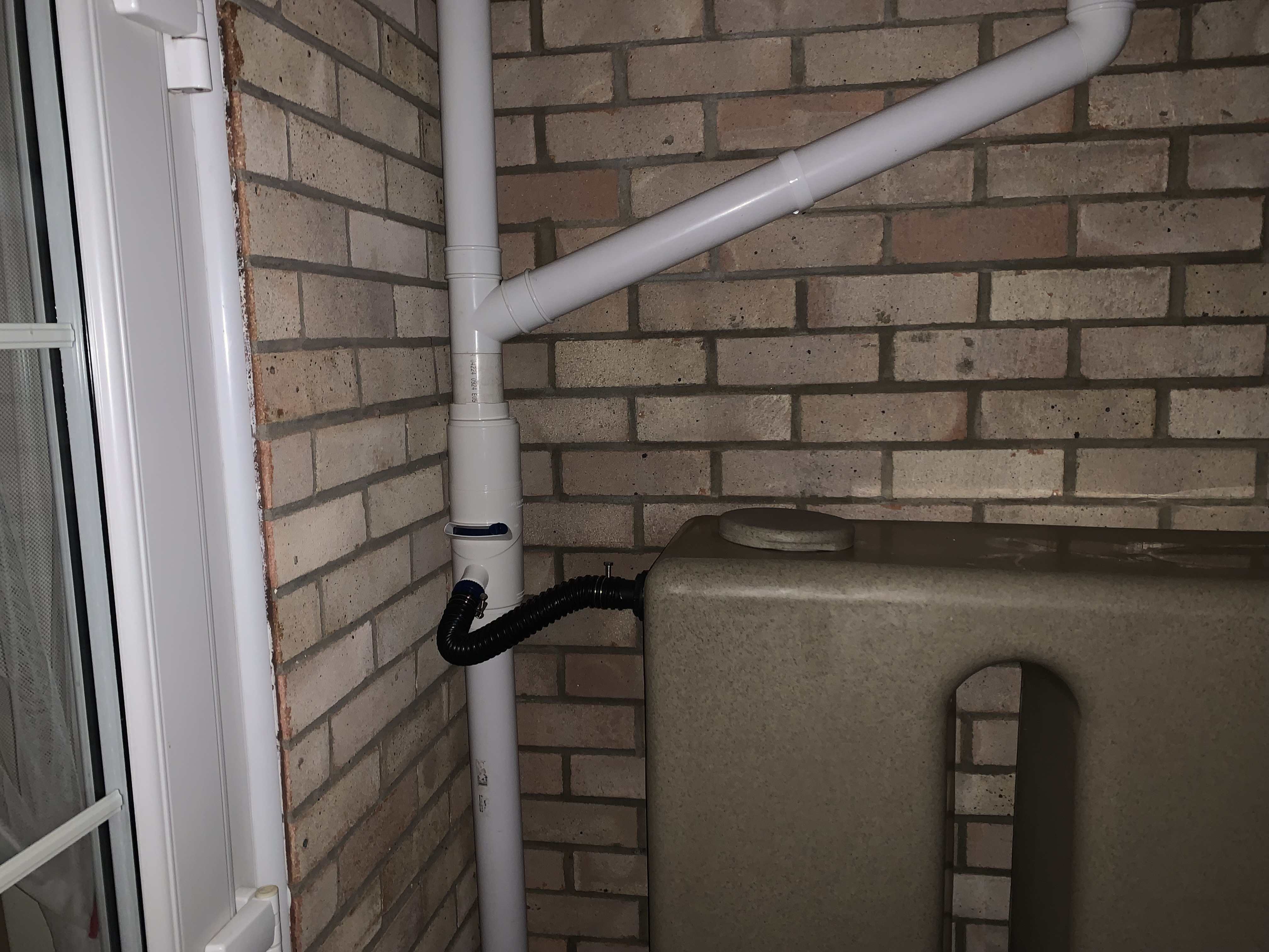

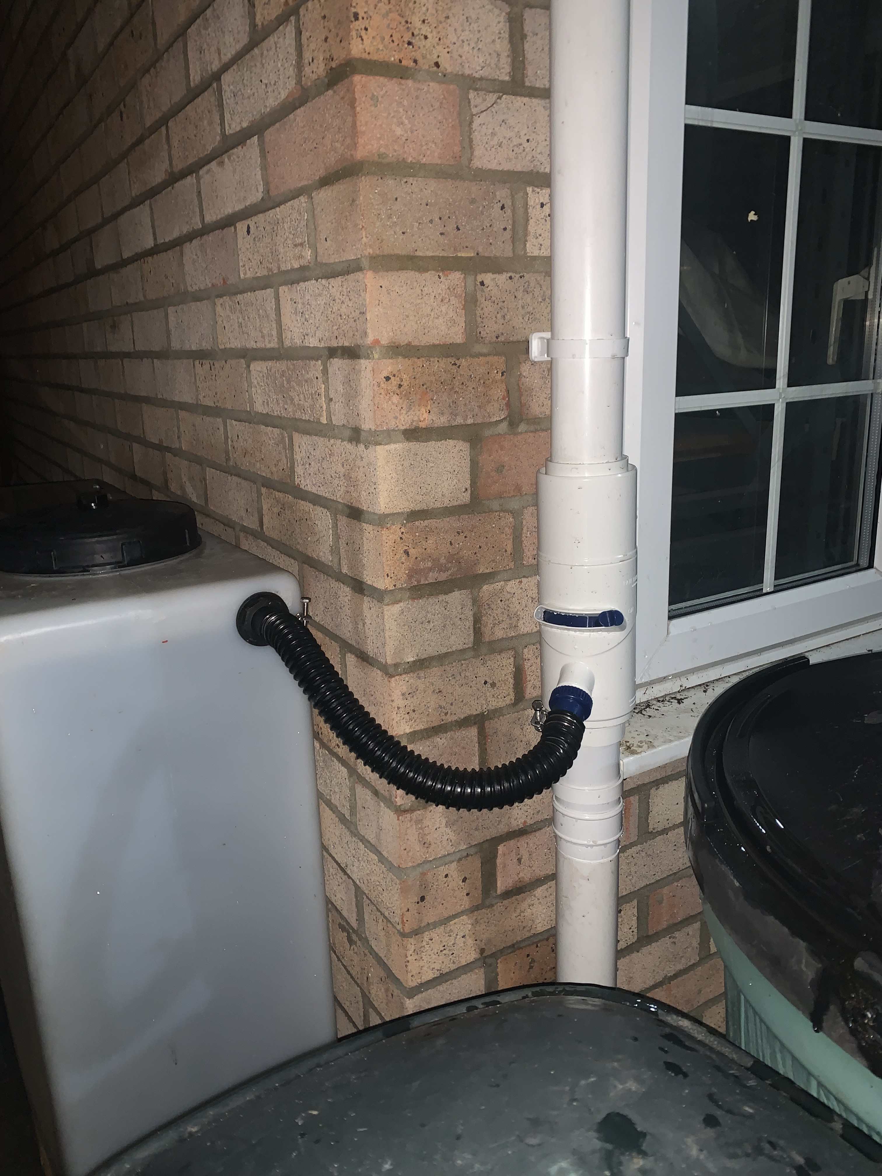

marshian Posted Thursday at 19:42 Author Posted Thursday at 19:42 Second one fitted - lessons learnt from the first one helped. It’s snug in the corner and I couldn’t add another down pipe support but it’s OK as it is. There is a quick way to remove and check for blockages and a hard way Easy way - slide up the upper body and the lower section will lift up and out. I’ll try the method on the one I fitted last night which was a struggle to do it the hard way - slide up the upper section, twist and remove then the lower section.

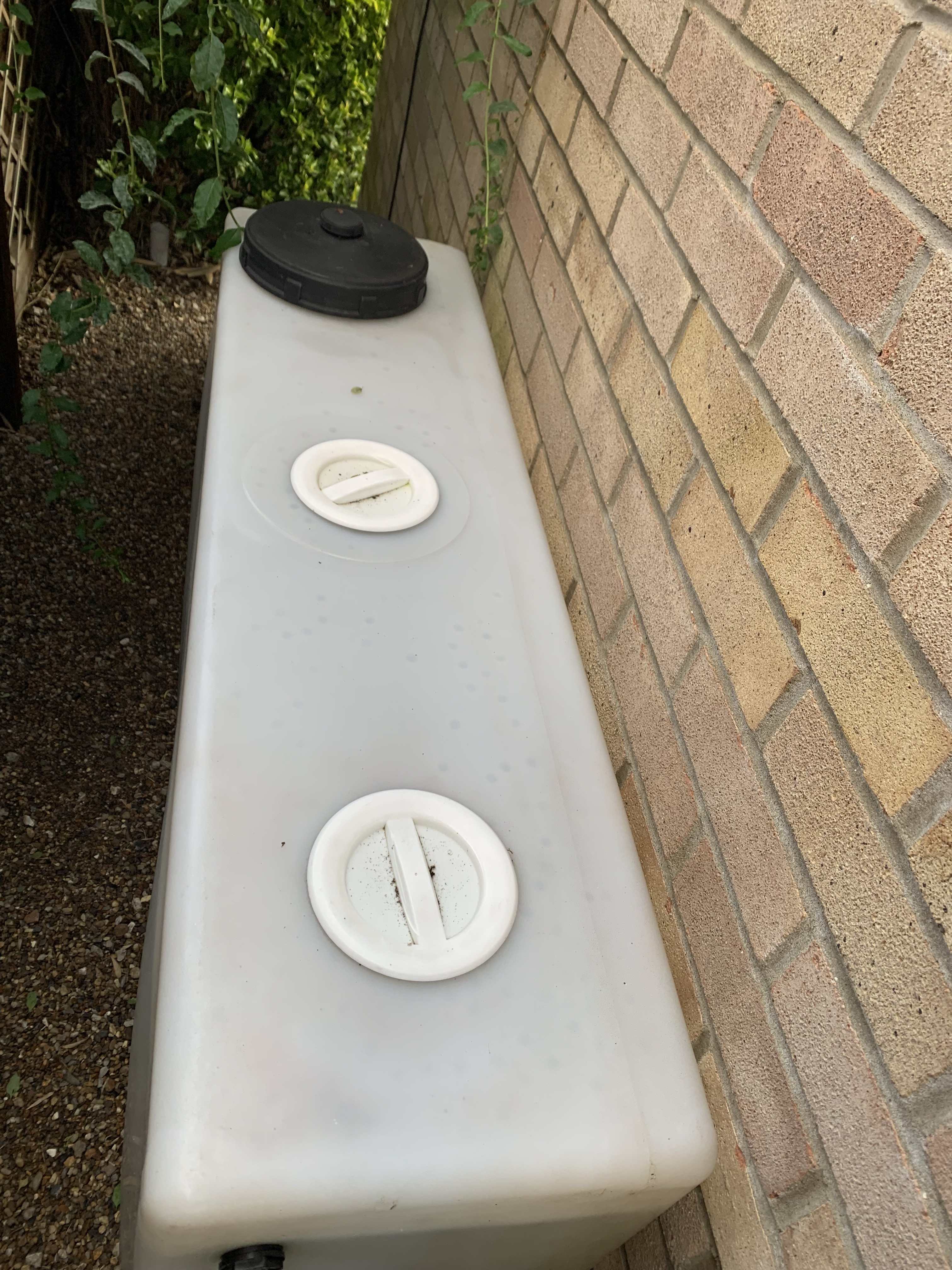

marshian Posted yesterday at 18:47 Author Posted yesterday at 18:47 Top tip for large water butts that have multiple strengthening webs Add buoyancy inspection hatches from yacht chandlery store makes cleaning once a year with a jet wash so much easier Obviously not required for non opaque containers 😉
marshian Posted yesterday at 18:48 Author Posted yesterday at 18:48 Yes the alignment of the hatches make my teeth itch……
