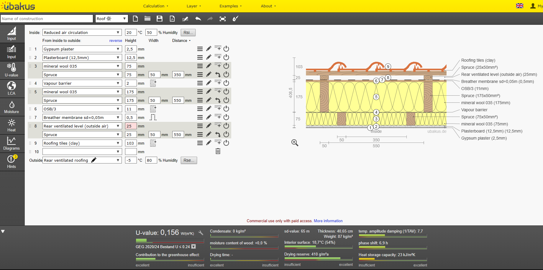

Full fill, use 75mm insulated service cavity with mineral wool.

Defo should have an additional layer of PIR going over the rafters to the room interior, to stop the quite adverse repeat cold bridging; (25mm to 40mm thickness for this layer, depending on how much head height you can sacrifice?).
If you must use PIR put it outside the roof and diligently tape the OSB as an airtight layer.
Far better to have all timbers inside the insulation for long term durability. etc. This is also a very easy way to make a room in roof airtight if you return a membrane to the inner wall surface through a double sandwiched wall plate.

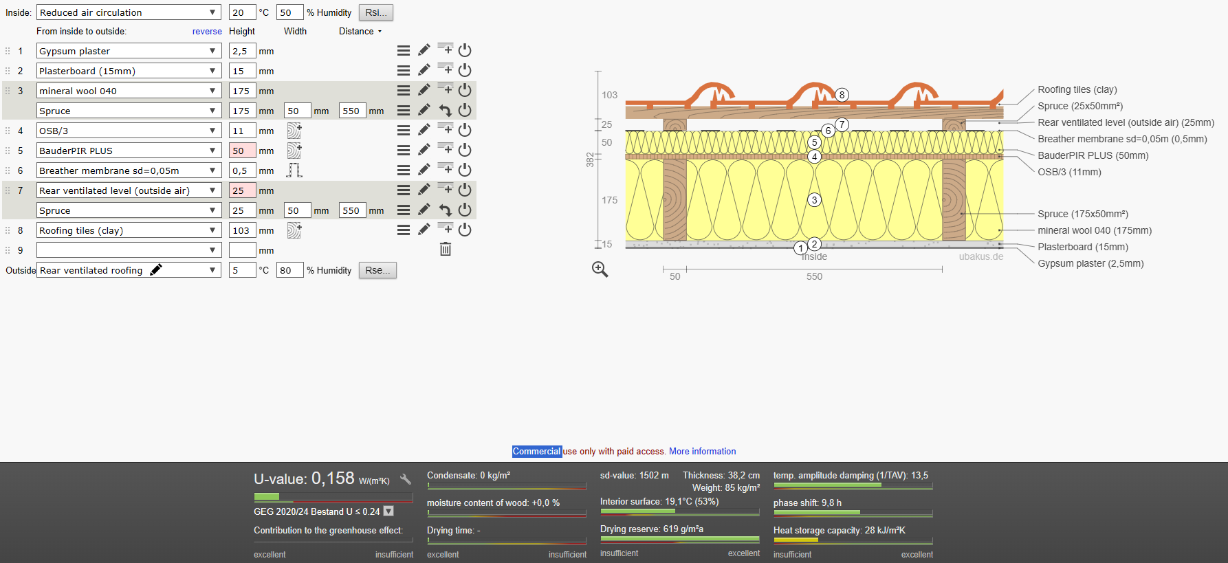

Nope, 75m service cavity to get below 0.16W/m2K. I would prefer 220mm and 50mm service cavity as it is nail gun friendly but as we're starting with 175mm rafters we're stuck.
