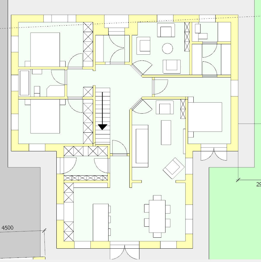

Kevan Marshall Posted Friday at 17:13 Author Posted Friday at 17:13 55 minutes ago, Iceverge said: Is it a prefab or can you adjust it to suit? It is going to be a SIP’s build so some walls we can alter as they shall be non load bearing!

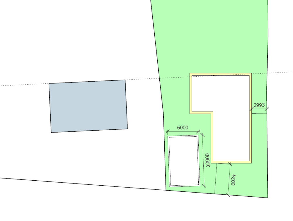

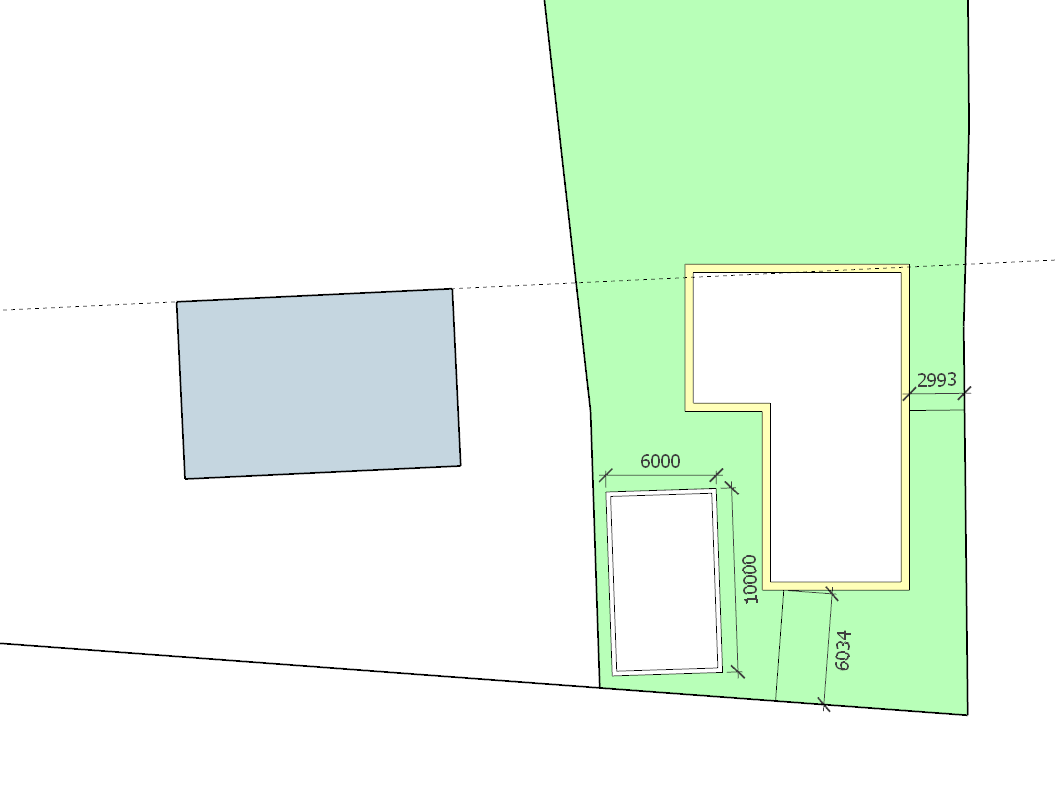

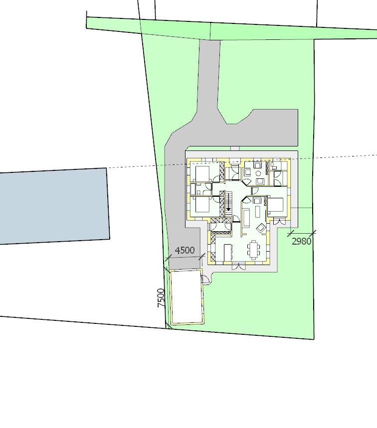

Iceverge Posted Friday at 17:39 Posted Friday at 17:39 Realistically I think you're not going to be successful in moving the house forwards to break the streetline or get any closer to your neighbours boundary. These principles are pretty well established. With this and the workshop constraints you've set the house will be either smaller than you want or darker inside than you'd like. Compromise will have to be made somewhere I fear. Personally I'd change my workshop requirements or shape but it's up to you.
Iceverge Posted Friday at 17:44 Posted Friday at 17:44 That's as close as i could shoehorn in a house that met the the requirements of your workshop but it leaves the south garden very small and the middle of the house would be quite dark inside.

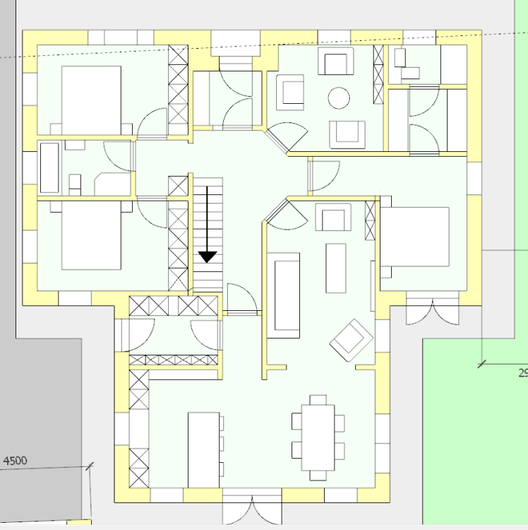

Iceverge Posted Friday at 18:13 Posted Friday at 18:13 There's a version with a smaller workshop. i made some minor layout changes too.
