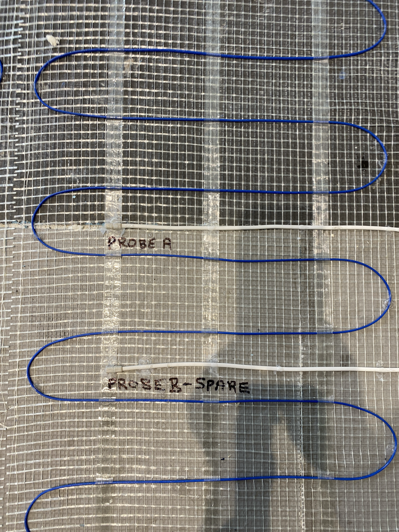

gambo Posted August 20, 2025 Author Posted August 20, 2025 On 17/08/2025 at 23:34, Nickfromwales said: If you want a brand, then Warmup for cable/mat and a very good controller. The 3ie and 4ie (iirc) are good, with learning algorithms to predict how long it takes to get the floor to the desired temp at the desired time, so if it takes an hour to get to the temp you want at 07:00, it'll learn to switch the floor on at 06:00 etc, same for turning off (again iirc). Speak to their technical guys to get more clarity. It's all quite confusing if someone doesn't have experience. I was hoping to just run the cable, tile and think about the rest later on. However, I've just realised no thermostat means not temperature probe. Given what I've read I may run two probes but need to get it asap. Can I use any ufh temperature probe with Ditra heat cable? e.g. I can get JG sensor probe from screwfix, then I may go with Warmup thermostat if it's better than schluter.
Nickfromwales Posted August 20, 2025 Posted August 20, 2025 2 minutes ago, gambo said: It's all quite confusing if someone doesn't have experience. I was hoping to just run the cable, tile and think about the rest later on. However, I've just realised no thermostat means not temperature probe. Given what I've read I may run two probes but need to get it asap. Can I use any ufh temperature probe with Ditra heat cable? e.g. I can get JG sensor probe from screwfix, then I may go with Warmup thermostat if it's better than schluter. Yup. I always fit 2x thermo probes if I can't install the conduit to change them out at a later date. 3 minutes ago, gambo said: I may go with Warmup thermostat if it's better than schluter. I'm not able to advise as I've never used Schluter, so it may be better! Have you a link to the one you are considering, or at least just get the spec sheets alongside each other for comparison. The benchmark for a good unit is a bit of self-learning for setback.
