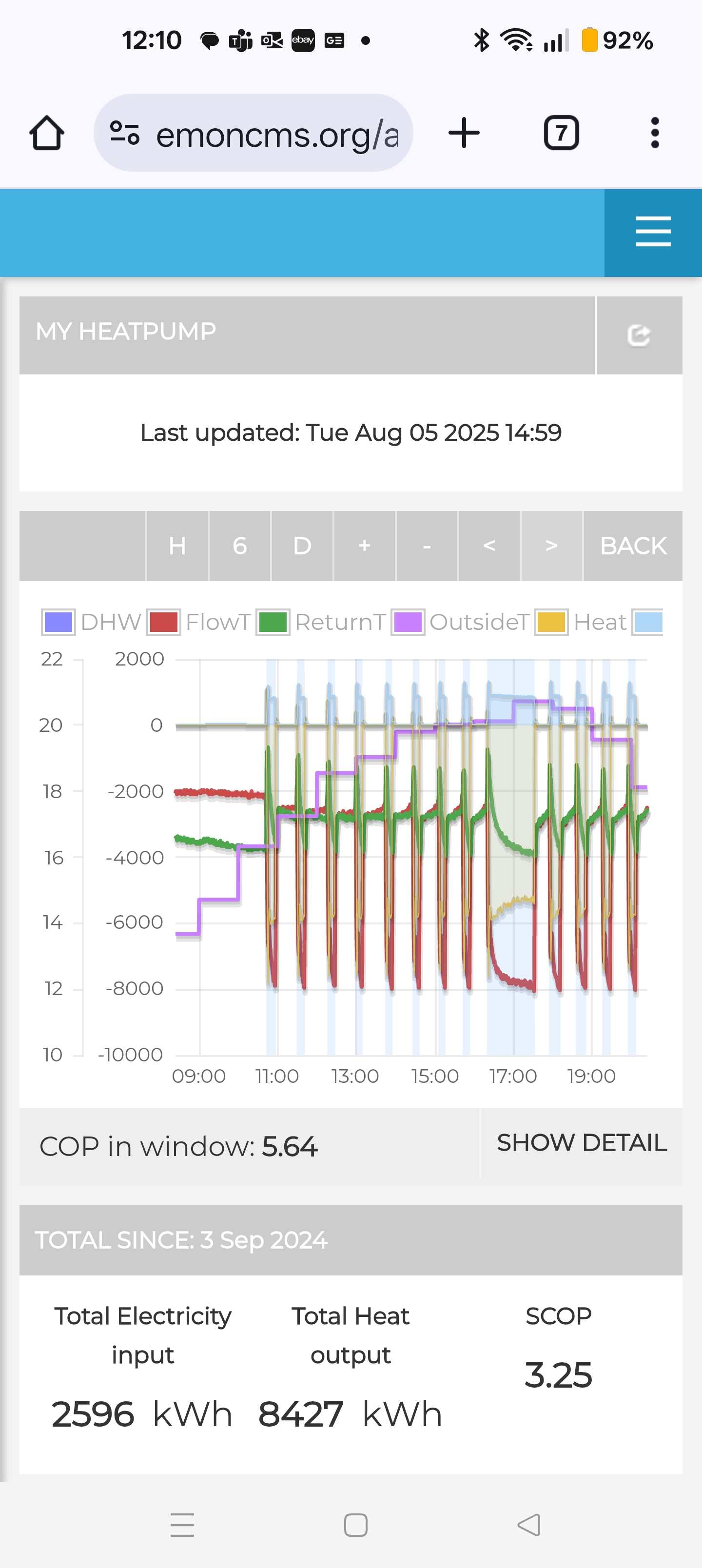

JohnMo Posted August 6, 2025 Posted August 6, 2025 37 minutes ago, Tom said: What do you mean by "long compressor cycles" - and how would I know? How many times the heat pump cycles on off when asked to do work. The better sized your heat pump to demand the less it will cycle, mine is double the size it needs to be so runs for 10 to 12mins every 30 mins to an hour.  So if you run 40 to 50 mins still to a temperature closer to 16.  This is mine running the other day, the light blow highlights are the actual heat pump compressor doing work, the gaps in-between are it resting between cycles.  Easy way is if the fan is running your compressor is running, if off it's not.  Just had a thought, if you have thermostats you will have to wind them up to max temperature to have a demand to heat, even though you are cooling. Also if you have volumiser or buffer, need to make sure they are only in the UFH circuit.
