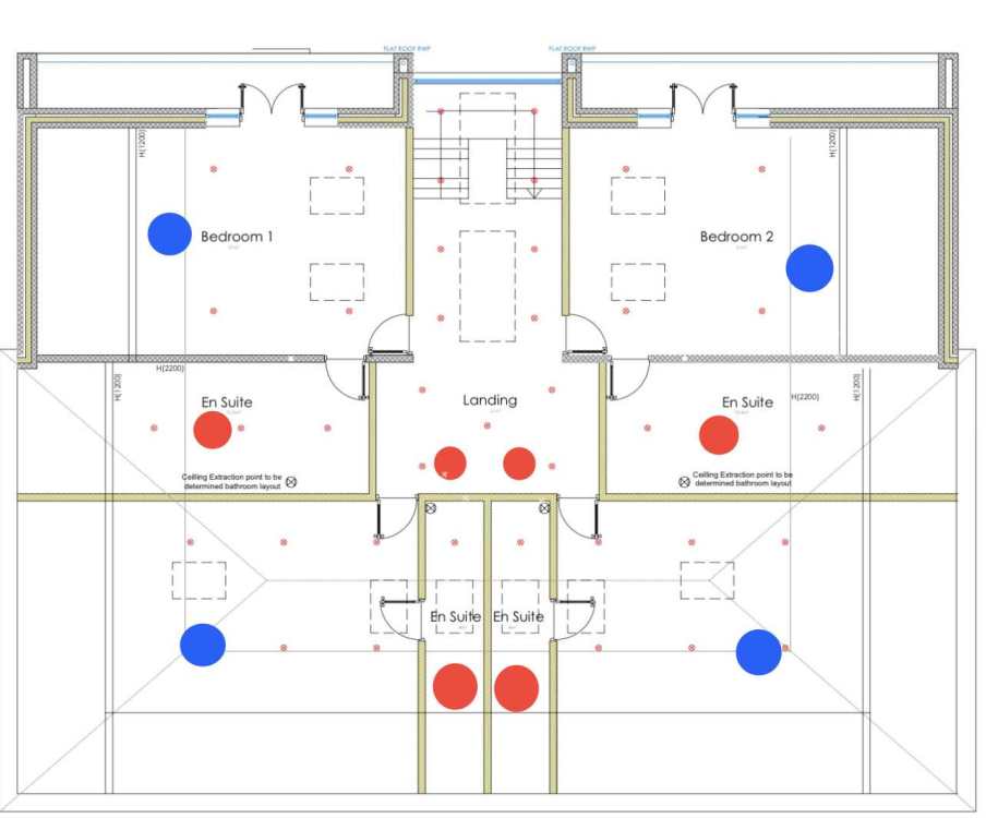

Hi all I have a dilemma which is playing on my mind and hope you can be of some help.
All bedroom doors to the landing in a home with an MVHR system often need a 10mm undercut gap at the bottom to allow for airflow between rooms. This is to ensure proper ventilation.
Every bedroom has an en-suite bathroom with a door with the 10mm gap with a return extraction pipe back to the Mvhr manifold, so was thinking that the main bedroom doors to the landing might not need the 10mm gap as the airflow path would be satisfactory between the bedrooms and its own bathroom.
That’s the first thing but the other thing is I am actually going to put extraction vents In the landing because of the heat that is generated in the whole house settles in this area, my thinking is it would be good to circulate that heat in the winter but also in the summer to get rid of the heat when the unit is in summer bypass mode.
So because I need this extra function with the landing extraction should I put the 10mm gap on the bedroom doors to the landing because the airflow path from the bedroom can now go 2 ways to the ensuite bathrooms and the landings.
Thanks in advance..

Is the airflow to bedrooms and ensuite the same - if not you need an under cut
Could be a waste of time. Why not just a big supply there instead. But then - No supply to bedrooms and obviously extract in the ensuites. It would need to sized to at least match all the ensuites and any bathroom upstairs. The bedrooms then get through flow on the way the extract points. You need door under cuts. It's a valid system and is called cascade ventilation.
The issue with the extract in the hall is where does it gets it's flow from. You either over ventilation the bedrooms or from down stairs?

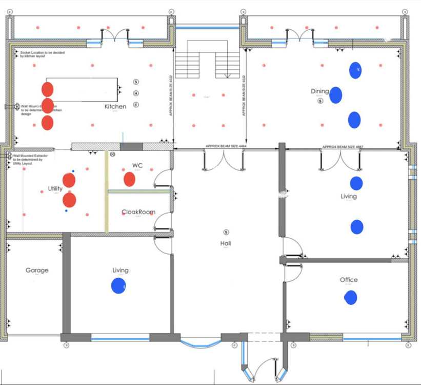

Hi thanks for the response, where the stairs are on the downstairs plan at the top of the plan the square box that surrounds is open to the upstairs and all the blue circles at the right hand side of the house is the supply valves so the cool air would be provided from that side.
Your trying way to hard
One supply or extract to each room is normally all that's needed. 3 in a dining room is not required.
2x extract in utility? Why
3 in kitchen? Why
MVHR does not move heat about, it's a ventilation system. The very max you can move is 10W per m² of floor area with a heater running at about 70 degs.
I would concentrate on looking at your heating system and look to move to a low temperature system.

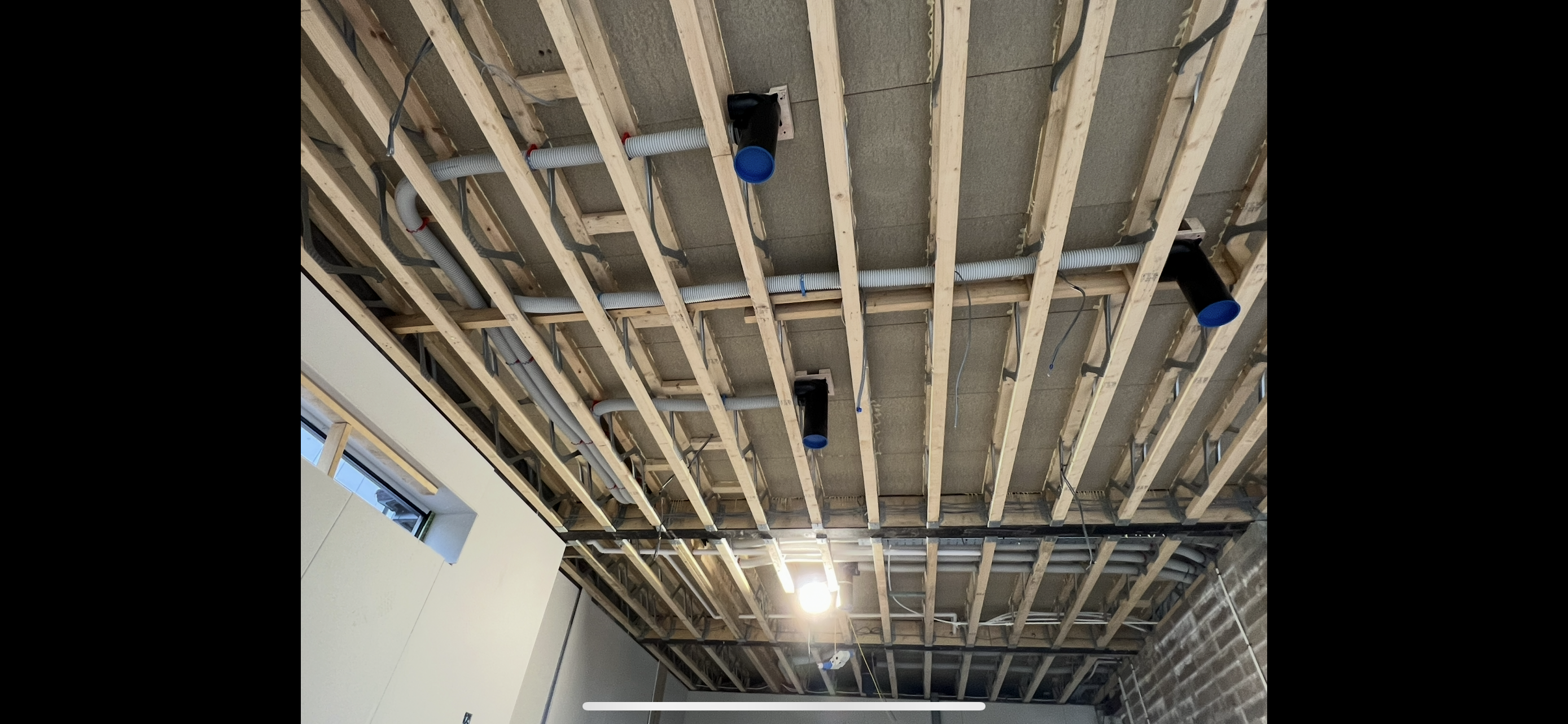

Thanks John, because of the run lengths from the attic to the Kitchen/utility and Dining room.
The lengths are 17m to 20m from the manifolds and the transmission of air is in 75mm flexible pipes/ducting.
There are many bends to get around the steelwork so I guess it would be easier to reduce the airflow rate on the plenum valves when setting up.

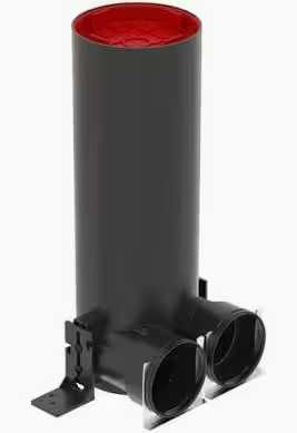

you generally put two hoses into the plenum of one inlet/outlet if the duct run is long
The lengths are 17m to 20m from the manifolds and the transmission of air is in 75mm flexible pipe s/ducting.
Use a double or triple duct plenum, then you can run as many ducts as you need to one terminal.
Thanks I have some plenums around the house with 2 pipes like the ones shown above from BPC.
In the dining room I had plenums some left over so I used 3 plenums with 1 pipe going to each of them just to use them.

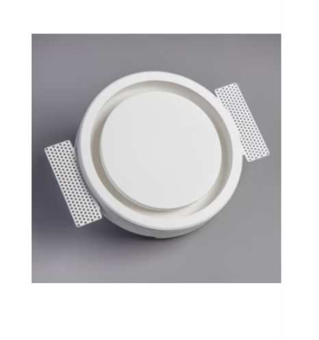

@Fadec, the 3x plenums in the dining is OTT, but if you are at peace with 3 crying warts then technically it’s the better solution as when on boost this will give the lowest level of audibility by far.
Why not go for a linear plaster-in unit with all 3 ducts going to it? Me personally, I’m not a fan of how utilitarian these basic air valves look, in a domestic setting, but that may bother me more than it bothers you. Que sera.

Hi Nick thanks for the reply, In all the bedrooms upstairs there is 1 fresh supply plenum in each of the rooms with 2 x 75mm pipes I read that if you positive pressure with more air than what would be extracted so the ensuites for every bedroom have 1 extract plenum with 1 x 75mm pipe and that they are nearer to the extract manifold. Plus as mentioned earlier we could put the 10mm gap under the bedrooms doors to the landing for that alternative path.

I have ordered the plastered in version for those 3 as aesthetically it will look better, picture below.
There’s no ‘could’ you need to do the undercuts if you want the system to function properly.
The airflow is dictated by the rates set during commissioning, and they won’t be set up so the input to the bedrooms are equal to the extracts in the respective en-suites.
The idea would be for airflow to make its way to / from spaces via the path of least resistance, so it can function as per design.
