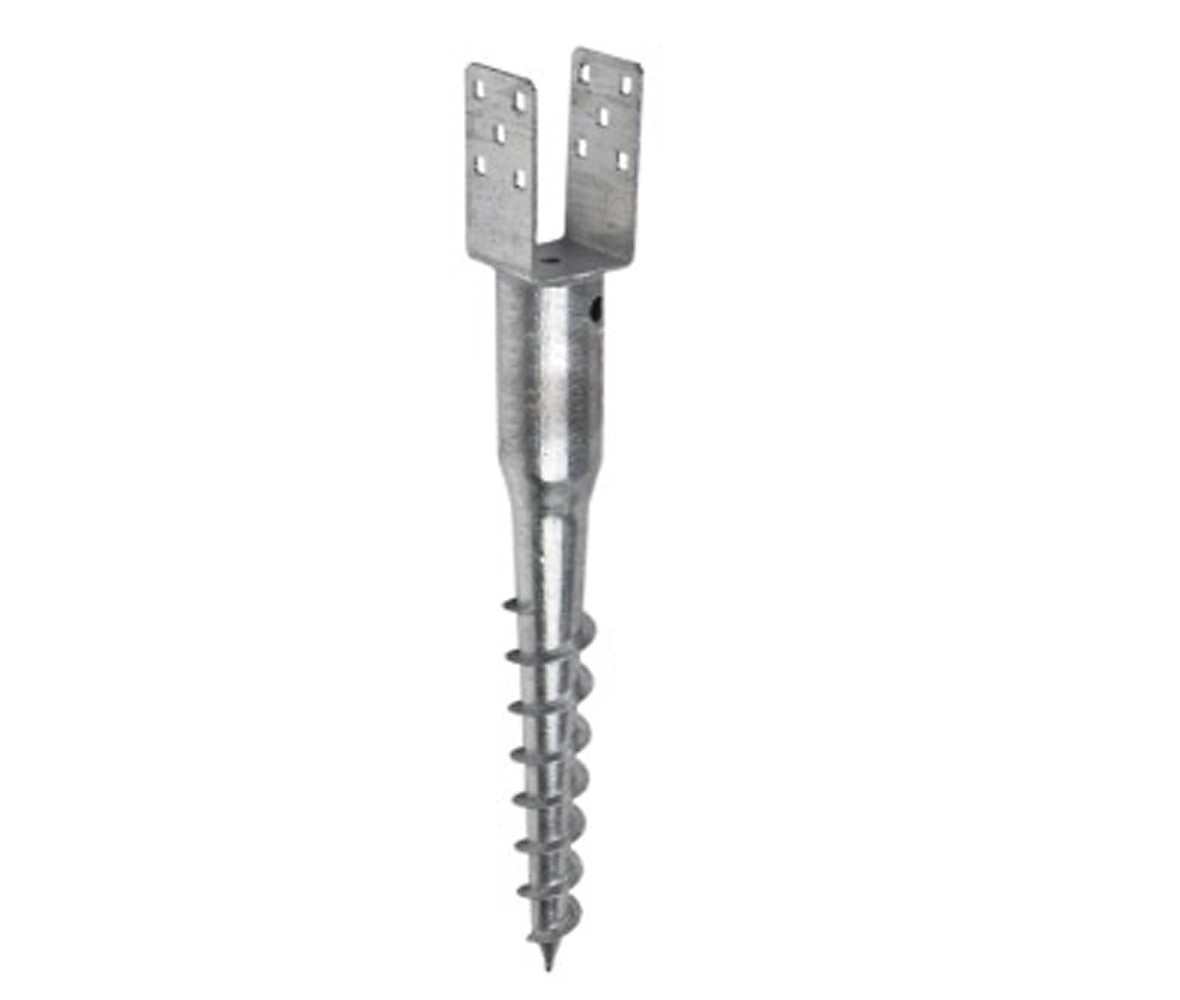

saveasteading Posted July 30, 2025 Posted July 30, 2025 Oddly this is a building where these little screw piles might be appropriate. Ie as no regs. As wrongly assumed earlier. Screw in piles, then timbers spanning them, then joists. There would be a void underneath. For clarity i only mean these, not big time proper piling. At b&q for patios I expect. Prob best get longer stronger ones than these.
