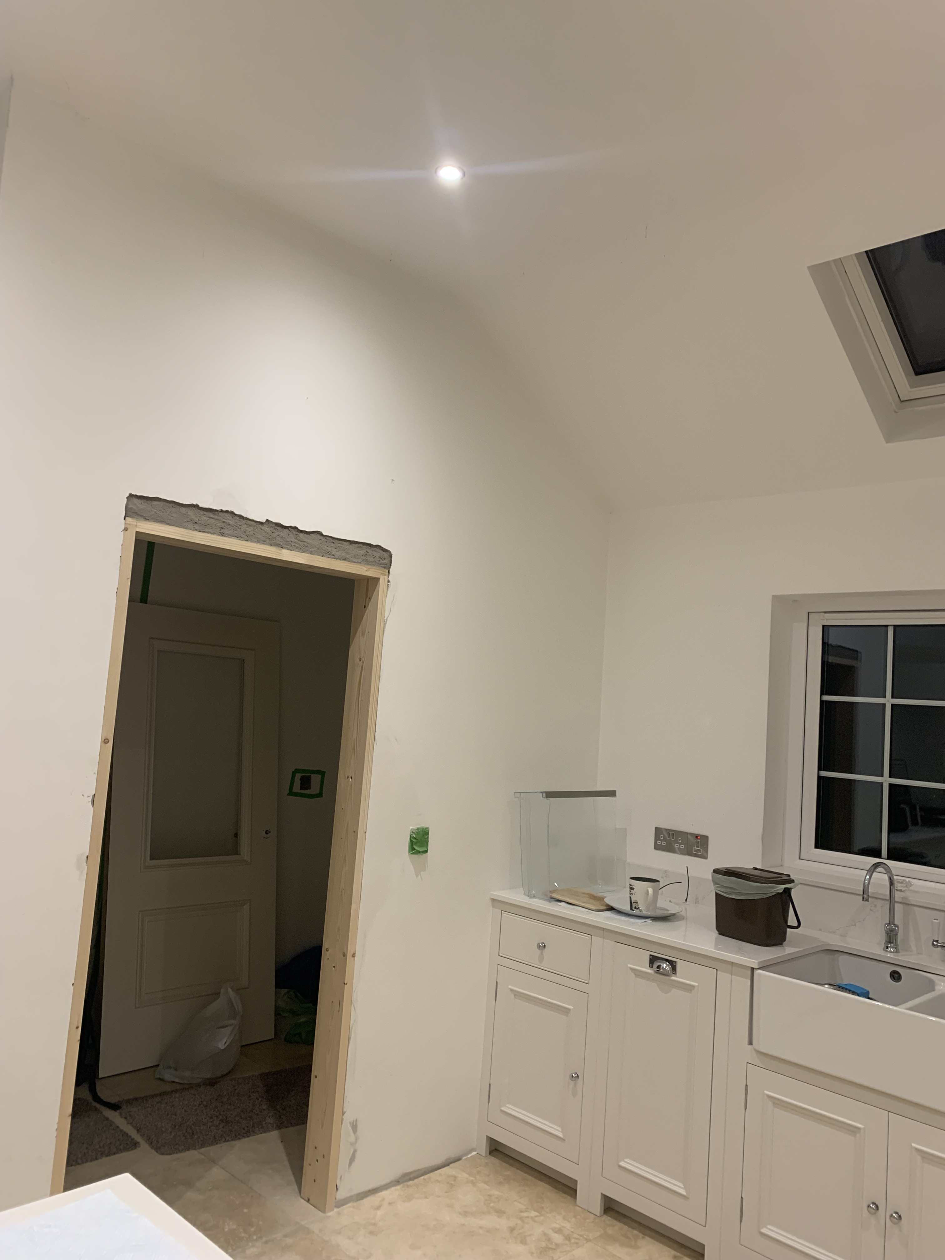

Miriam Posted July 23, 2025 Posted July 23, 2025 Hi there I'm having a structural issue at the moment with a doorway in my new extension; From the image attached you can see that i had a large gap above the door frame. The gap was filled in with a concrete slab bonded to the bottom of the lintel . However I dont think this is structurally sound as im assuming that there is extra weight on the lintel which may be causing an uneven distribution of weight bearing of the wall above. I suspect that the gap may just have needed to be covered by timber and plaster board. I'd appreciate any advice so I can correct now, what could potentially cause structural damage over time. Many Thanks in advance Triona
Mr Punter Posted July 23, 2025 Posted July 23, 2025 I can't see an issue here at all. Once the plaster is made good and the architrave on it will be fine.

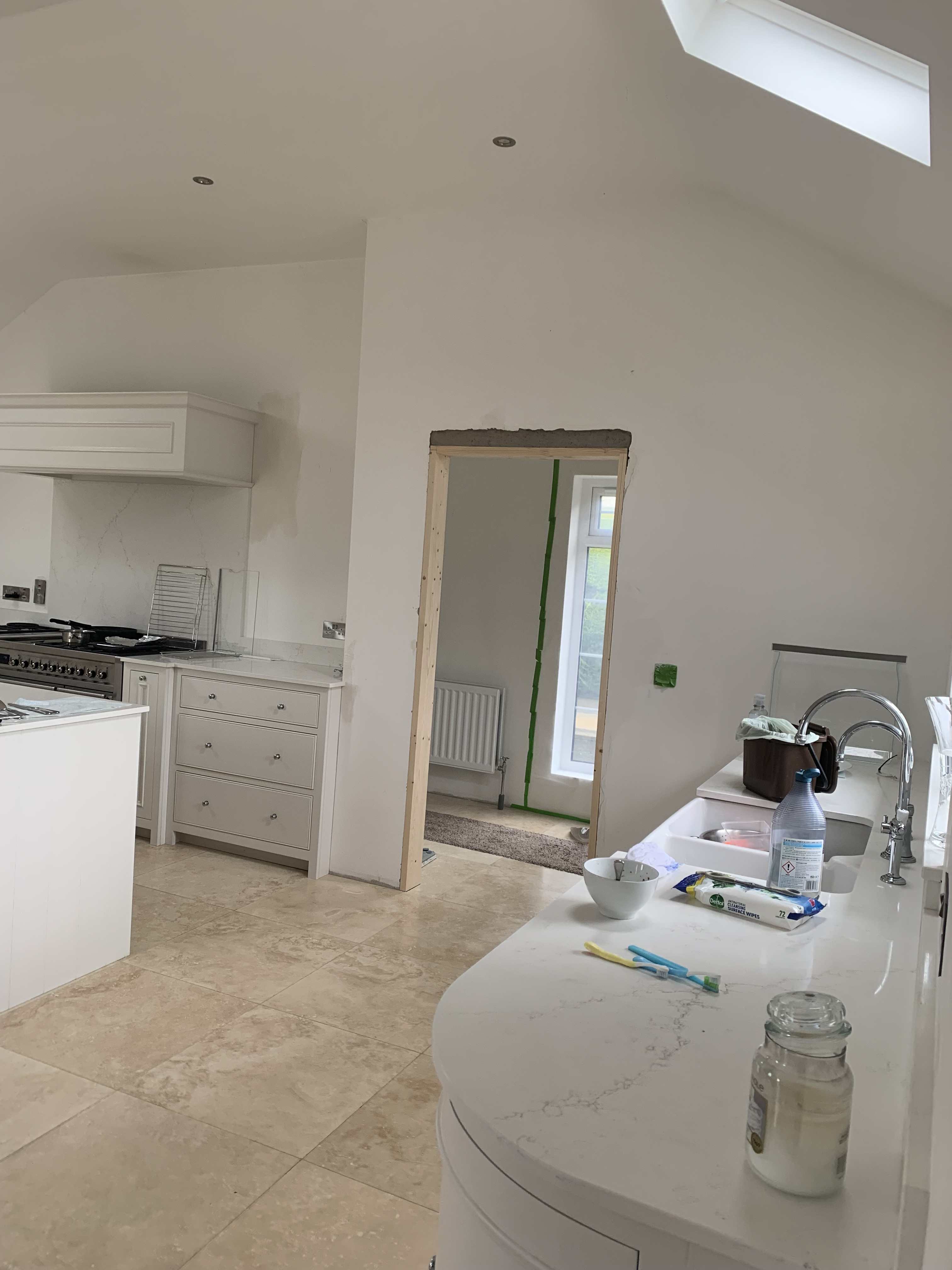

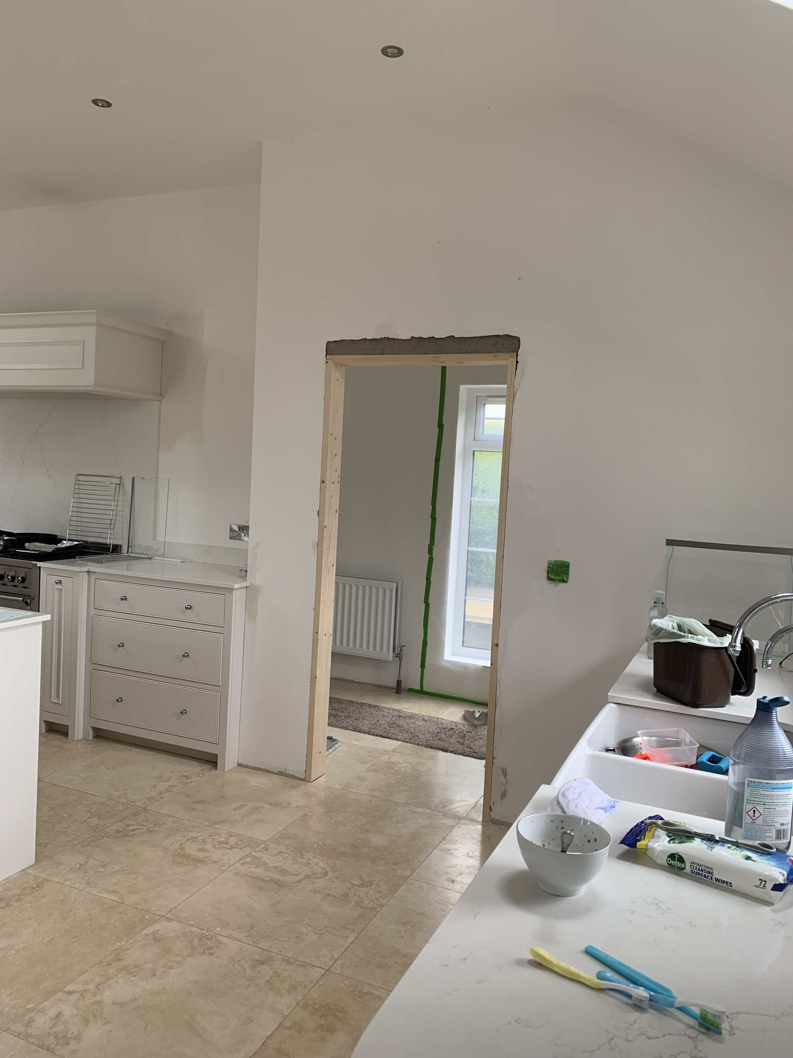

Miriam Posted July 23, 2025 Author Posted July 23, 2025 Hi heres a better perspective of the surrounding wall. Thanks
markc Posted July 23, 2025 Posted July 23, 2025 Looks like a lintel bearing on the frame, odd way to do it but overkill if anything.

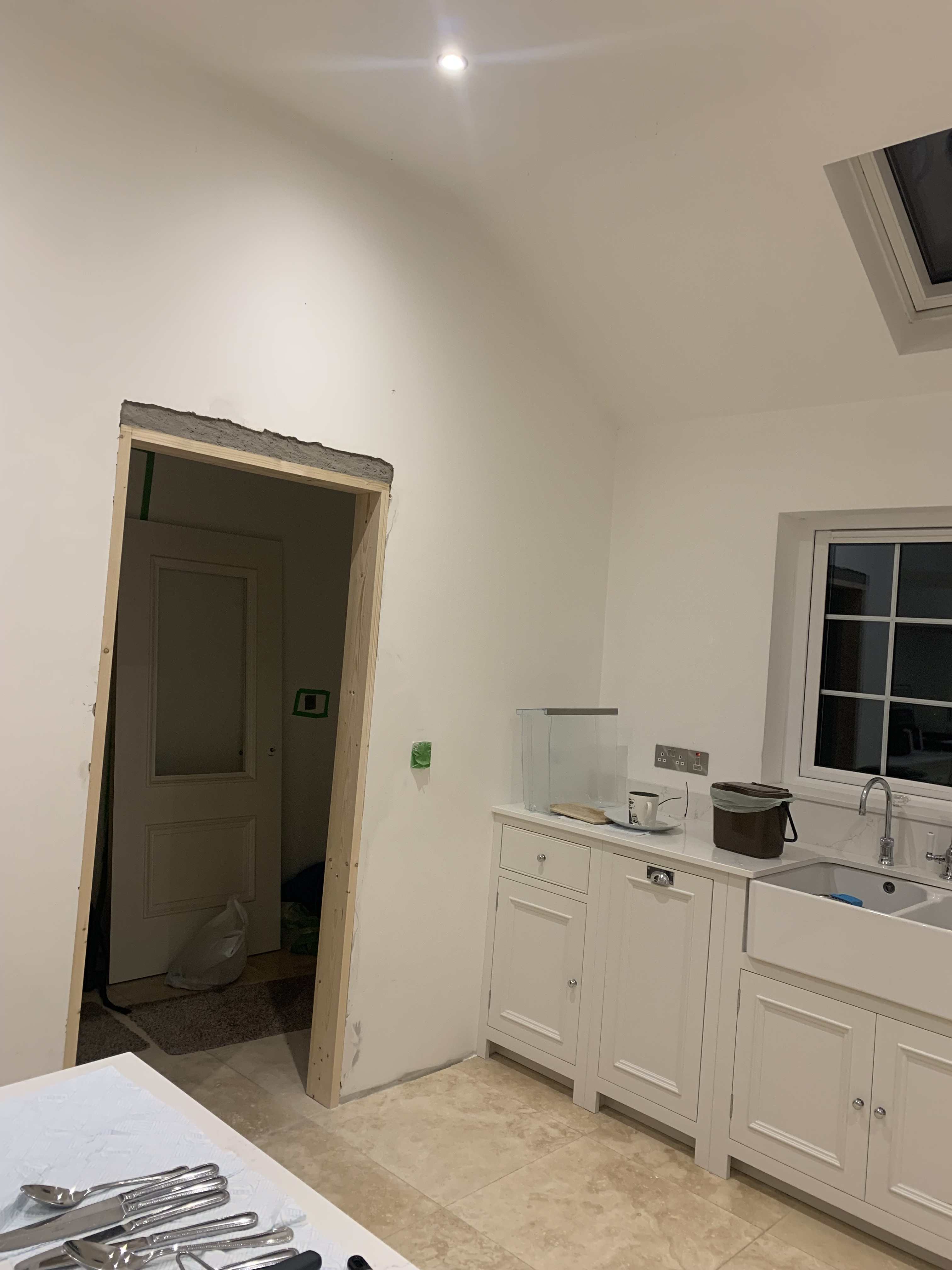

Miriam Posted July 23, 2025 Author Posted July 23, 2025 Hi Mr Punter Thank you for your reply. Just to confirm the piece of concrete that filled the spaceabove the door frame is not sitting on the wall on either side of the door frame the same as the lintel would be. It only extends the length of the door frame and is bonded to the lintel. Will this extra weight on the lintel affect the load bearing effectiveness of the lintel. My apologies for any confusion. Triona
Miriam Posted July 23, 2025 Author Posted July 23, 2025 Hi Markc Thanks for your reply Thats exactly what im concerned about. The peice of concrete slab was bonded to the bottom of the lintel, but only extends the length of the door frame itself. It doesnt sit on either side of the wall like the lintel above. Im wondering if I should undo this and board and plaster board instead because of the load bearin on the lintel above and the door frame itself. Thank you
